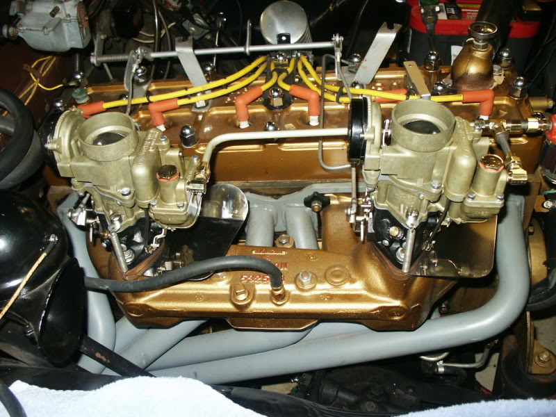

52 hudson with 7x motor
Discussion in 'The Hokey Ass Message Board' started by nunattax, May 3, 2012.
  1. nunattax
    Joined: Jan 10, 2011
    Posts: 3,322
    nunattax
    My friend has just purchased one.is this a rarity

    Thats the Twin H motor.

    The true 7X factory to dealer option had the same specs except the engine block was machined around the valves to create a relief to produce the venturi effect. The port area was hand finished by the factory race team. The valves were bigger, the inlet was 2" and the exhaust were 1 11/16" the head options were a reworked 232 head in either iron 8.7-to-1 or aluminum 9.2-to-1. This engine was only offered with Twin H and delivered 210 hp. The pistons were a special knurled type and had a chrome compression and oil ring. The head bolts were 1/2" studs with special thick washers to hold the head gaskets. The exhaust was a tuned dual outlet manifold. Info is from a very good hudson forum. I typed it in there but it didnt work. I could have explained it the same way but it would be in a more california slang. I work on alot of 7X engines for Bill Albright. I even turned some blocks into 7X engines, Oh yeah and i have a 7X engine in my chopped 49 coupe.
    Here's where some of the confusion about the 7X engine comes into play. The factory 7X engine was a racing engine and was designed to run fast on the track the use of the 232 head gave it a higher compression and both the head and the block were hand finished to produce the most horse power. The cam offered in 53 was the 311040 which was designated "super 7X" this was not a street engine unless you liked a rough idle but if you liked to race this was the engine for you, it was produced as part of what might be called a factory skunk works to support the Hudson racing efforts, which were by no means a formal effort. You can tell a factory 7X as the engine number will be prefaced with a State so for example the California dealers used CALXXXXX to designate the engine serial number. These engines were hot and they liked to eat timing chains but as evidenced by the track record they performed nicely on the track. Most engines were pulled down after 500 miles and new timing chains installed. This is the true 7X, the factory hand finished, dealer installed bear of an engine.
    Most of the 7X engines you see out there are a little different, mostly to produce a street driveable powertrain. I guess a purest might say its not a true 7X but its close enough to be really nice. This 7X was built by the industrious owner who got his hands on the 7X spec and had a talk to Jack Clifford who pioneered the aftermarket Hudson performance market. Jack spent a lot of time working out the rough spots and produced parts that could give you a lot of the horsepower of the 7X without the rough idle or tuning problems. He realised most owners wanted more horsepower but also wanted to drive there cars daily. He produced a variety of cams and parts that could help you build anything from a mild street 7X to a screaming race track 7X.

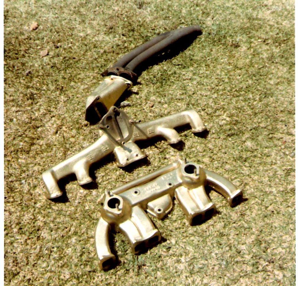

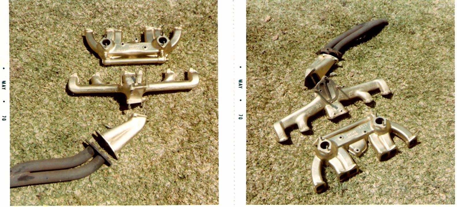

  10. The VAST MAJORITY of Hudson Hornets advertised as having factory 7X race motors don't have any idea what they are talking about. HudsonJoe gives a thorough description and I owned one of those dual outlet original exhaust manifolds decades ago.
    If you are thinking about buying a 7X Hudson, don't pay a dime extra unless you do the homework or see some documentation.
    Pics of my 7X exhaust manifold after application of some high heat paint back about 1972 or so.
