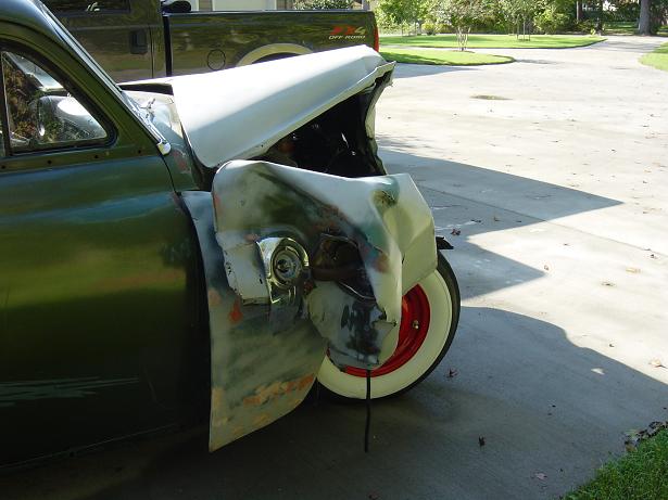

    Wrecked my 52 wayfarer this morning. Does anybody know what front clip parts will fite this body. I think 49 to 52 are pretty much same except grill. Not sure if coronet stuff will fit, Anybody know?

    yeah man im realy sorry about your ride. im pretty sure all the 49 -53 will fit. good luck on your rebuild.

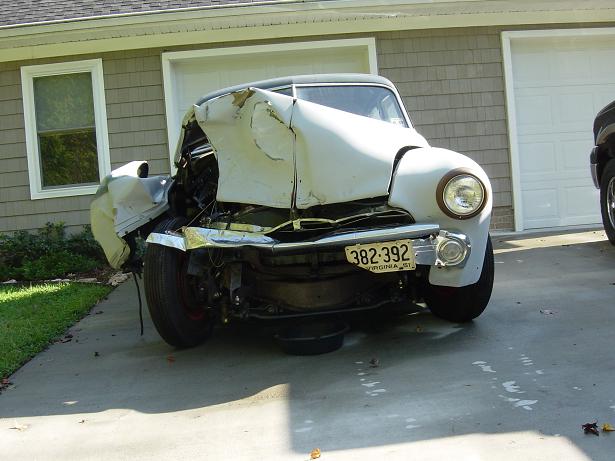

    I go to Boneshakers biker bar every sat. am to eat breakfast with some other old car guys. This am a 07 3500 gmc van pulled out in front of me. His fault, his ticket. Just got car on road 2 weks ago. New floors, everything new in front end including fatman dropped spindles and plydo disc kit. New painless 12 volt, langdon hei dist, all new brake and fuel lines, new stainless tank, new rear springs with 4" blocks. Car less than 51000 miles on it.
    Well what the hell u gonna do. If the frame isn' bent I'm gonna try to get enuf together to fix it.

    Always sorry to see a crunched Mopar! 'glad you're o.k., as well.
    Plymouth and Dodge share the same sheetmetal for '51 & '52.
    '49 and ' 50 arn't the same as '51 or'52. The chrome, grills and
    side stainless are different though.
    Looks like you may have some frame damage as well. Check
    motor and trans. mounts, as well and distributor shaft.

    It appears there is suspension damage . Need better pic of the l/f wheel. It appears to be pointing in a different direction than the r/f. R/f door hinge pillar may be out also. You'll need to look carefully at things with the front clip removed. The chassis probably has some damage due to the fact of the wheel positions. Looks like the wheel bore a substantial part of the impact on the r/f. Which could have affected the frame in the control arm mounting areas.
    Something will need a pull .
    Best of luck with the insurance company. Keep good notes and documentation ,you may need them.

    Insurance co. coming mon.or tue . The wheels are slewed out cause the tie rod is bowed down to the ground. Can,t start stripping down til ins. co. has a look. From what I can see the upper control arm may be bent back and the spindle upright may be same. Hard to tell right now. I think I do some have right door hinge problems, but door still opens easily. I,ll know in a couple days, but have go out of town for a few days. I'll take some pictures while I,m rebuilding.
