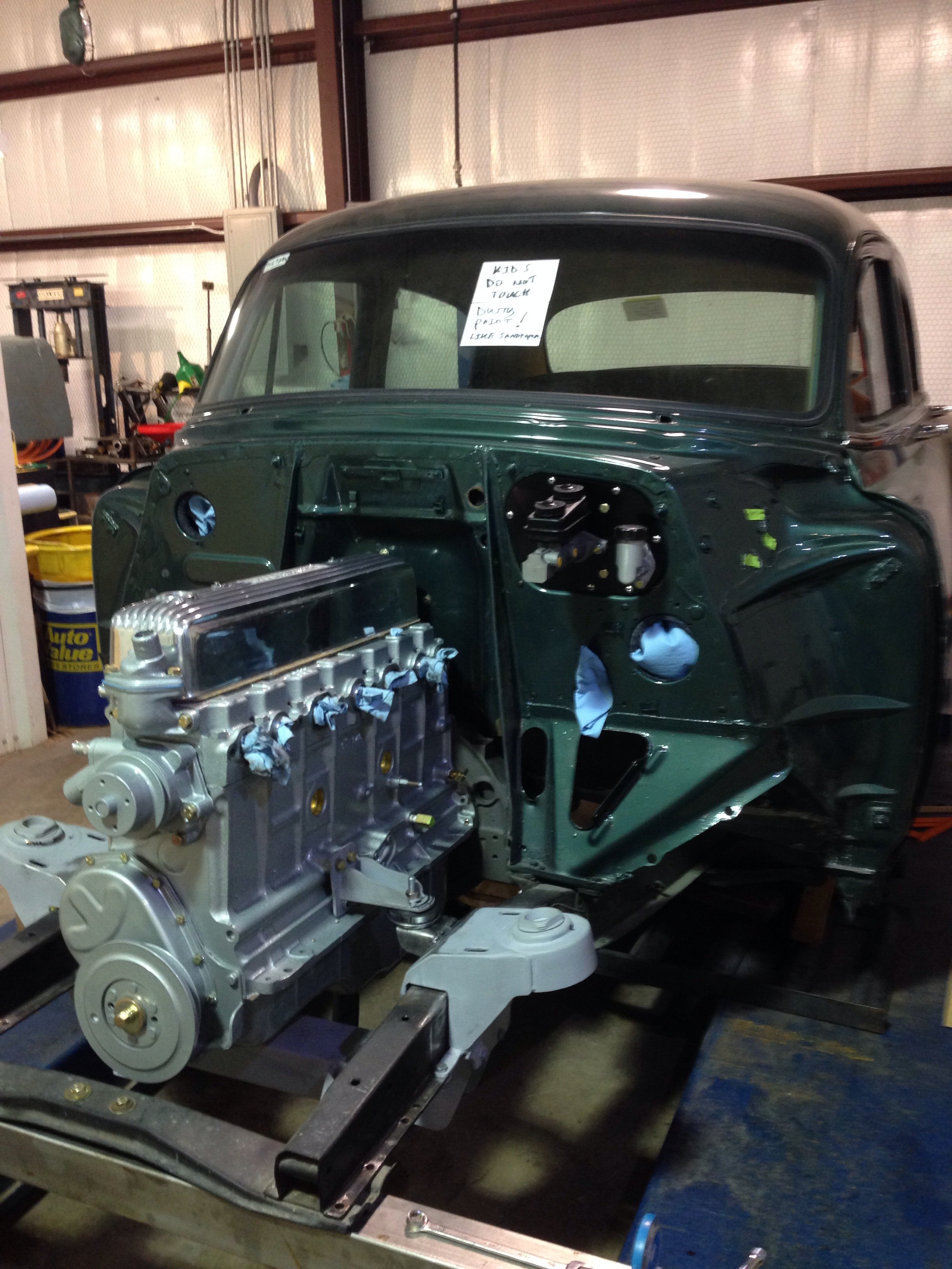

    image.jpg Getting ready to fab up mounts & trans crossmember. Man these 235's are HEAVY!

    image.jpg Wiggling her back into the resting place. Positioning for new mounts & crossmember.

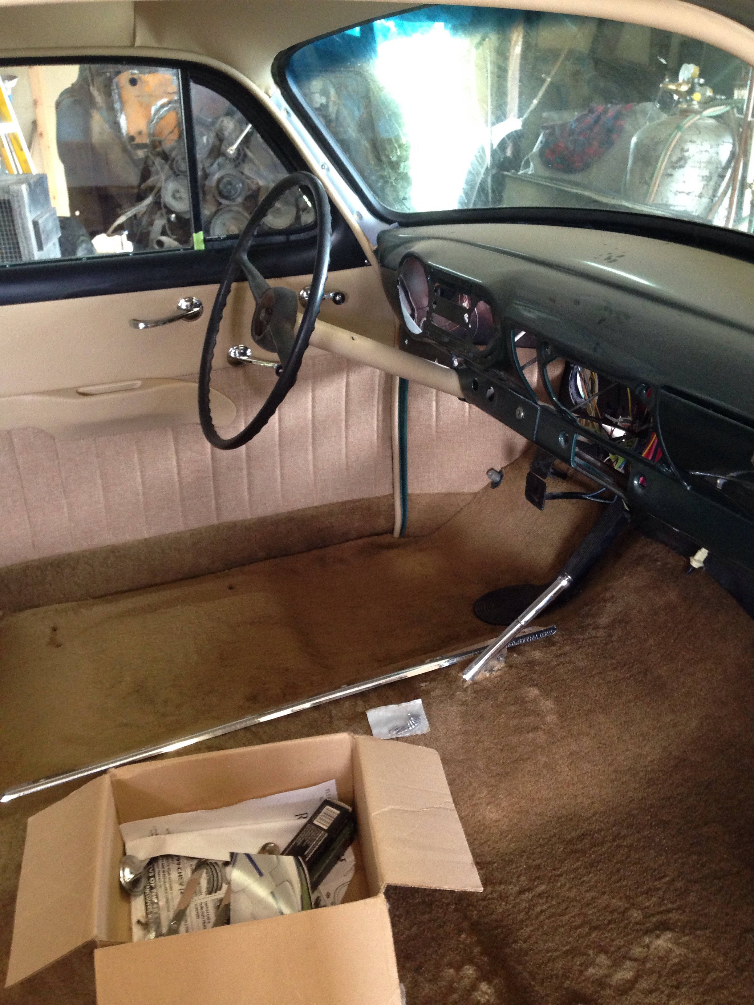

    Thanks , that's an idea I've pondered espec with the interior color being tan. I really appreciate the feedback ! image.jpg

    Absolutely, match it to the interior & trunk and it will look great and carry on the theme.

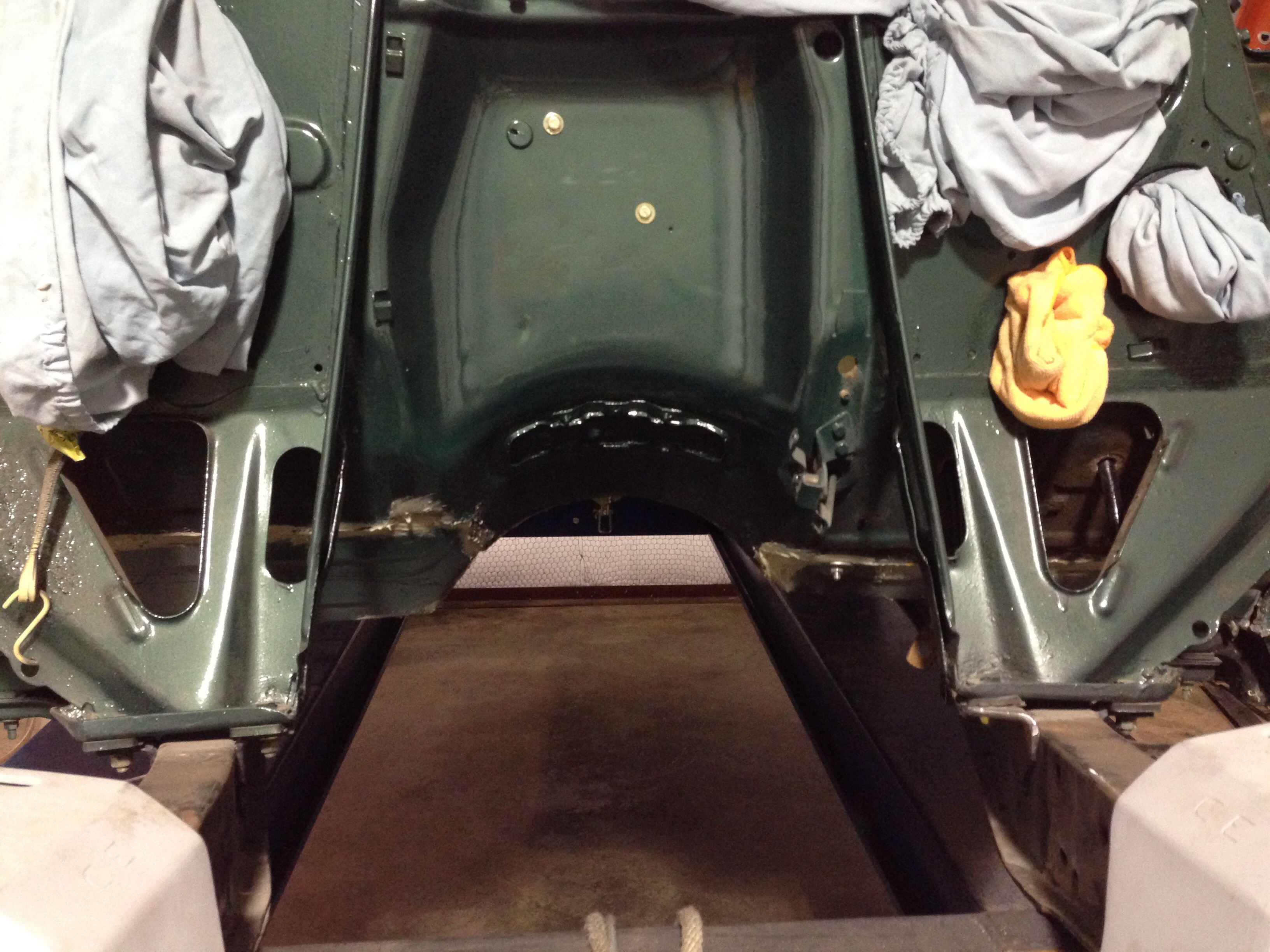

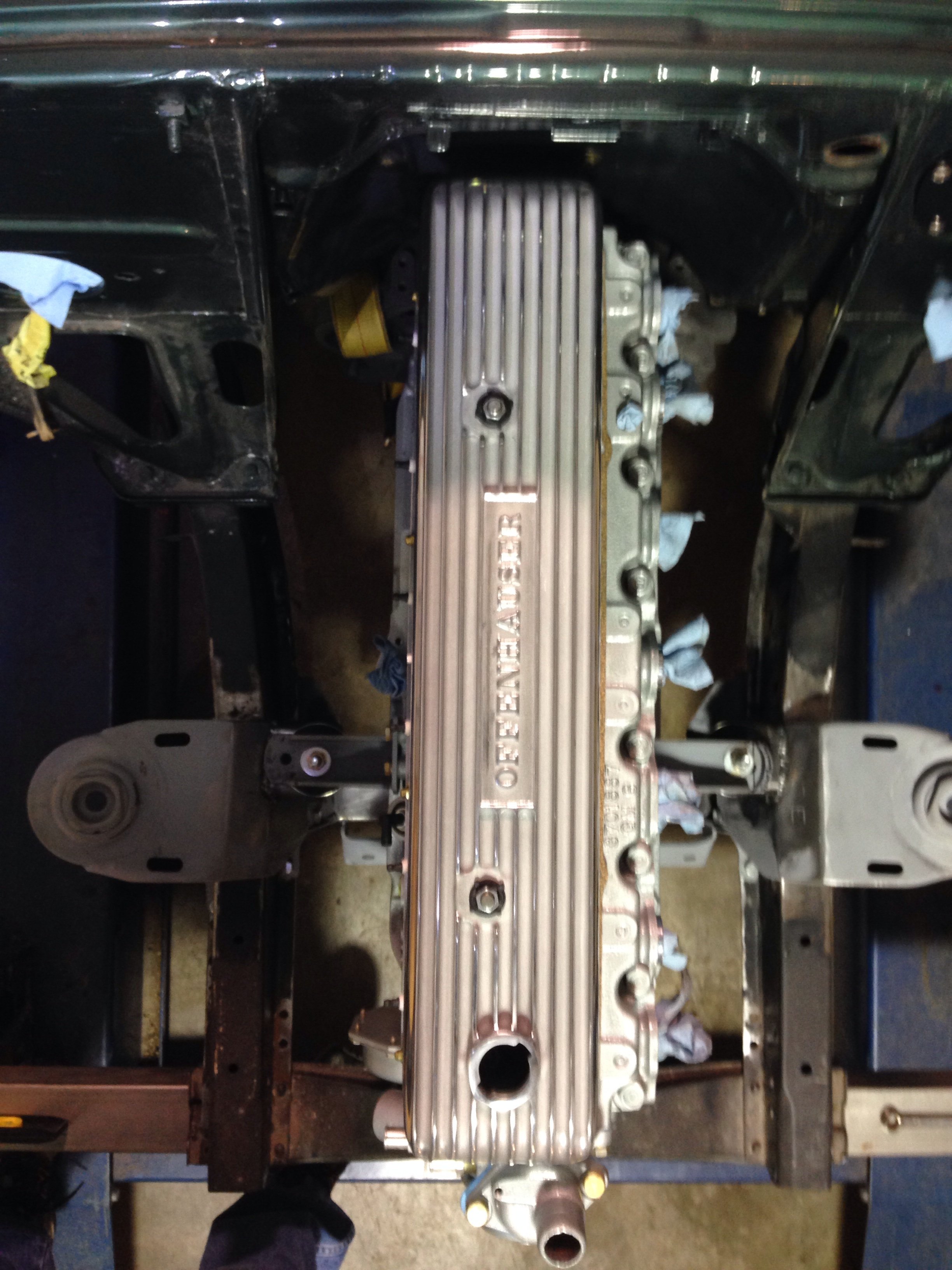

    image.jpg Finally got enough time to fab up engine mounts for mustang II. Still got some plasma t******* to do , I'm CE's Gunnie pig on how a 235 can fit their crossmember. All I can say is GREAT! image.jpg Made this simple but safe welded up jackstands to front radiator support center 2 bolts support & it's adjustable. Super squared up & all is bubble level & dead on centered up.

    image.jpg image.jpg Still in the "roughed in" stages but starting to feel I'm getting some things accomplished. Got some whittling to do on the block mounts.

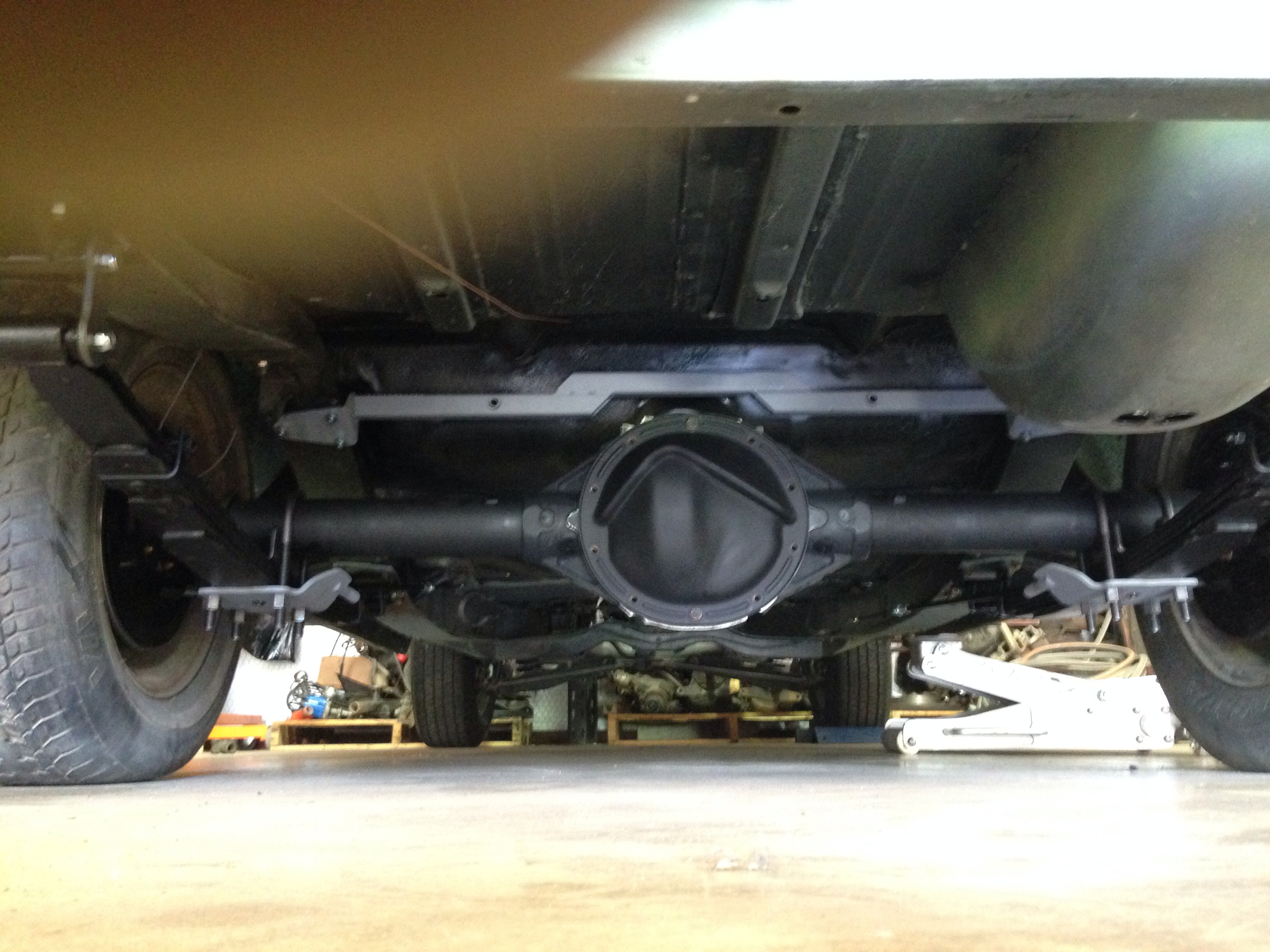

    Fun watch, really nice,, only I think you MIGHT have U-Bolt plates, (shock mounts,
    upside down and on wrong sides..

    Appreciate the eye on smalls! I've had them on the other way "test fitting" the shocks for centered travel & angles but they hung down way too low & the angles didn't seem right the other way at all. The shock compression & rebound sat better centered at ride height this way. The opposite flip extended the shocks out too far. Sincerely thanks soo much & keep an eye on me! I'm easy going & take good advice to heart ! Update , I just got to wondering what if & all other installs using CE kit are as car sits now , extra clearance with their design for those who want to ride lower. Their products are Awesome
