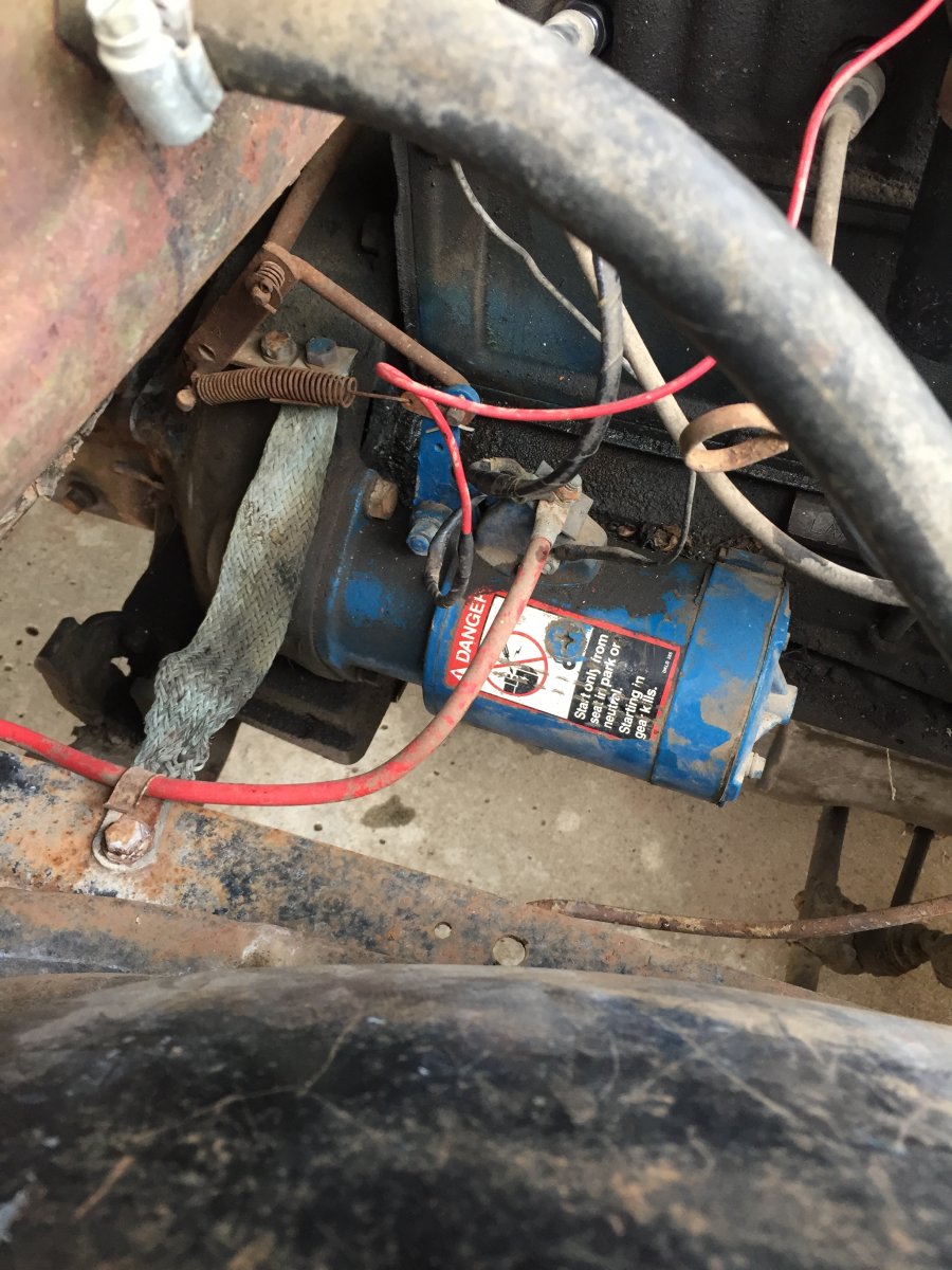

    I recently brought a 1953 Chevrolet 5 window back from the dead (was parked in an old Oklahoma barn for at least the last 25 years). I've put a bunch of work into the truck and the truck starts and runs great now...except after I drive it around town for 5-10 mins and park and shut it off, it will not start under its own power right away. It moans and groans & never gets going fast enough to kick over. If you wait a few hours it will fire right up. I know the old 6 volt system can be slow to start, but what would be the reason it starts so good on the first start of the day, then struggles to start after it's driven around a few minutes? I have new battery cables and new 6v battery. The starter has been replaced sometime in the past (see pic). The engine is a 1954 model 235 that was implanted into the 1953 pickup by previous owner. Any suggestions are much appreciated.

    Also, I see you are running a direct coil contact sir from your starter switch presumably to your coil. This is normally done to byp*** a ballast resistor. Get rid of the resistor on a 6V system and make sure your coil resistance is 1.5 Ohms or less. I ran a 0.6 ohm coil with a pertronix on 6V and that made a world of difference with hot starts on a high compression 270 inline six.

  9. I see a bunch of stuff going on in your first two pictures. First like it's already been said, clean the contact points for the ground cable from the engine to the frame, from the battery to the frame, and put fatter battery cable on it. But you really need to make sure all the connections are clean, I can't stress that enough. I run a 6 volt Optima battery in my 6 volt car and that made a world of difference.

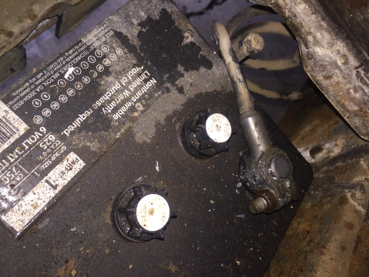

    IMG_5431.JPG IMG_5432.JPG Thanks for all of the input. I plan on checking and cleaning all contact points this morning and upgrading battery cables to the 2-00. Here's a pic of what cables are on the truck right now. I'm not expert, but they look like 12v cables. Thanks again for all the help!

    Looks like a well "Seasoned" battery. It appears you put a used battery in it.

    And your starter looks su****ious. The blue paint & 12v switch would make me want to tear it apart to see what else I could find.

    I swapped out the ground cable with the new 2-00 and cleaned up some contact points and it's firing much better than it did. My winter project is to go through the wiring and redo most of it and clean it up. I'll plan on a new 6v battery soon as well. I also think the blue starter looks out of place so I'll probably replace it sometime in the near future. Thanks for all the suggestions!

    Hell that battery is 10 yrs old according to the date code.
    I'd bet it hasn't been tested.
    Time for a new one.

  23. You'll notice the clip on the frame that the positive cable goes through- now look at Motion Guru's. That clip is filled with cable. Make yours look like his, to go along with the new ground strap. The positive cable you need isn't that long thankfully, since the battery is under the floor right behind the starter. As stated, a battery from the current decade will help too. I've gone through these same things on my '51 (gmc) and really like the optima batteries. Several of those skinny optima 6 volt batteries used in my cars.

    Not trying to beat up on you, trying to help you. In those pics can see problems. Yeah so maybe it's not a concours restoration, but notice all the crud and skunge on the battery top? This will tend to draw a battery down. Keep battery clean. Windex works good for this, it helps neutralize the acid. It also looks like there's no hold down, and battery is more or less loose in the tray. Battery shouldn't be able to move or bounce, they can get plate damage this way.
