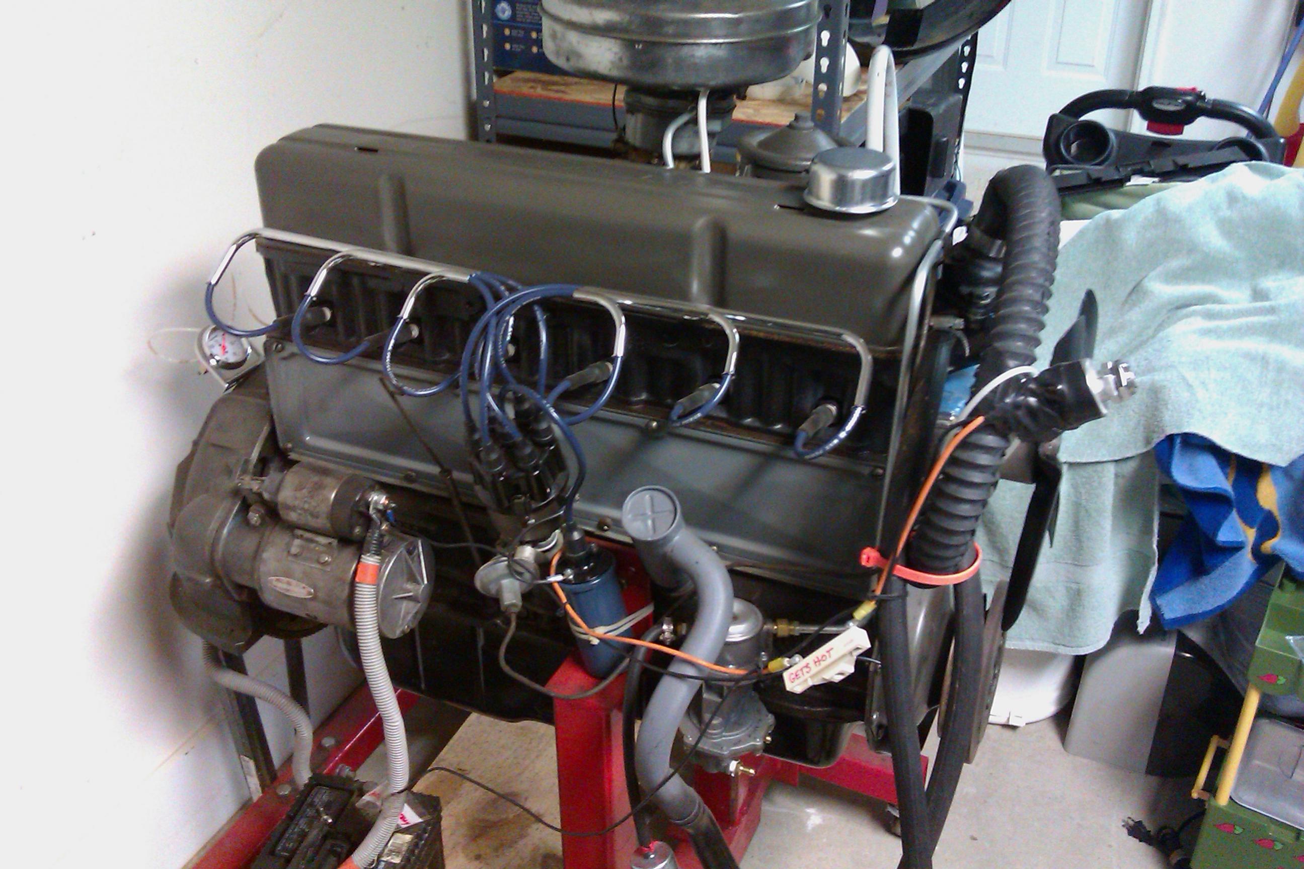

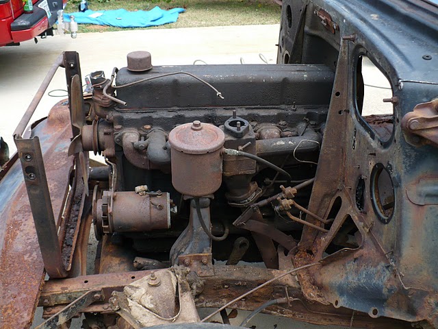

    I am rebuilding a '53 Bel Air 2 door post..the motor is out of a '54 Bel Air. Basically, I'm making 1 car out of 2 basket cases. I've rebuilt the motor--which was in incredible shape...took apart the suspensions from both cars...and now working on the frame.
    I'm going all original. My question is....(and hopefully not too dumb)....would someone please explain the hubs made into the drums? How do you replace the drums or the hubs separately--or can you? Can you cut the hub rivets out of the drums and replace them?
    Either way...here's some pics from the build!
