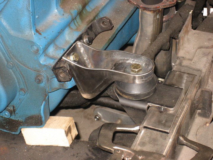

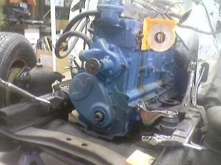

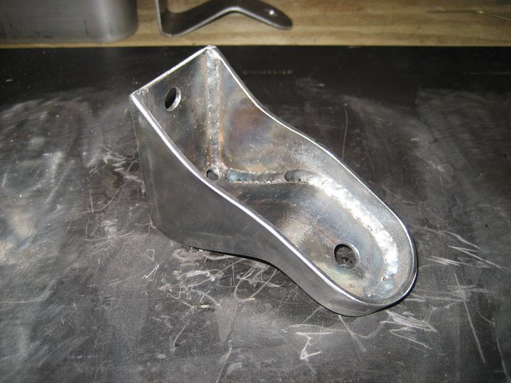

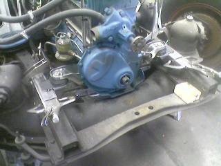

  4. Sorry about the*****py old cell-phone pictures. These are the front mounts I built for my ‘54. The engine is s 1956 261.
    deathrowdave, Hnstray and scotty t like this.

    Very nice job on the mounts! Did you also have to do something different in the trans mount? I understand the cars that used the front mounts also had a bell housing that had mounts on it to keep the motor stable?
