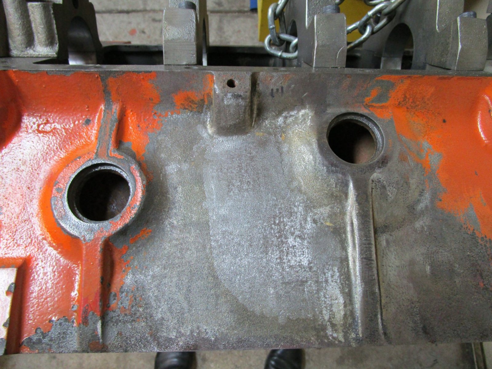

    Well, I made a dumb mistake and yanked the head off my '53 Buick's 263 straight 8 before doing a cooling system pressure test. A quick glance made me think I had a seeping head gasket, but it's looking like I have an external crack in the water jacket adjacent to the lifter valley. It's obviously been leaking for a while, but I think it's gotten worse over the past year, because the inside of the valve cover had a bunch of snot in it.
    Anyway, I've done a search, but I'm wondering if anyone has any insight while I debate my next move. The engine was rebuilt by my machine shop about 15,000 miles (and 14 years) ago. I'd rather not pull it out of the car again, because it's huge, but you do what you gotta do. Any insight and wisdom is appreciated; I've attached the pictures below. 20211120_144624.jpg 20211121_115340.jpg 20211121_115322.jpg

  3. The crack is most likely the result of either a thin spot in the block due to corrosion, or a flaw in the casting that finally cracked. A resolve runs the gambit from using stop leak to another block, with JB Weld, brazing, s***ch repair, and cast welding in between. A sonic test can give you the jacket thickness.

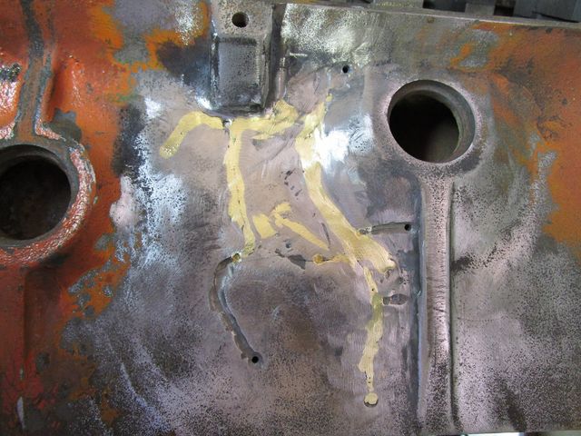

    I talked to a rep at Lock-N-S***ch, and those guys seem to be on their game on the phone. I had to send several pictures of the crack and I had to drill a hole to get the wall thickness. Then they'll put together the necessary items and give me a quote on materials. So far, it looks like the most plausible option aside from finding another block. Wish me luck! 20211124_120153.jpg 20211124_123109.jpg

    When you have that big of a crack, don't ***ume that's the only one. It can also be cracked internally. Blocks rarely just crack in one place...

    I think the crack looks bigger in the picture than it is (it's about 2 1/4" long), but I get what you're saying. The s***ching kit's going to run about $200, which is reasonable enough that I won't feel bad if I have to s**** this block and get a new one. At least I'll have given it a try.

    Just to follow this up - I installed the Lock-N-S***ch kit yesterday, and right now it's sitting with a full cooling system and 17 psi on my tester. I had a slight drip on one of my first pins, so I peened (peined?) it and the leak immediately stopped. The cooling system only has a 7 psi cap, so I'll probably throw some GM sealing pellets in the system and hope for the best. As of right now, it seems to have worked.
    As an aside, the Lock-N-S***ch company was really helpful with the questions I had all the way through. It was certainly worth $200, especially if it is a permanent repair, especially since I did the work with the block in the car. I'm cautiously optimistic about it. 20211228_125535.jpg 20211228_120900.jpg 20211228_141700.jpg

    I figured I'd update this post. I've been driving my '53 all year since repairing this crack, around 800 miles (hey, I have quite a few cars to drive). I did have to extend my repair a little past the visible crack after my initial post and pressure test it again, and it held 19 psi for hours. Ten months later, there's still no sign of a coolant leak, although I did have to really flush out the draft tube because there was years of moisture/oil vapor sludge plugging it up. It's amazing how sick an old car can be and still run decently well.
    Anyway, I had the valves touched up when the head was off, and I added a Best Gasket "Graph-***e" head gasket, and the cylinders are all within three pounds of compression (123-126 psi) and the oil pressure is the same as it's ever been. There's a little more blowby than I'd like for an engine with 20,000 miles on it, but it doesn't use much, if any, oil, so I think I'll be good to go until the next crack forms.
    Long story short, don't be afraid to use Lock-n-S***ch for a crack in an accessible area.
