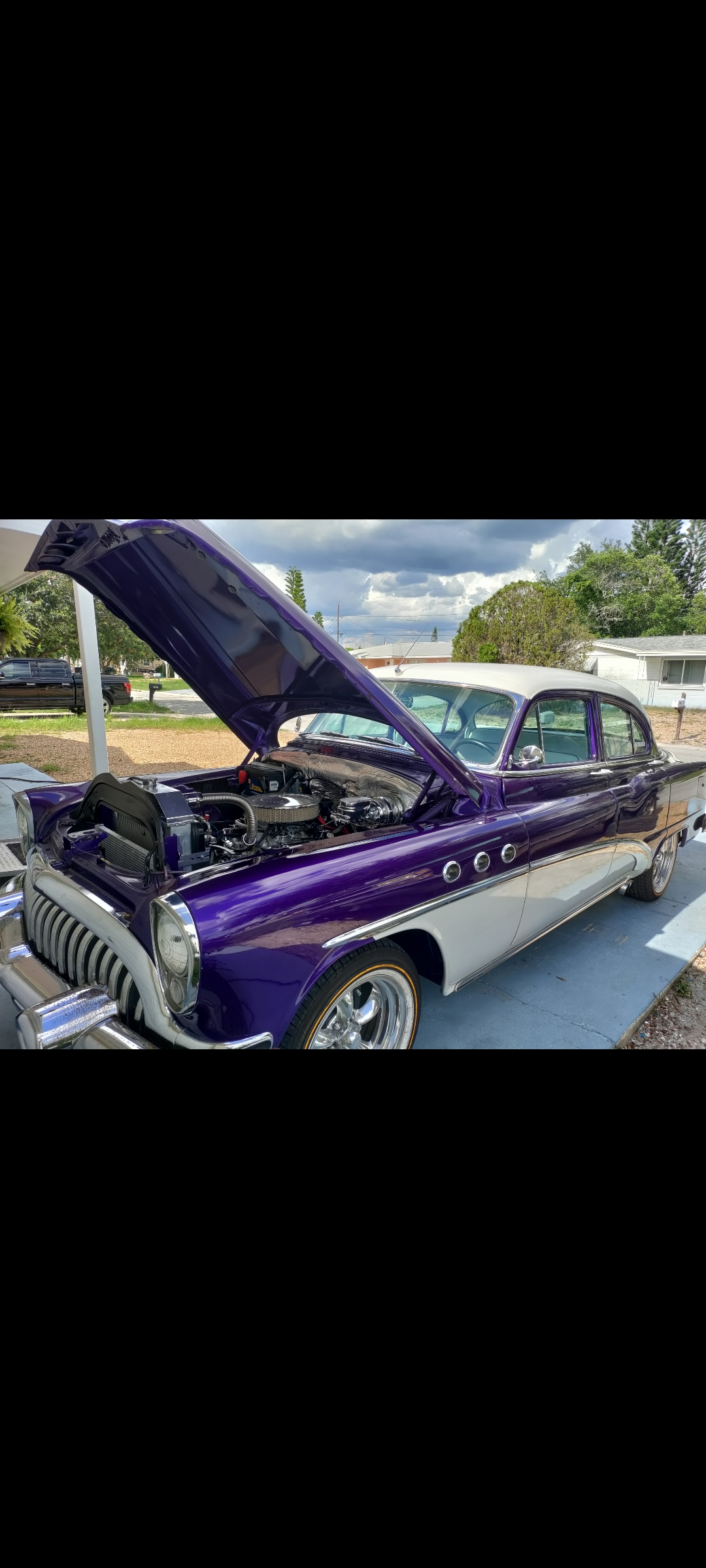

    Hi. I recently (2 days ago) bought a 1953 Buick Special Model 41D (4 door). I was told it has a Vette 350 motor with only 500 miles on it and only 500 miles on transmission that was also put in it at time of motor... They knew nothing about anything except for that. No paperwork on work done to car or who did the work. The guy owned an RV place and took it in on trade. (He still could have asked for some basic information though, at least in my opinion). But I got a decent deal on it and thought it looked super clean. (Plus wifey didn't want me to get a new toy but she thought it was nice and approved so I jumped at the chance) . I was able to get pictures of the numbers on back of motor drivers side ....
    41 GM (and underneath that) 3970010
    And then I got the numbers on front of motor p***enger side behind AC compressor
    V0607CLA (and underneath that)
    17S438718
    I tried to get the numbers on the back of motor on p***enger side but with engine in car it's really hard to get to. But it looks like
    Ehh... Maybe 73571 but I don't know. It's really hard to see.. ...
    And on the bottom of transmission pan it states 350 turbo printed into the pan. So I'm gonna guess that's what transmission is in it...
    It also has 4 wheel disc brakes on it. The suspension is really bouncy bouncy, so I'm not sure if that is stock or how to tell what was done to it for them to be able to have made it 4 wheel disc brakes. I know it wasn't factory. It also has power brakes, power steering and air conditioning. I'm not sure if the power brakes is factory, because I read that was an option...
    The only factory number I could find was on the drivers door piller. There weren't any tags in trunk and firewall has sound deadening (mat) material on it.
    Also is there a good place to find/buy parts like tail light lenses or knobs or aftermarket replacement parts for these cars?
    Screenshot_20250624-170457.jpg Screenshot_20250624-170444.jpg Screenshot_20250624-170415.jpg Screenshot_20250624-175736.jpg Screenshot_20250624-175842.jpg Screenshot_20250624-170457.jpg Screenshot_20250624-170444.jpg Screenshot_20250624-170415.jpg Screenshot_20250624-175736.jpg Screenshot_20250624-175842.jpg
    I'll attach pictures if I'm able to of numbers I could get pictures of.

    There's no way to hook a TH350 up to the stock "torque-tube" rearend, and swapping out the rearend in one of these means building some kind of different rear suspension, so you can be sure that stuff has all been replaced/modified in some way. The bouncy suspension might be a product of that, who knows what was used and how well it was done. Get some pictures up underneath of the rear suspension and we'll be able to tell how it was done, and what it might need to ride better.
    The "0010" engine block was used for a lot of years in many vehicles, it most likely is a 350 (I guess a few late '68 327's were also made with that casting number) but that's not enough to tell if it was from a Corvette or not. Those other numbers might but I'm not the right guy to decode those. However, it's almost a cliche to say every small block Chevy is a "Vette motor", and at this point, it doesn't really matter anyway. Being out of a Corvette doesn't necessarily make this engine any different.
    Those modern wheels make the car off-topic for the main board, so don't freak out if this gets moved to the off-topic forum. That's just part of the rules.

    maybe you can find some wheel covers that might fit those rims to give it more of a hamb friendly look... that's what I do when I run my later 15-in wheels on my 41 Cadillac.
    Algoma56 likes this.
  10. OT wheels?
    Looks like regular 5 spokes ya see here regularly
    mrspeedyt and ClayMart like this.
  11. DDDenny
    Posts: 22,617
    I'm not the wheel police but those elongated spokes and rubber band tires say seventeens or bigger.
    Squablow likes this.
  12. tubman
    Joined: May 16, 2007
    Posts: 8,301
    tubman
    Somebody spent a lot of money on that. It's a good deal if it's to your taste. Enjoy it while you have it, because the resale ain't gonna be much. There's a reason it was traded on an RV.
    A less garish paint job and some lowering and you might have a decent cruiser.

    "If the wife ain't happy, no ones happy". Don't pay any attention to my suggestions; I'm at least three generations removed from what's popular these days..
    Seriously, it seems like everything was done, and done right. Solving the rear suspension was a major accomplishment, and probably cost more than you paid for the whole rig. Even at my advanced age, I'm not really into cruisers, but I think you have a good 'un there.

    I love Vogue Tires, but maybe not on this car, or on those wheels. Since we're all adding our .02, I'd lower that thing all around and add wide whites & some full wheel covers.

    Me too. I actually like the paintjob on it, I feel like with a few tweaks this thing has the potential to be really great. Clearly a lot of money has already been spent on it by whoever put it together. Dial it in a little further, it'll be great.
