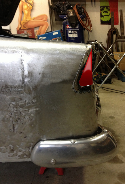

    Got a full day on the car today. I cut out the upper trunk radius and moved it out to line up with the new tail light bezel.
    Marked out a template and rolled up a filler piece to the new contour.
    Here is the new upper piece held in place to check a good fit.
    New piece tacked in place, need to still build a little filler piece for the bottom gap.
    Finished fitting new piece and cleaned up the whole tail light area before moving on to cutting the bottm and finished near the bumper end.
    Got to roll the car outside to take a few photos. Here is a side shot, it still is hard to see the angle. Im happy with the way it looks and moving onto the p***enger side on monday. I do not want to weld it completely yet in case I want to tweak anything once the p***enger side is done.
    This project is at the one year mark today. I took this picture November 10, 2011 when I started taking my car apart.

    Got most of the day on the car today. I first tweaked the bumper a bit as it was a tiny bit off from side to side. Then moved onto fabricating the tail light bucket and fitting it onto the car. I spent a bit of time getting the light fitted in the proper position, I used my laser level to get it as square as possible and cross referenced the angles to the drivers side.
    Fabricated the upper outta panel and tacked it into position with a bit of hammer work its pretty damn close to where I want it to be. Next week I should have the lower section installed and start the inner trunk radius'. Ordered a new set of 55 chrome bezels off ebay and a set of Lee bubble lenses. Should look awesome!
