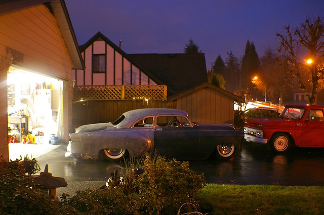

    A few more pictures schaefer took yesterday with his camera. Glad the rain stopped last night so we could pull the car out to have a look from far back. It was dark so excuse the low light pictures...
    Here's two shots of me grafting away.

    :D Those pics might be "low light",BUT to me they really highlite the build.
    Good luck.Have fun.Be safe.

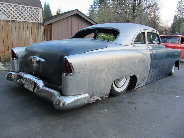

    Got the passenger side tail light fabrication all finished up yesterday. Bolted up my new bezels and my Lee lenses i purchased a few weeks ago. Super happy with how the tail lights look now that both are finished and ready to weld. Here is a few shots from all sides.
    Next up is starting the molded splash pans to flow the rear sheetmetal underneath the pontiac bumper. Gonna pull of the bumper this week and start building the wood forms to hammer the sheetmetal over. Will keep you posted once I start.

    That bumper looks great on there now! I think the other guy that said he didn't like it meant because it stuck WAY out passed the sheetmetal. It flows very well now. COOL!

    Diggin it,the extended quarters with tail lights look pretty damn cool.I like that combination!
