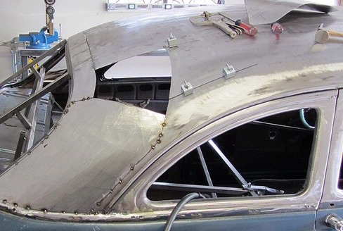

    Weekend update. Working on tying up a lot of loose ends and unfinished things before I start any new fab work. Learning a lot and realising i need to finish things competely before moving on. Got some smaller end pieces for my pans welded in so that i can roll and complete my ****** tunnel.
    And built a new ****** mount

    Another saturday update here. Mentioned last post I wanted to get some unfinished things i started completed before moving onto new things. Got a good chunk of the seat back wall fabbed up today. Still need to finish the upper 4 link cover plates and the transmission tunnel.
    Also got the notch cover completed today as well. Left a big access hole so I will be able to access both my air bags and shocks from the trunk. Will fab up a nice cover plate that will bolt into place over the hole.

  13. Such nice fab work, specially the back seat area, shame nobody will see it once the interior goes in.

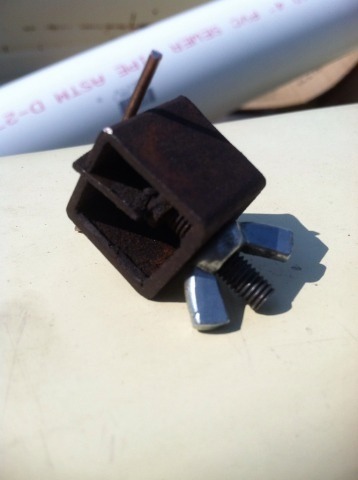

    I noticed you used the panel alinement clamps. What did you think of them? Iv used some like that before and wasn't all that happy with them. I didn't like the gap size or the big slug that went in the back. I ended up making my own of my design, they use a piece of tig wire instead of the square plug so if it falls out it and gets lost it won't hurt anything. You can also put the clamps in place before you put on the panel it makes it a whole lot easier to mount and test fit panels. If you want I could whip you up a set and send them out to you... Not sure how many more panels you'll be mounting on the 53 but might come in handy later

    I actually haven't used them much since the chop as I too were not happy with the large gap. I am mainly using Cleco's now for sheet metal fitment. They work awesome and are super easy to use.
