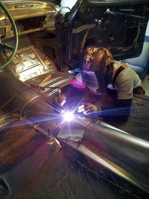

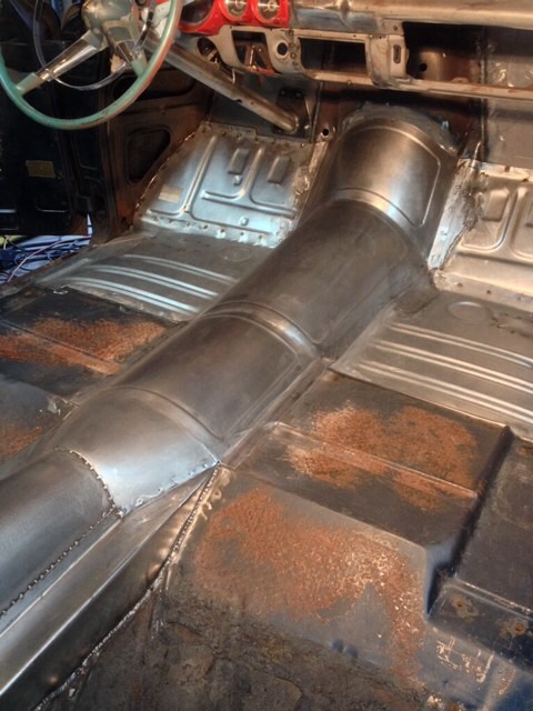

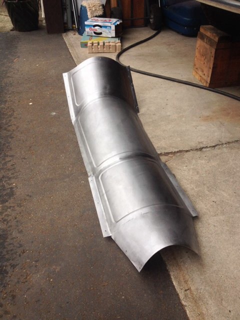

    More transmission tunnel progress today. ImageUploadedByH.A.M.B.1384049357.731661.jpg ImageUploadedByH.A.M.B.1384049375.107041.jpg ImageUploadedByH.A.M.B.1384049393.816369.jpg

    Amazing progress bro !!! Love looking at this build for inspiration. Haha to the horsepower thing . I think you're the wrong person to ask since this looks like a full Kustom not a street rod or a race car.
  17. 53chevtrev
    Joined: Jul 26, 2011
    Posts: 403
    53chevtrev
    from Langley BC
    Thanks man! This car isn't gonna have a crazy motor. All I want is enough power to cruise comfortably as I wanna put a ton of kilometers on the car. Building it to cruise and enjoy as a cool custom.
  18. rockable
    Joined: Dec 21, 2009
    Posts: 5,122
    rockable
    Awesome job on that floor and tunnel!

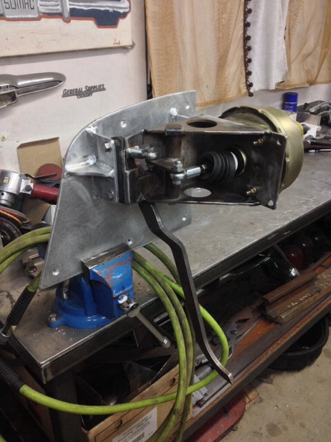

    Some progress this week. Started laying out and getting my brake pedal ***embly ready to install. Needed to be able to mount it to the firewall. Using inspiration from a tech article in rod and custom, I built two 1/4" aluminum firewall plates that would be bolted to the firewall. I lathed up some tapped bungs to weld to the firewall to spread the load over a greater area. I will be tying the brake into the dash structure as well. Going to use the p***enger side one fore my a/c unit and hopefully room on one for my fuse box. Makes things easy to access and modify if need be without touching the firewall itself.
    ImageUploadedByH.A.M.B.1384563922.782673.jpg ImageUploadedByH.A.M.B.1384563942.011264.jpg ImageUploadedByH.A.M.B.1384563962.328722.jpg

    Got my brake ***embly installed in my car last weekend. Worked out really well and is super strong with it tied into the dash.
