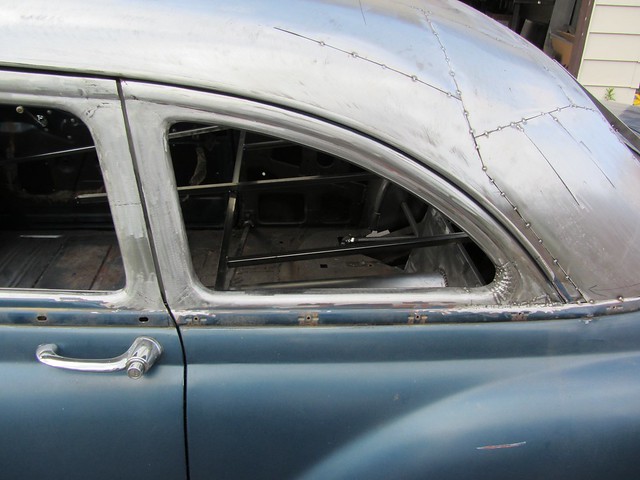

    Here are some more pics from todays work. Got the driver side sail panels all ****oned up and fitted. Got the lower piece fitted first.
    Once this lower section was tacked in and fitted correctly, laid out the top piece and slowly worked my way around the panel tacking as I go.
    Here is a closer look at the b-pillars ground down, I still have a bit more work to do on the lower corner of the window.
    All fitted, this roof is looking very nice.
    Glorified side poser shot. Very happy with how everything is flowing and looks like both sides are even which is great! Now that everything is fitted, I can start gas/hammer welding the roof and get this chop moving.

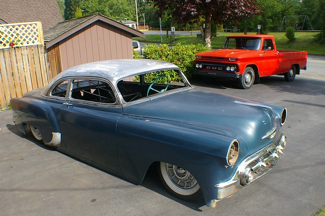

    Schaefer took this shot. I absolutely love this angle because my new truck is in the background as well. My two babies!

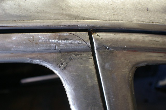

    Summer has finally arrived here in Langley and I have been busy enjoying the sun and tuning up my new daily driver, 1966 GMC pickup. Got back to working on the car today. Decided that I wanted to radius the tops of the doors. With my focus on trying to make everything flow correctly, I feel that this subtle modification is needed. The driver side turned out pretty good, it does take a fair amount of time, longer than I expected but im very happy with how it turned out.
    Marked out the radius I wanted.
    Door is cut and ready
    Started adding the filler piece, this was a bit tricky as there is a tight body line up under the drip rail.
    Cut the filler piece to match the door gap and new radius. Next step was to fill relief cut and new outter door corner.
    Driver side complete
