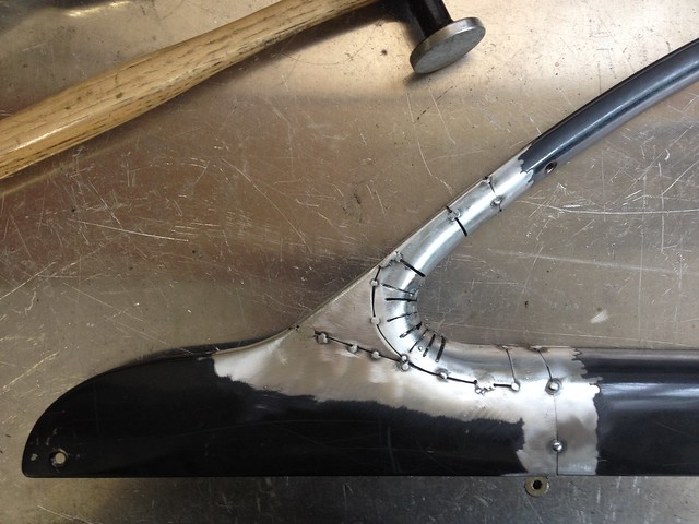

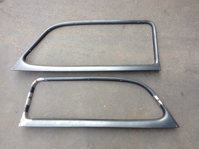

    Another sunday session on the car by Schaefer and myself. Completed the p***enger side radius fabrication to the door. Also started fitting the garnish moulding for the driveside door. It went a lot smoother than I had imagined it. I should be able to finish welding the roof up this week and the rest of the door inners and move inside the car this weekend.
    No progress photo's this time, just the finished radius
    Here is a shot with the bottom fitted and working on the backside of the garnish moulding.
    Driver side moulding sitting next to the factory p***enger one.
    Starting next friday I am off for two weeks paid "Summer Shutdown". Will keep things up to date and should be able to get a lot of work done during this period.

    Been able to get a bit of work done on my two week break.
    Had to relief the inside of the door frame near the vent window to allow the two sections chopped to line up again.
    Schaefer was over on sunday and we got the drivers rear garnish moulding tacked together.
    Here is a closer look at the rear garnish frame and the modifications I needed to make it work.
    Welded and finished up the rear garnish moulding.

    Lookin good man, Those garnish mouldings are very tedious to get to look and fit just right!

    Sure do man. And the fit from factory was mediocre at best!

    Excellent job! How did you grind the welds in the tight radius corners of your garnish moldings?
