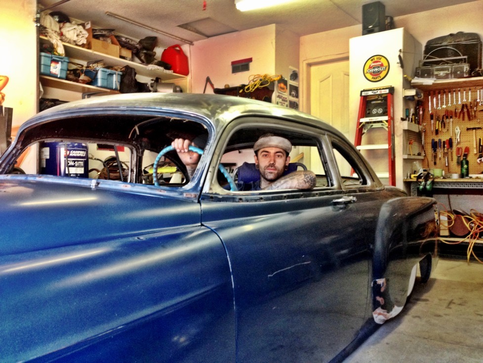

    Not much progress this week. I got a few weddings that are eating up my weekends and it's been really hot up here in Langley. I finally got my hands on the dash I wanted to put into the car. It's a 1959 Impala dash, in really good condition. I had time to sandblast and then buff and clean up the rest of it. It's ready to be sectioned and fitted into the 53. Also I got a picture of me sitting in the car, first time I have done it since chopping the roof.

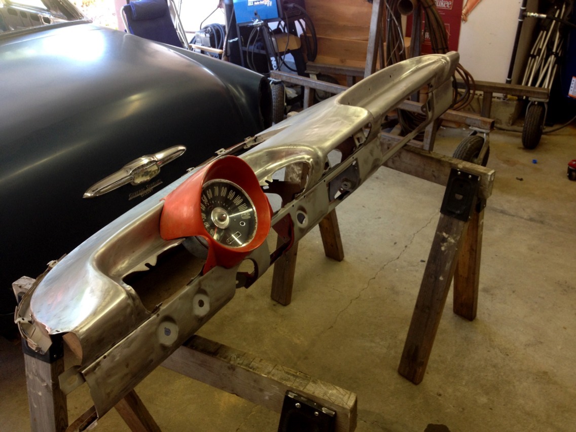

    Hello once again. Another great day working on the 53. The sun was out, it was hot but that didnt stop us from cracking away on the car. Schaefer came out to once again give me a huge helping hand.
    The chop is almost complete, it needs a bit more hammer work but im very happy with how the top has shaped up to be.

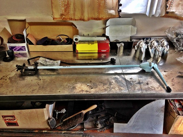

    Here is a picture of the Automatic Shifter ***embly that was giving to me by Lucky53. Thank you once again for the generosity and your money is in the mail this week!

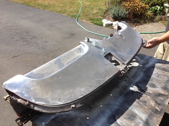

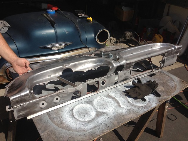

    The 1959 impala dash that I bought was a total of 10" too wide to fit into my car. I decided to take 6" out of the center and 2" on either end. This ended up working out perfectly.
    I will shave where the radio belonged and I cut the entire ash tray ***embly out and then fit back in once we sectioned the dash at this point.
    I salvaged the defrost vents and dash lip when removing the stock 53 dash. Using this contour i was able to cut down the impala dash to the appropriate radius making it an easy fit.
    Stoked on how the new dash looks and it flows really well with the theme of the car. My steering column will have to be shifted over 2" towards the p***enger side to be centered on the speedometer and fit into the dash notch. You can also see that i am going to have to mold the corners of the dash to flow a bit better.
    Final picture of the day. Hope you like the look of the new dash as much as I do. Cant say enough words to describe how awesome I think this looks in my car!!!
