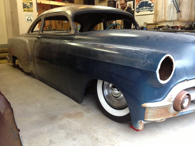

    Been a while since I have posted on here and it has been just as long since I have had time to get out and work on the car. Started cleaning up around my gas filler door last week to get ready to weld in a filler piece when I noticed some bondo below the hole. Turns out my 53 has been in a few accidents earlier in its life and were all fixed with loads of body filler. Decided to strip all the paint off both quarter panels to see the extent of damage and get everything cleaned up before i start the tail lights and rear sheetmetal fab.
    All I can say was that this job ****ed and it made a complete mess of my garage. I was gonna stop after this one side but decided to keep going while the mess was there. Then do a good clean afterwards.
    P***enger side had a bit of damage as well, nothing a bit of hammer and dolly work can't fix.
    Tonight I finished cleaning up the quarters and decided to start building a filler piece for my gas door hole.
    Gas door filler tacked in place and ready to gas weld it maybe this weekend.

    Good to see you back at it. Good to hear youre going to gas weld that rear quarter...that 53 rear quarter can warp bad after filling a gas tank door. Ask me how i know...

    How do you know? haha jk. There is some body damage right below the gas filler so im going to smooth it back out while im hammering the quarter.

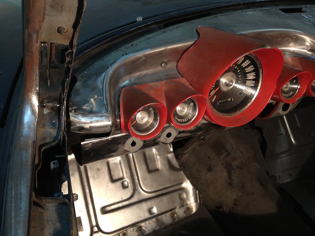

    Quick update for a monday night. Got a few hours out in garage tonight after work. Decided to try an idea out for the end of the dash where it meets the door jamb. I didn't want to just cap the ends of the dash as its too sharp and wont flow with the rest of the dash.
    This is as far as I got but I'm really happy with how it looks. I'm still trying to figure out how the lower section of the dash will flow into the door jamb.

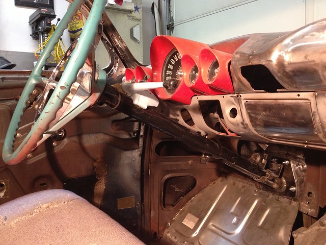

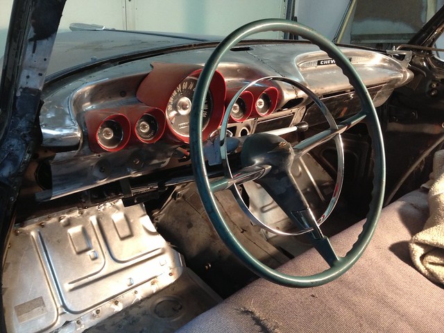

    Got some hours in the shop this week. Decided to do some smaller jobs as I only had an hour or two a night. After installing the 59 impala dash, my steering column needed to be moved over 1.75" to line up with the center speedometer and the center of the pods. I built a new piece instead of trying to cut out the old piece and move it. I also wanted to make the hole in the firewall smaller as my shift linkage is not going into the engine bay.
    Here I bolted the column back in to see how it fitted and where i will have to mount in underneath the dash. I was wondering if i would have to shorten my column a bit for clearance when sitting in the car but i dont have too much room before my shifter hits the dash. Might have to change to a wheel with no dish.
    So the plan is to use the original belair powerglide shifter with linkage modified to work with my 700R4 transmission. I have moved the linkage from the engine back to up under the dashboard to keep my engine bay clean and simple. I will go in to depth later on when I am making it actually work with the transmission.

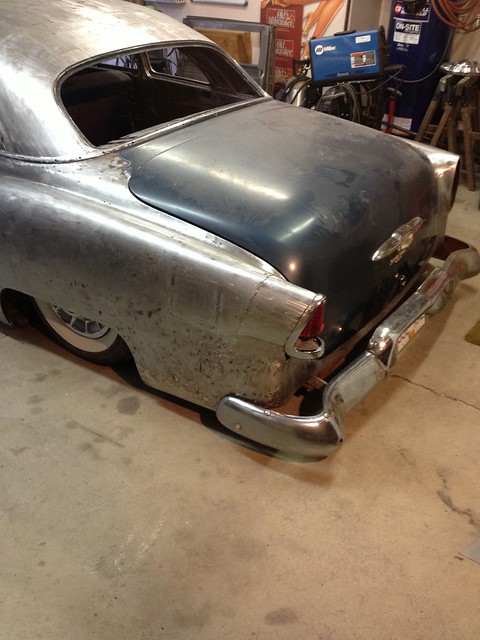

    Great progress on the 55 chevy tail light swap. Got driver side light mounted and one piece fitted in place. Here is a picture of my pontiac caps on to get an idea of how they look, I love them!
    Rolled up some sheetmetal to make the backing plate for the tail light housing.
    Tail light is fitted.
    Another angle of the tail light tacked in place using rod. Now to start forming a piece to be the upper panel to the quarter.
    Sorry for no midway shots. Top panel is fitted and flows perfectly with the top of the quarter.
    Another angle.

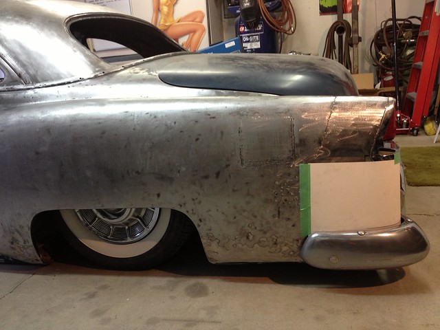

    Schaefer and I played around with some card to get an idea on how the bottom panel will look. I will be moulding in the splash pan as well. More to come next week once i have rolled some pieces to work below the tail light.
