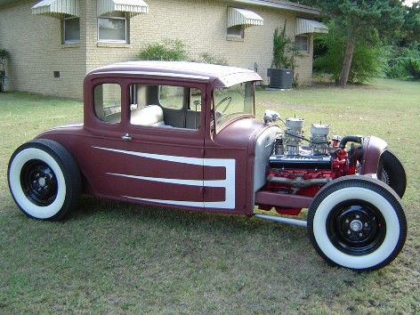

    Here is pictures of Krobe's Hot Rod.....
