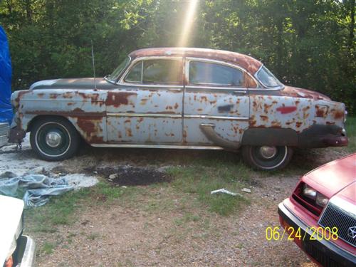

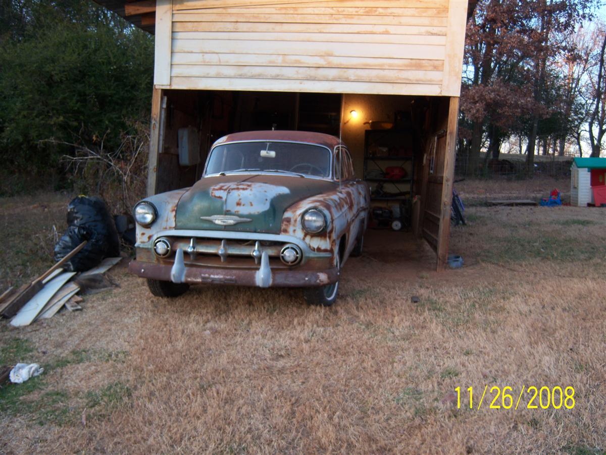

    I have a 1953 chevy 210 4 door and would like to
    put a full tilt front end on my car i need to know
    how hard it would be the front end of my car is all
    steel and i would like to do this i like the way it look's
    on other hot rod's
    here are some pic's of my car
    any help
    thank's buggmann

    Tilt front ends can be handy on a race car. They can be complicated to fabricate and hard to make work well on a street car. I say this because I have fabricated both types. My truck has a fiberglass one piece tilt front and it is street driven. Our Bonneville car and our Henry J gasser both have tilt front ends. I would strongly advise spending your time and money on other things that your car needs.
    My opinion.
