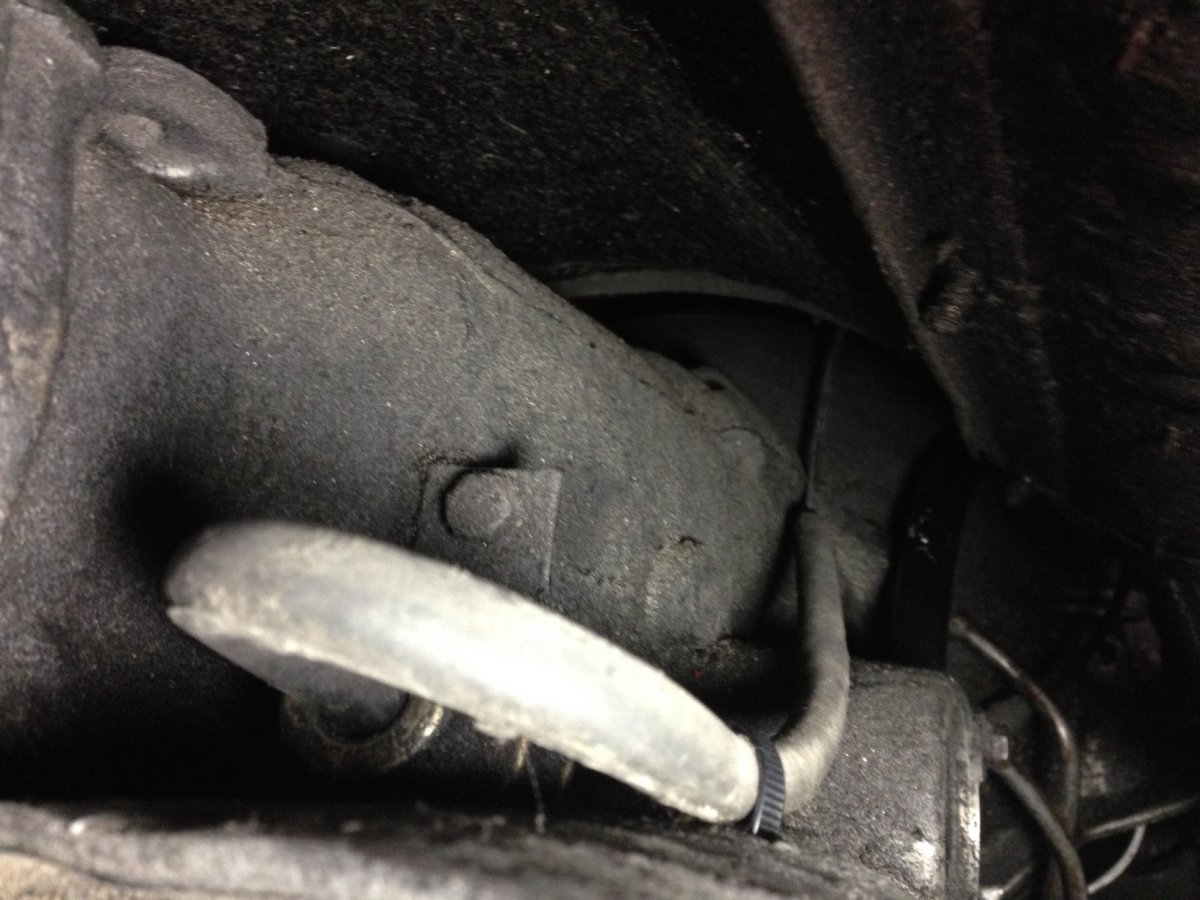

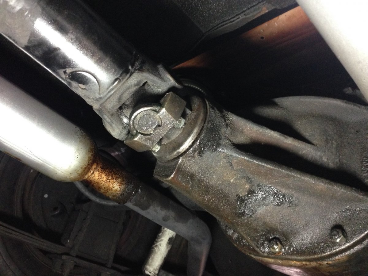

    The differential is leaking and gear oil makes it to the exhaust. Eventually I need to have the differential serviced. For now I've been just making sure there is some fluid in there. The leak seems to be at the front where the drive shaft goes in.

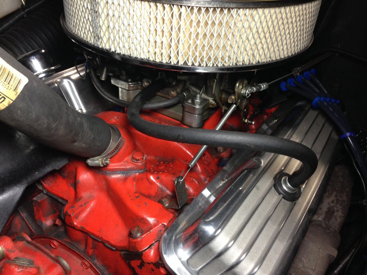

    Now regarding vacuum lines:
    A good portion of the transmission line is steel line. The ends are rubber pieces and they look quite old but I don't see any tears/holes.
    Here's a view of the trans line going into the intake manifold. Notice the steel to rubber end.
    The dizzy line and the PCV line don't look too bad and are not brittle.
    What should I do? Grease the U-joints and replace the ends of the transmission line with new rubber pieces and then drive it and see if the beep/squeal/whine noise went away? Do I need to take the driveshaft out at this point?

    Anyone have suggestions on what to do for the vac line for the transmission? Replace the ends and leave the middle steel line as is?

    What's your driveshaft rubbing on? It's very shiny on the differential end.

    Not sure I'll have to get under and recheck.

    I just took out the rubber segment that connects to the intake manifold and it had a tear in it. I don't think I did that getting it off. I wasn't yanking on it. I can see through to the inside when I bend it, the trans shifted fine though.

    Maybe you found the source. Time to replace and find out.

    Replace the cracked rubber hose, grease the u joints and see what is rubbing on the driveshaft and fix it. Then go for a test ride!

    I wish I could tell you what to do about the noise, and all the suggestions you have received are good ones. When I saw the picture of you engine I noticed you only have one return spring on your throttle linkage. While you are fixing things now would be a good time to add a second return spring for safety sake [​IMG]

    I really appreciate you catching that. Here is a photo of the spring that was on the car when I got it. It was annoying because it would hit and catch on the idle adjustment screw and make noise and the spring was releasing.
    I replaced it with the thinner diameter one.
    When I look online, lots of people with Edelbrock carbs seem to be running only one spring but not sure why. I can put a second one. Thanks.

    Buy a regular throttle spring, they are double and one is inside the other. Gary

    That's the first thing I noticed when I saw that picture too... it's rubbing on something to be thatshiny

    Is the shiny spot you guys are talking about where he grabbed it with his hand to check for play? Because that's what I am seeing
