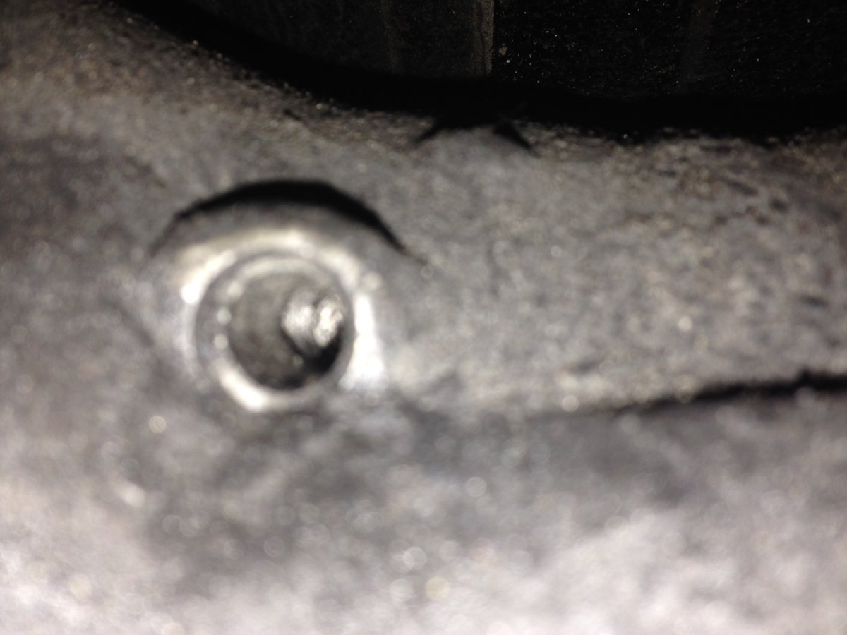

    Some more time has gone by and I haven't had a chance to do anything except I put the car on jackstands this morning. I can't tell if the TH350 trans vent bore has a hole on the side that I can't see in the photos, otherwise it looks purposely plugged. I cant stick my head that far up to see so I had to use my iphone to take photos. I tried with a mirror and light but couldn't see anything well.
    Nonetheless here is what I plan to do on my drive in a few minutes.
    1. Listen to noise from the vent. I put a 6 inch piece of tight fitting plastic tube in the trans vent bore. Smaller tube shoved into the bigger tube and then running that through the floorboard master cylinder access and enough length that I can put it in my ear. It's small diameter but it's all I had. It should pick up noise as I tried tapping on one end before and I can hear it.
    2. I removed the fresh air tubes on both sides and the floorboard piece that covers the master cylinder. I hope I can hear which of the three is loudest.
    3. After trying the first two, I'll pull the dipstick tube out so its free floating. Maybe the vent is plugged and I can't tell.
    4. Spray some carb cleaner around the carb gasket. Early in 2015 I had to take one of the cylinder heads out and I had reused the gaskets on both sides of the spacer. I'll spray around the gasket when the engine is warmed up and idling and see if the idle changes.
    Hopefully that will give me some more clues.
    Lastly I read somewhere that someone had reported whistling noise but their transmission shifted fine. They cleaned out some "goo" from the modulator and the noise went away. There was some dirt and junk in the hole of mine which I cleaned with a paperclip but I didn't take it out and heavily clean it. If I removed the vac line and the noise didn't go away it's hard to imagine anything inside the modulator making noise unless the pressure in the trans is vibrating the diaphragm and transferring the vibration to stuff inside. Is that far fetched?
