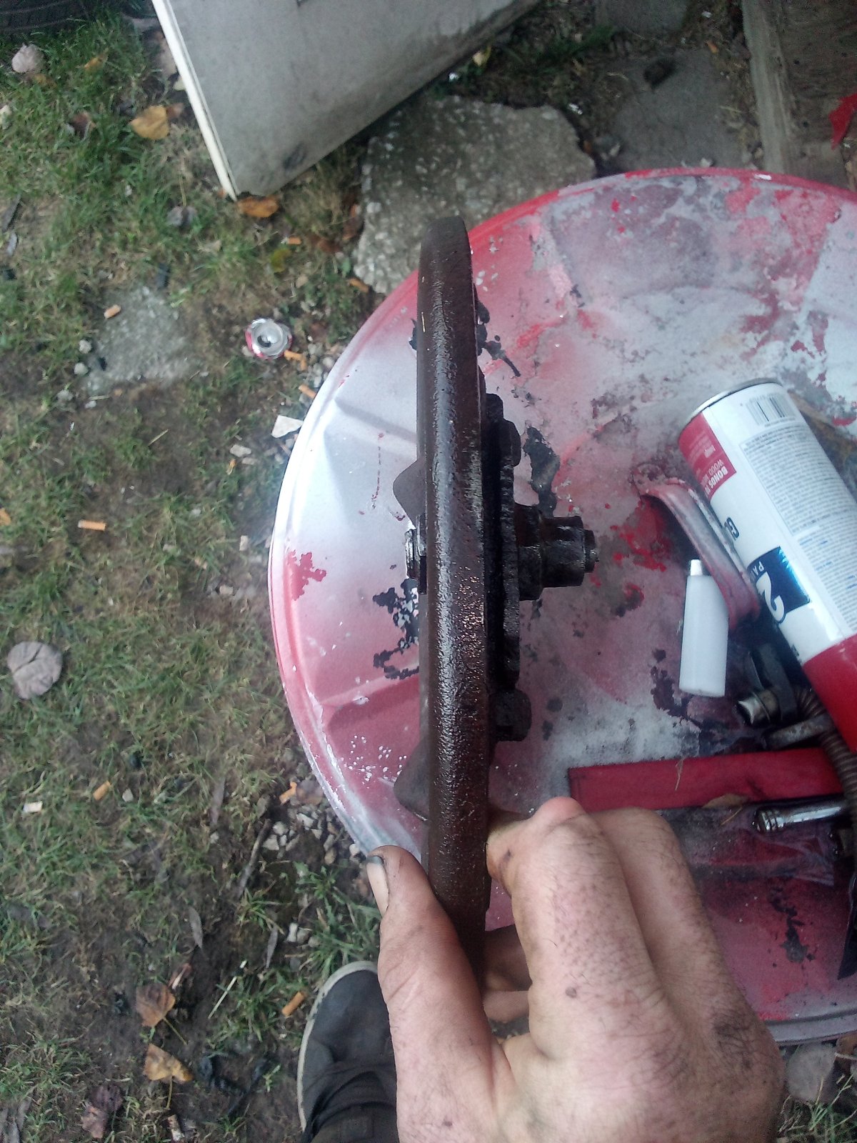

  13. So after waiting a couple weeks to hear back on replacement backing plates for my 58 Impala rear end I decided to take a closer look at the original 58 backing plates. Thinking I'll send blast this one tomorrow and see what I have left. I had automatically thought I had bent them hammering the axles out but they appear fairly straight IMG_2023-10-26-17-30-00-347.jpg IMG_2023-10-26-17-30-45-776.jpg

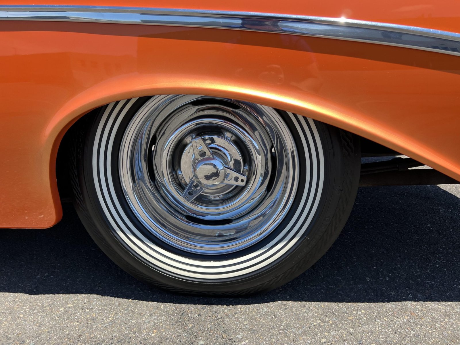

    My 56 Chev conv custom has 53-54 chev wheels that were chromed, they have been on it since 1962 ish, when they reversed em they left the valve stems on the inside! 56triple.jpg 56scottyb.jpeg

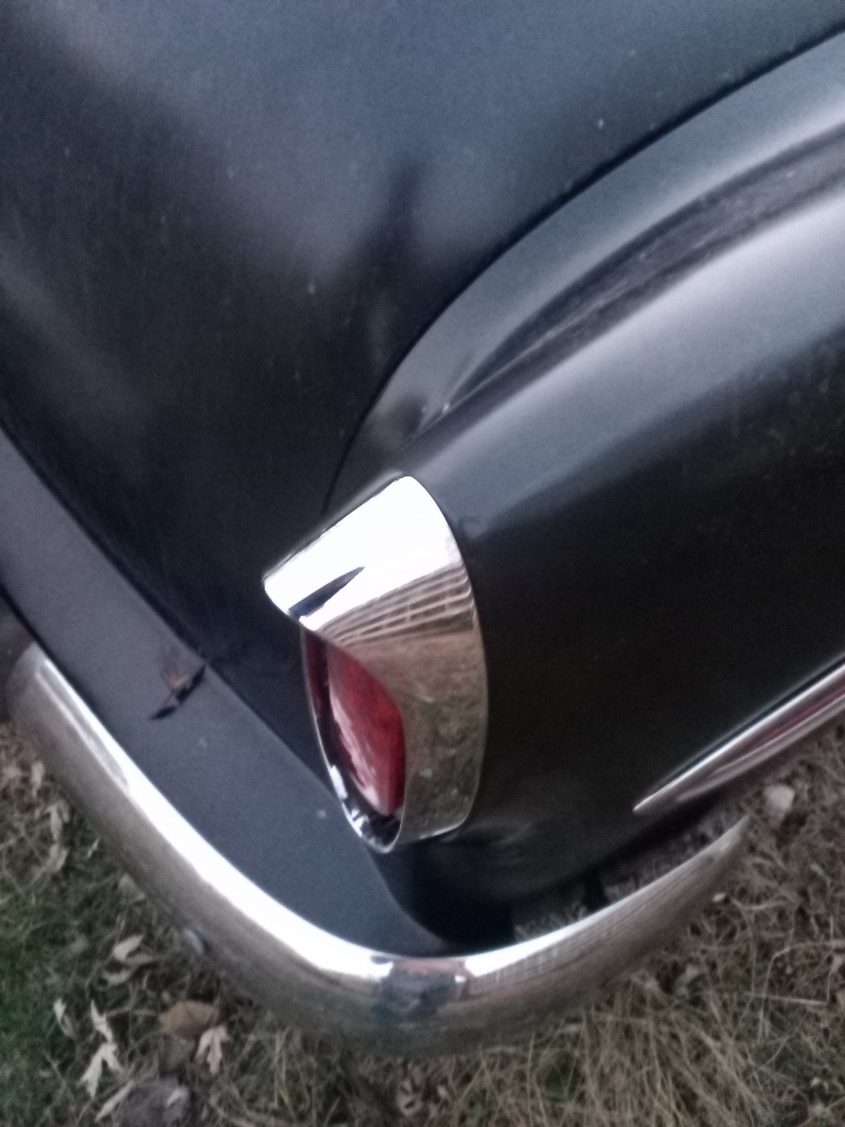

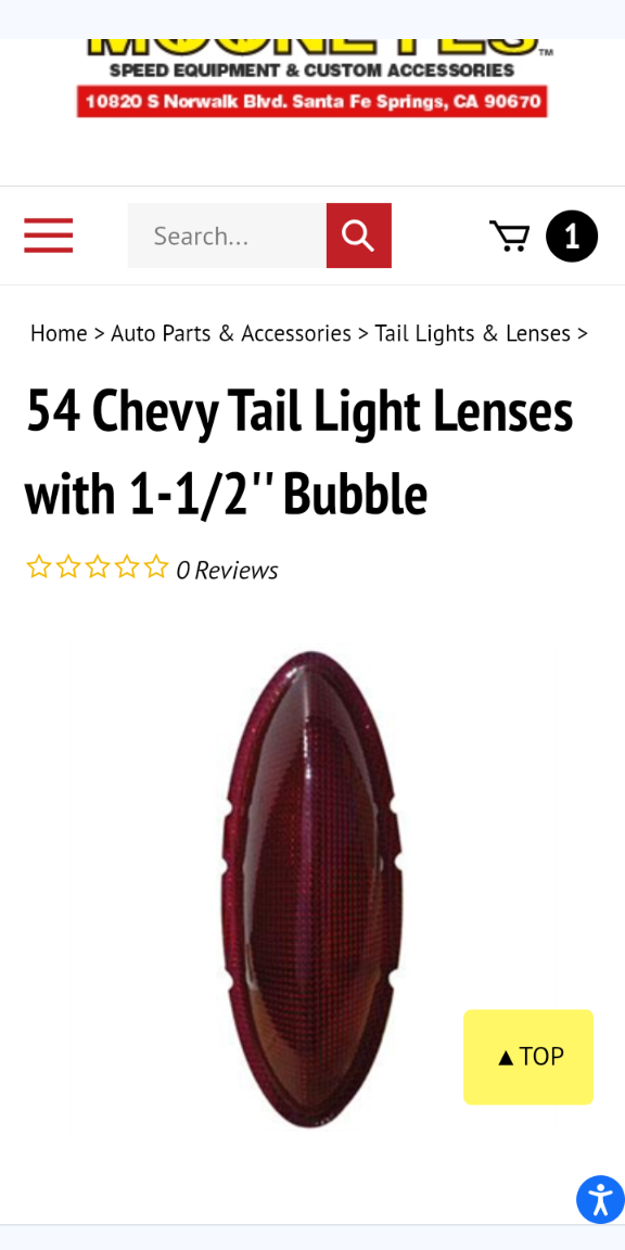

  27. In other news what I intend to order once I'm able to cash my paycheck this week lol. Was going to order the lakes pipes this week but currently don't have a way to connect them. In comes the random mandrel bends. I'll chop and weld them how I need then connect with band clamps to both down pipes and lakes pipes. Then I'll finish up my tail light project. Even before I got the car home I wanted to do 54 tail lights and lee style lenses. Ordered one 54 tail light off eBay and a second one off a guy I got a bunch of other parts from. Same guy convinced me to convert to led using trailer lights. First pic is how they currently are. I'll trim back the red covering of the led lights to clear the lee lenses. And I'll use new repop bezels from speedway......they actually have good reviews. Lenses I'm a lil itchy on because as many good reviews for mooneyes as there are there are just as many bad ones over their shipping. So I hope they actually arrive lol. I'll order the lakes pipes next week or the week after Screenshot_20231026-204559.png Screenshot_20231026-204229.png Screenshot_20231026-204406.png
