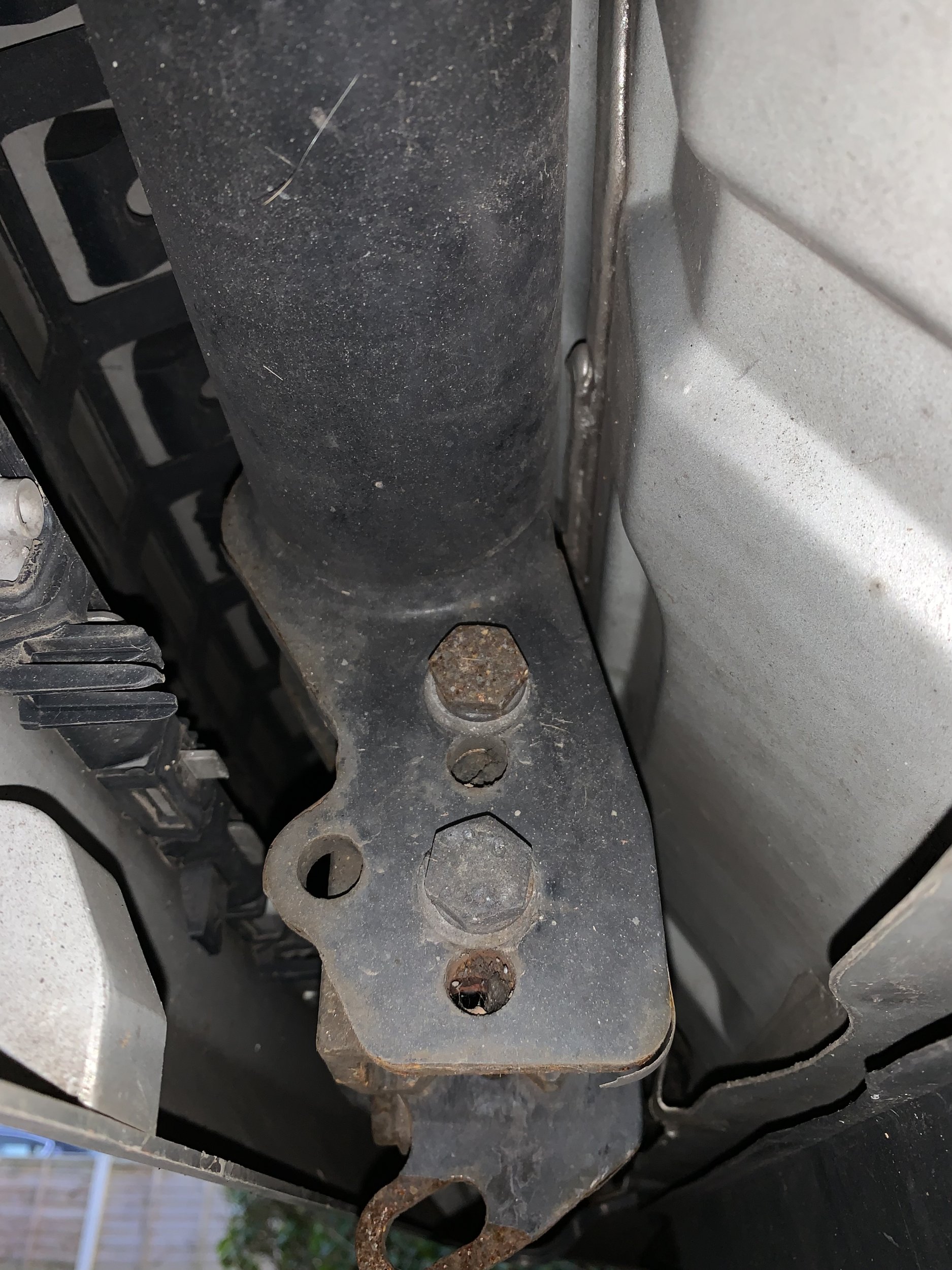

    Certain OT Land Rover owner's manuals have some neat ideas about discrete towing hitches. And yes, this is a real owner's manual excerpt. Maybe a mechanism like that could be replicated, or harvested from a junkyard.

  7. VEDETTE

    Most European towbars work like that. I’ve got one on my daily. The towball and its mounting bolt on to the strengthening beam at the back of the car.
