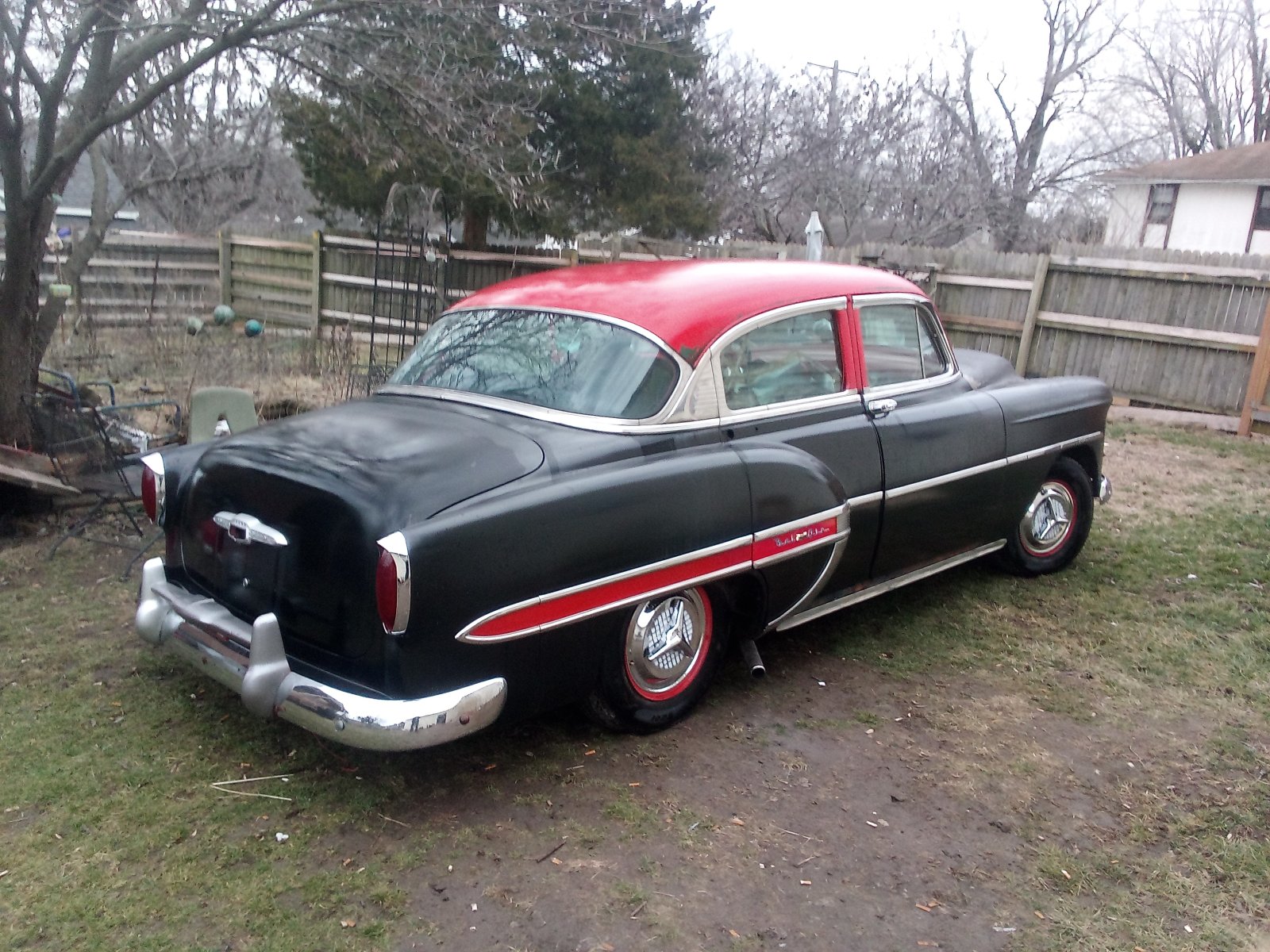

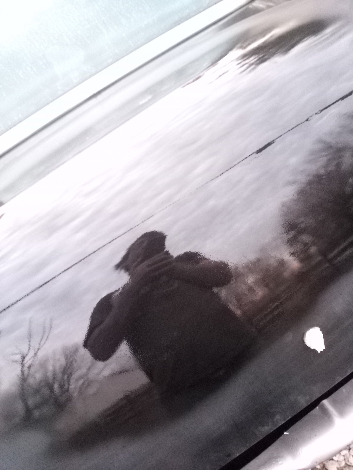

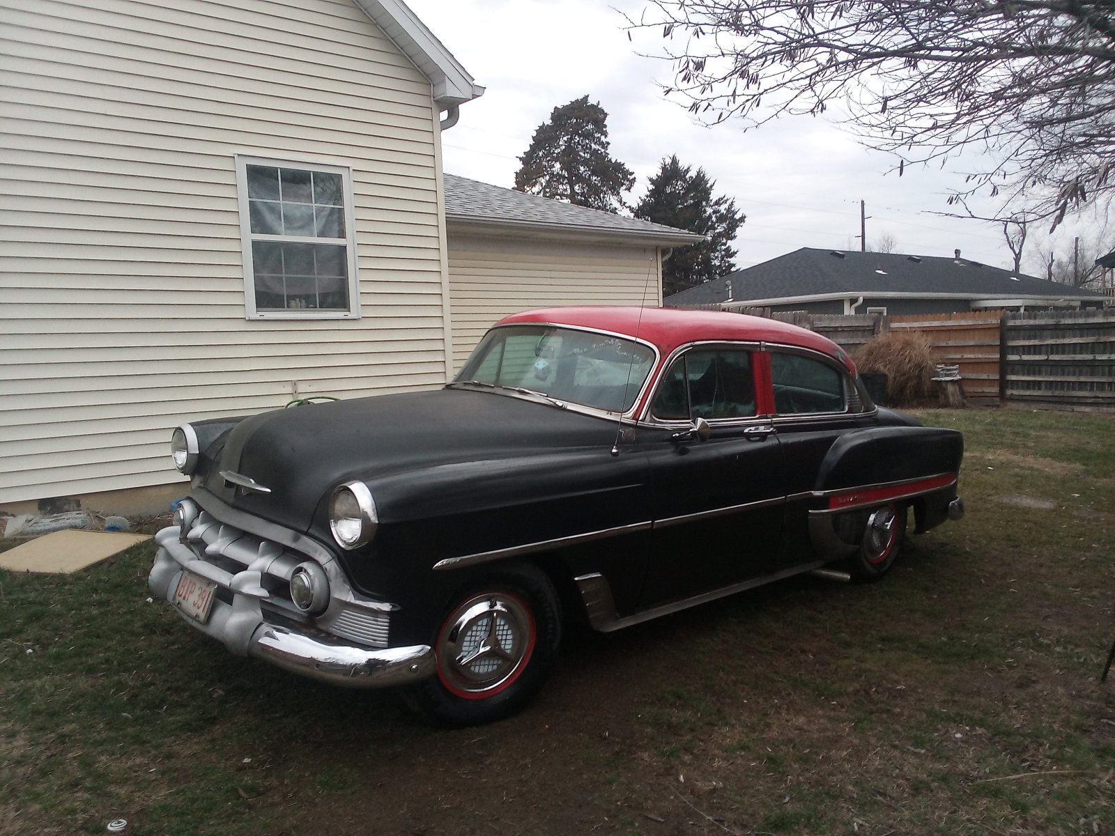

  1. Just to show you guys that it does actually move I took these after I moved it to the house to give it a quick rinse. Still too cold for a wash lol IMG_2024-02-03-16-56-04-030.jpg IMG_2024-02-03-16-56-23-048.jpg
