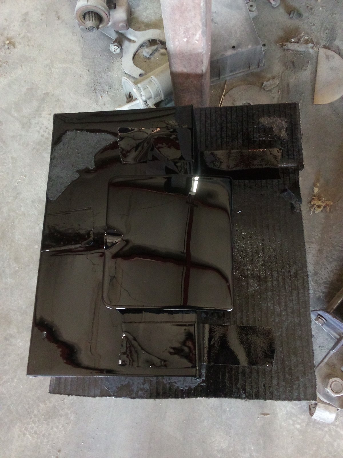

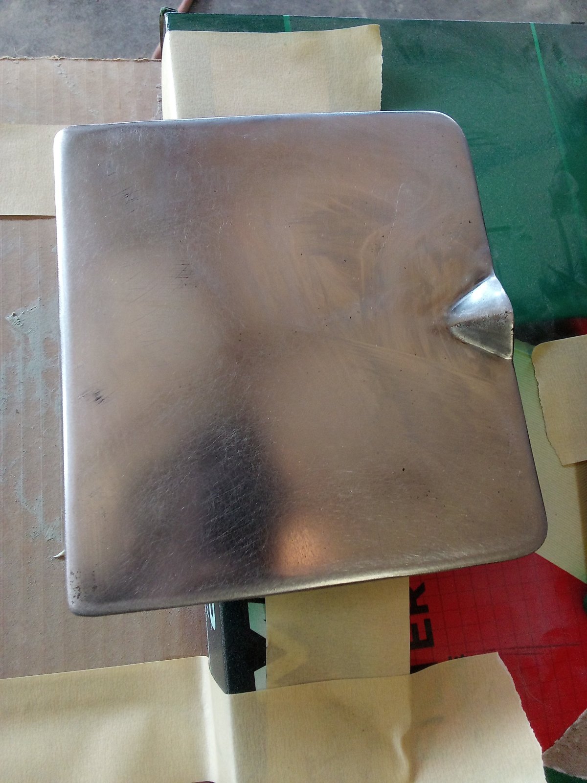

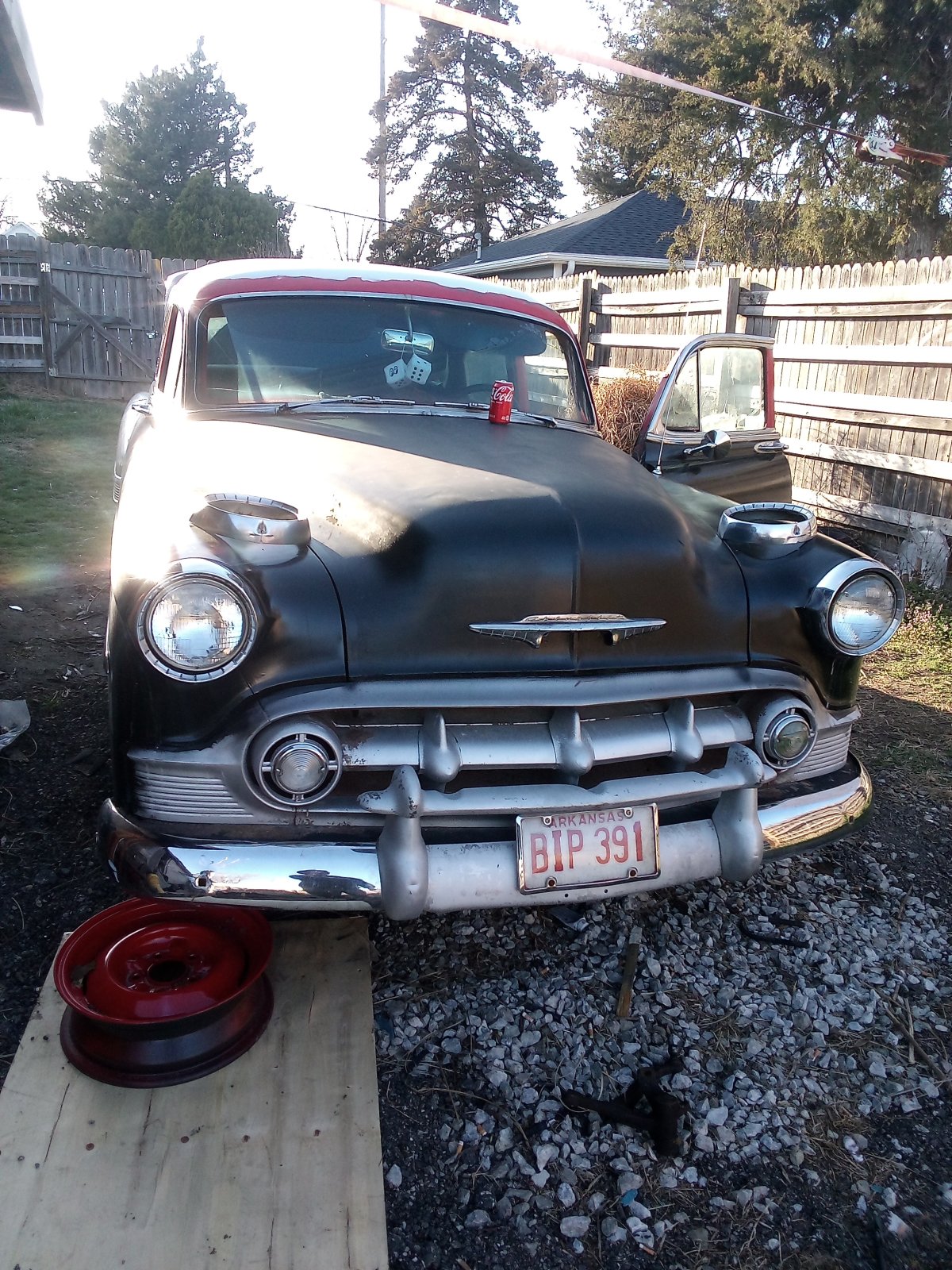

  8. I wanted the blackest black paint for when it came time for real paint. Got a wild hair and brought my gas door to work to strip off the rattle can and spray with the single stage nason black I bought last summer. It's definitely black lol. I may start pulling my doors off one at a time and doing the same thing to them so I have less hand sanding. IMG_2024-02-29-10-15-57-432.jpg IMG_2024-02-29-13-31-35-472.jpg

  10. Now I just have the rest of the car below the belt line to do lol

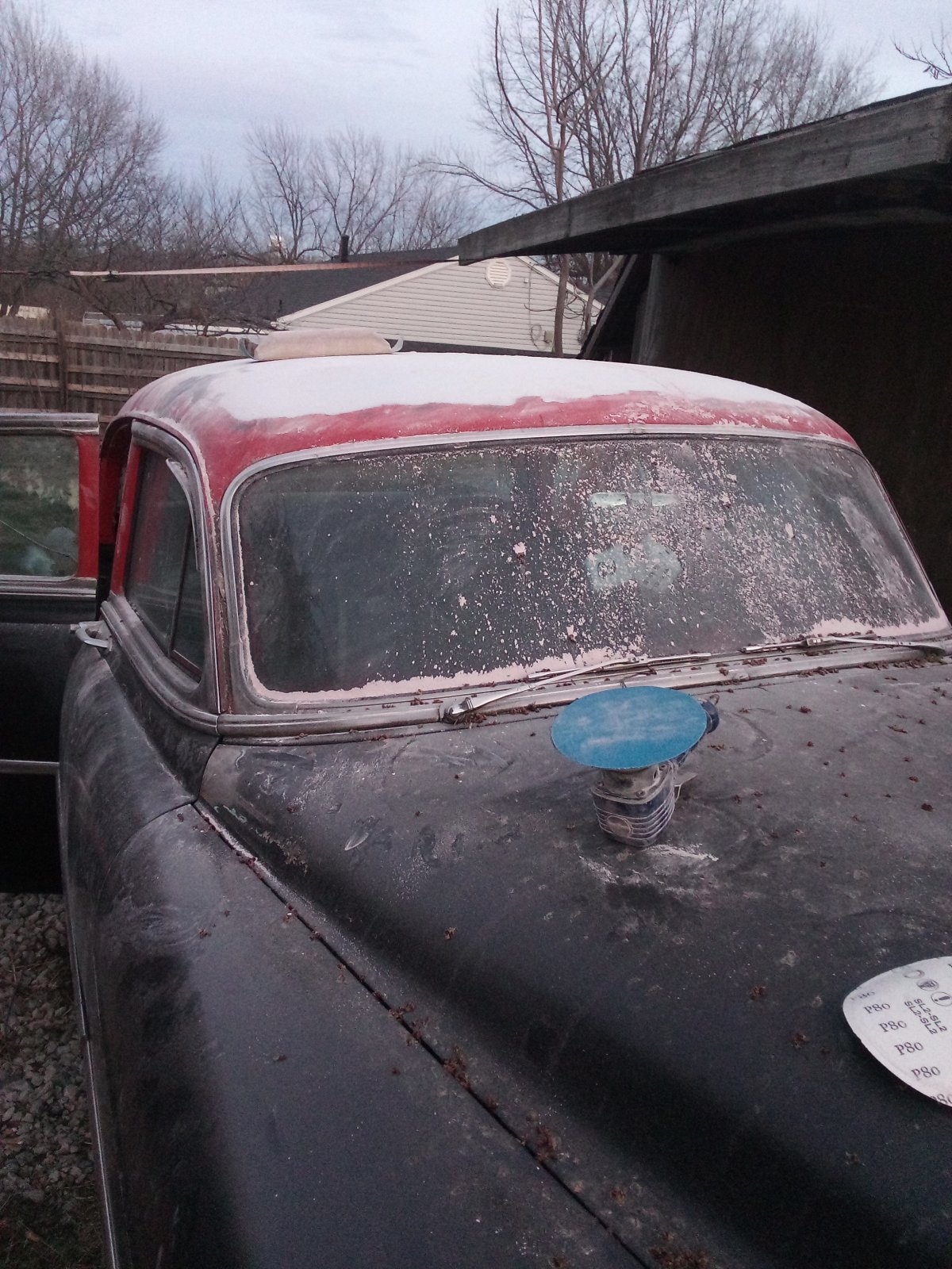

  11. And a fun wholesome Thursday evening. Goal is to have the roof in paint this weekend. So that means I'm going to try to have the roof blocked by tomorrow. Would really like the roof to be in primer tomorrow but we'll see how it works out IMG_2024-02-29-18-17-09-749.jpg

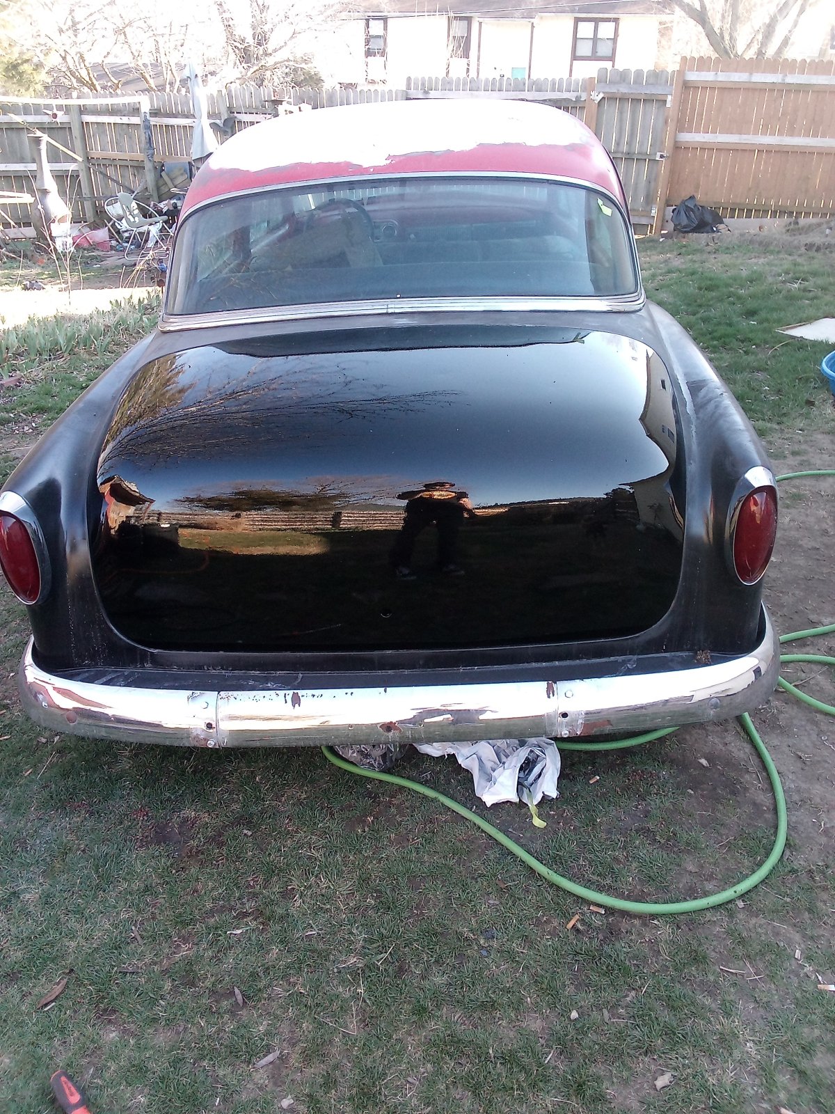

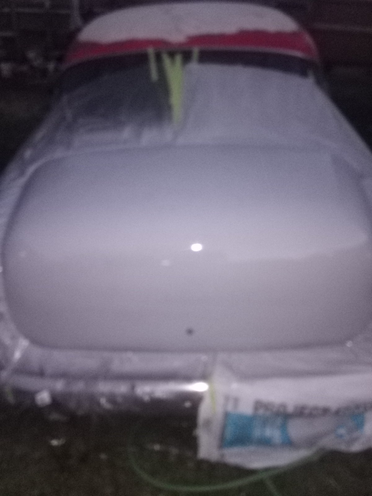

  12. Goal was to get the roof in real paint this weekend but even before I found a spot where I didn't quite get the filler mixed the concept made me tired lol. Instead I switched to the trunk. Got the rattle can stripped off and am getting primer laid. Figure I'll wet sand the primer in the morning and get it in paint tomorrow afternoon IMG_2024-03-01-18-27-31-138.jpg
    Okie Pete likes this.
  13. Well thanks to both the wind and a nearby tree getting excited as I laid the last coat a bunch of trash got in the paint. I'll try to fix without repainting again but worst case scenario I just wet sand it and put another couple coats on when I do the quarter panels. Am even more pleased with the paint choice though lol IMG_2024-03-02-15-41-40-343.jpg

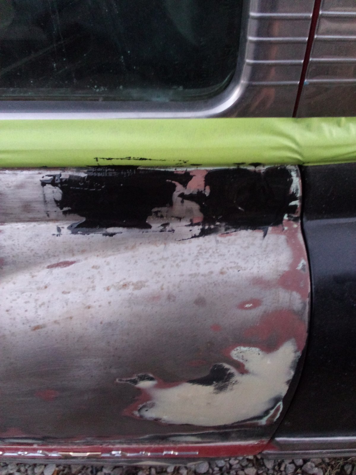

  17. And got the wobbly idler arm swapped out. Was definitely more of a pain engine installed not impossible. Steering wheel feels a whole lot different now lol. Also started sanding the quarter panels and stripping paint off rear doors for bodywork and paint. Not too bad for a lazy weekend where I had non jalopy obligations too lol IMG_2024-03-03-18-04-49-739.jpg

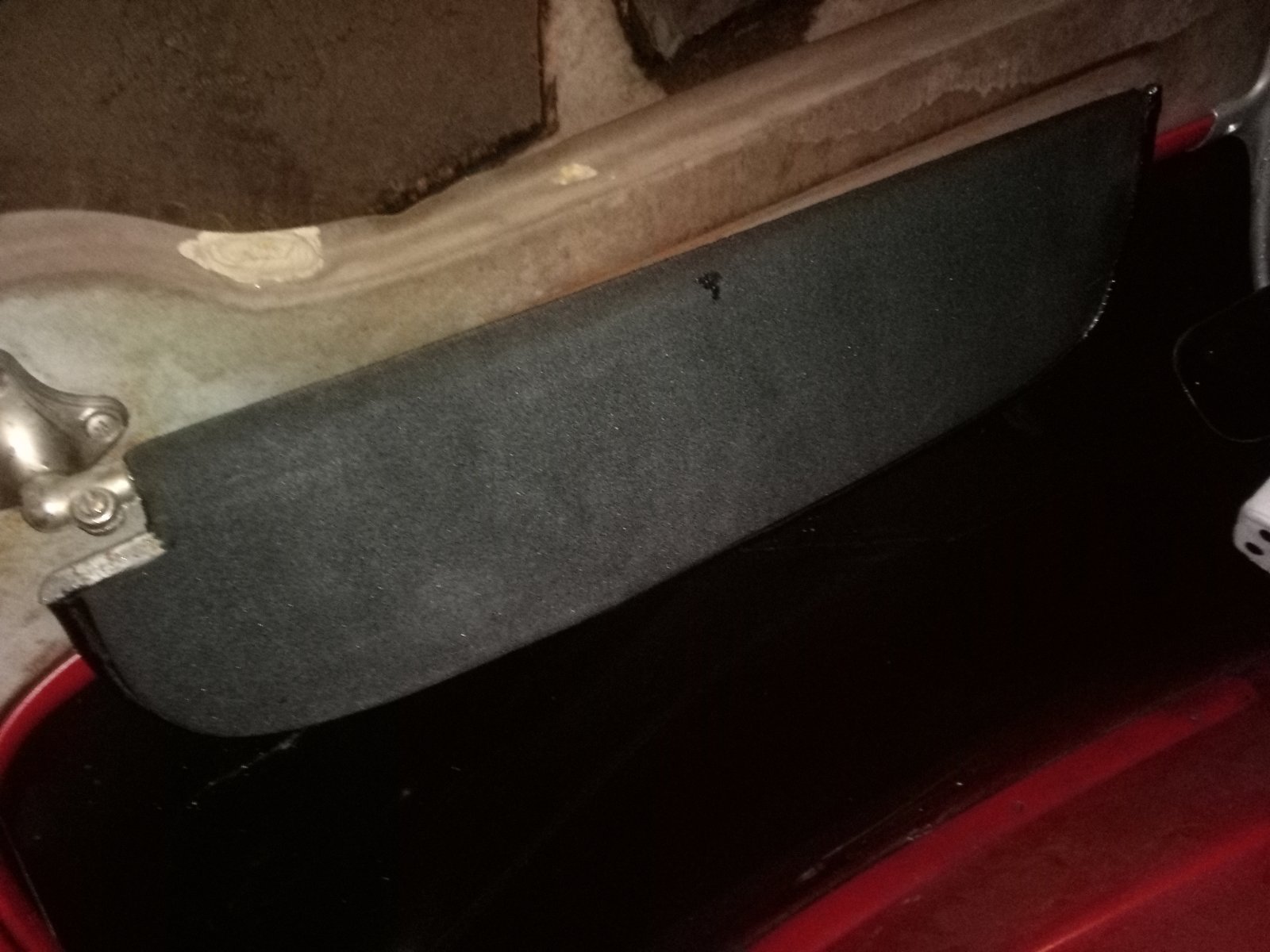

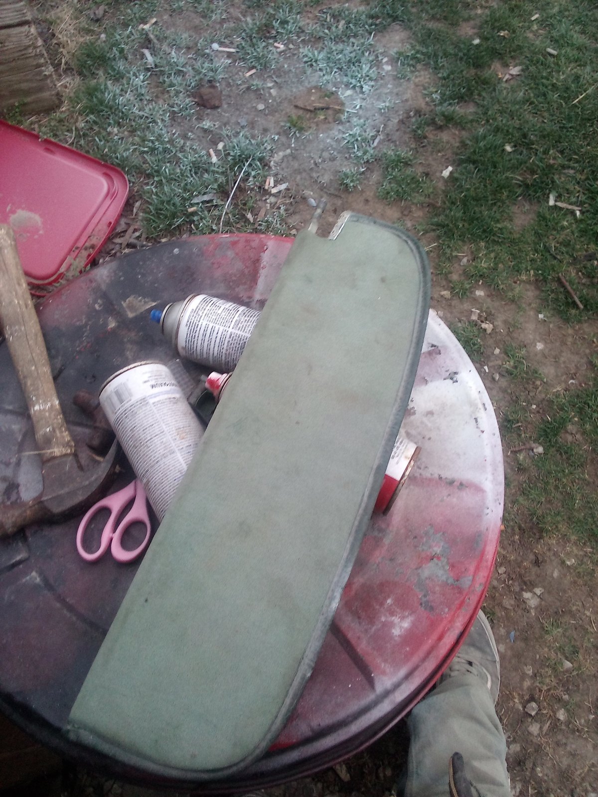

  18. And had a set of nice original upholstery sunvisors given to me yesterday...but in the wrong color. No big deal as since I don't need perfect (but as I AM light sensitive i need visors lol) i went and grabbed a can of vinyl and upholstery paint. I've got the other one drying and have to dig up a mount for it but I'd say it's definitely good enough for the girls I run with lol. Seriously though these kinda made my night. Before I was running one sunvisor I'd recovered..... problem is that despite me having a high natural ability at upholstery visors are one of my weak areas. And without a visor at all my eyes get to hurting during the day. So not only a thing for looks but actually important function IMG_2024-03-05-17-39-46-613.jpg IMG_2024-03-05-19-01-31-510.jpg

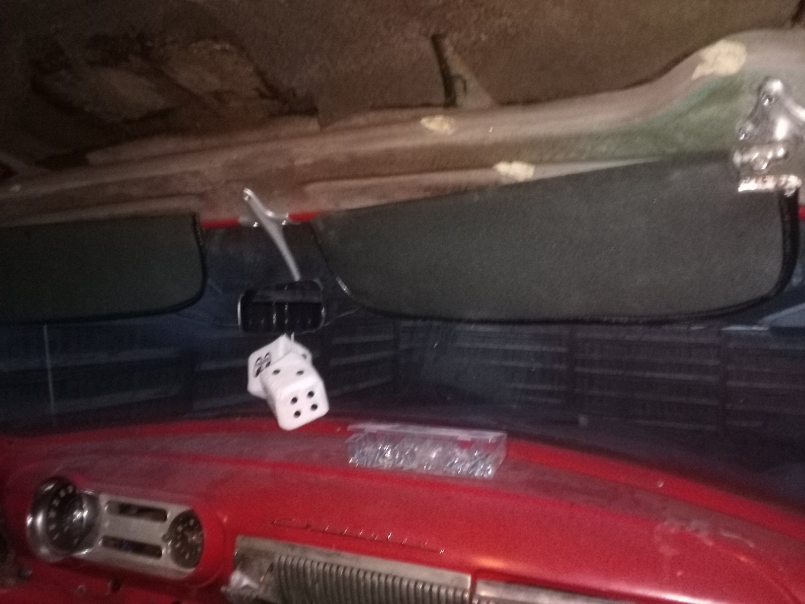

  19. I got the other visor in. I think the p***enger side mount I used is a lil tweaked and I used the wrong screws but again good enough for the girls I run with lol IMG_2024-03-06-18-35-15-788.jpg

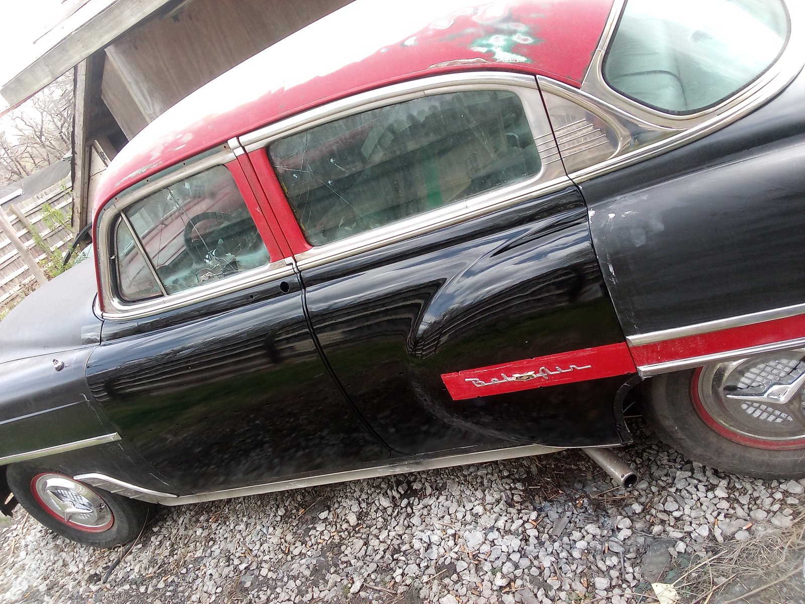

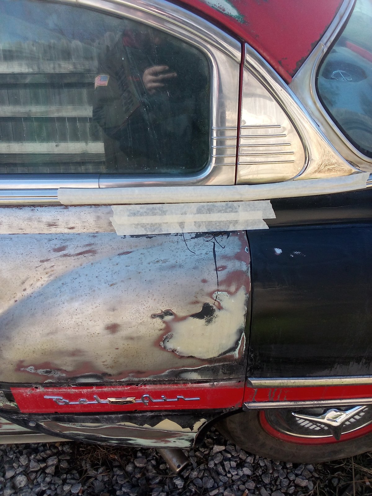

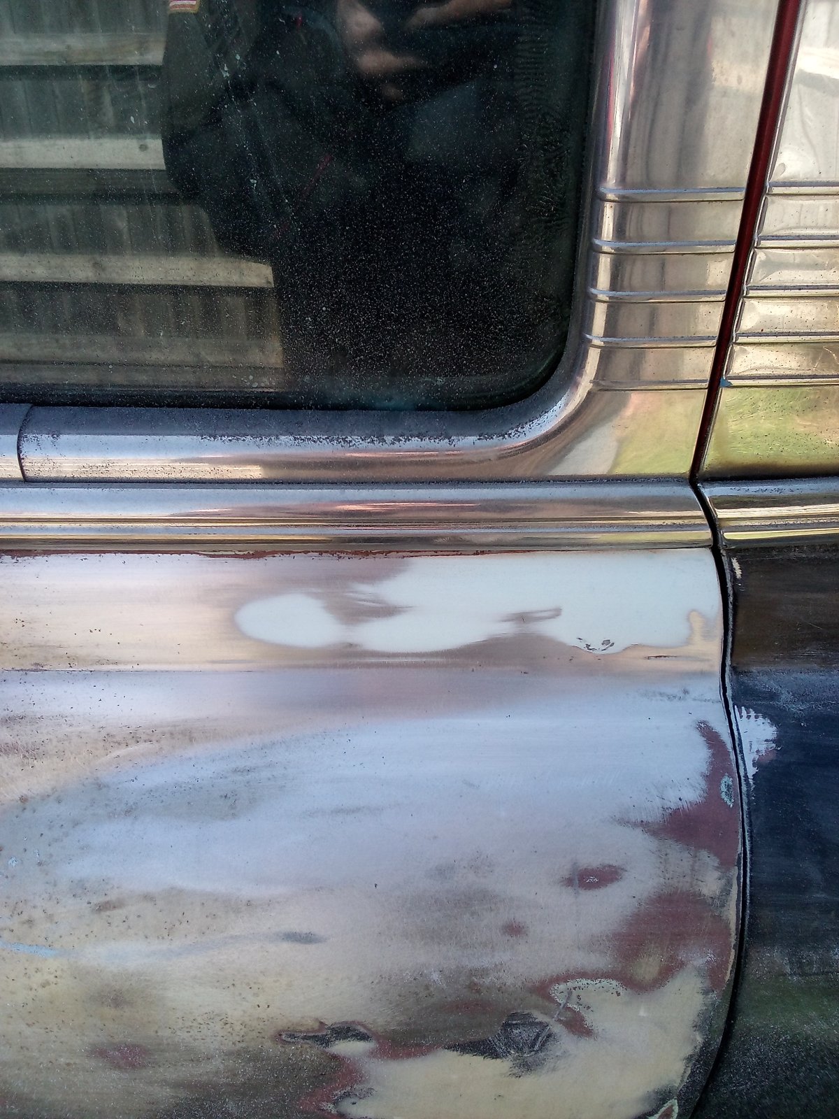

  21. And because the screws on the bottom hinges were stuck solid I decided to try using panel bond to shave the rear doors handles too since I couldn't just take the rear doors to work to weld them up. Ill scuff and put another layer down tomorrow before sanding and hitting with glazing putty IMG_2024-03-06-17-41-13-420.jpg IMG_2024-03-06-18-17-45-047.jpg

  22. Id hoped to be prepping for primer today but the weather this week went against what the weatherman said and my car lives outside lol. So I'm just now getting the last layer of panel bond over the holes. Threw some tape over it to help sort of keep it's shape as it was trying to run from the angle IMG_2024-03-09-10-46-01-568.jpg

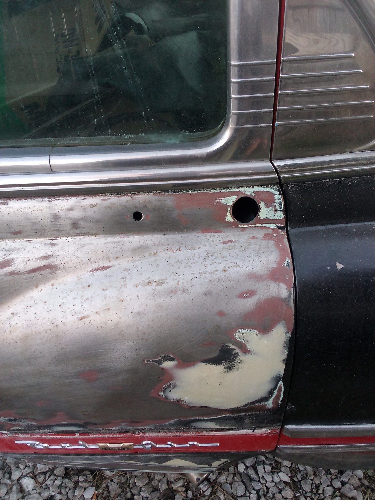

  23. And the first rear door handle shaved. Glazing putty is currently drying on the other side IMG_2024-03-10-13-04-42-122.jpg

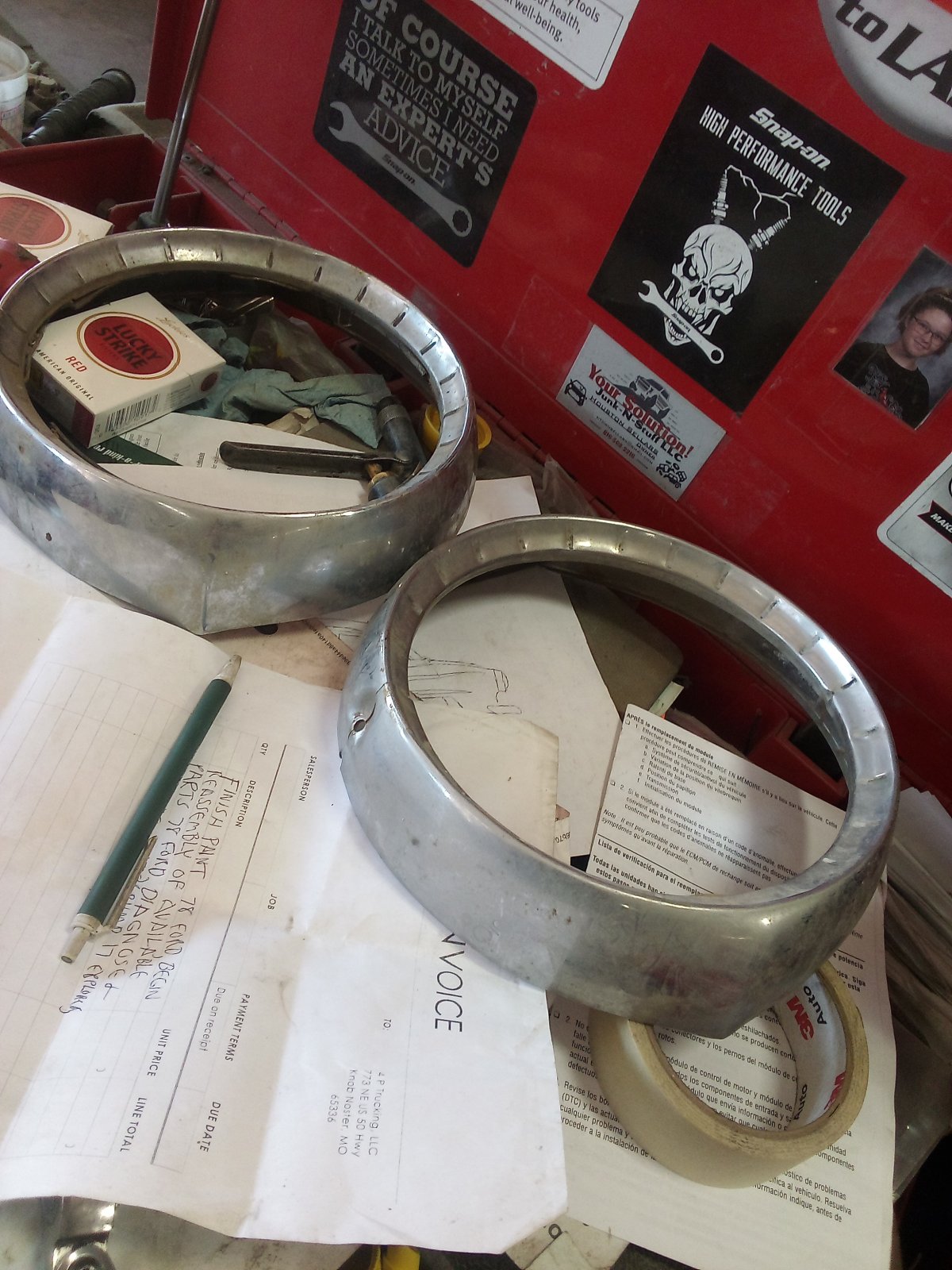

  24. And finally got a replacement 54 headlight bezel to replace the one I lost a year ago when I hauled the car to the shop so I could install the engine IMG_2024-03-11-16-13-42-894.jpg
    Okie Pete and Tim like this.
  25. Now that i got a replacement 54 headlight bezel on I feel a lil less self conscious above the front end. And thanks to buying a pair of them today and an oddball on eBay last week I have a spare set so I won't have this problem again. Soon I'll send and paint the grill with some nason bmw bright aluminum paint I have for now till I get replacement chrome stuff. Still need to get tue nice chrome bumper center piece on that I have IMG_2024-03-11-17-57-56-355.jpg

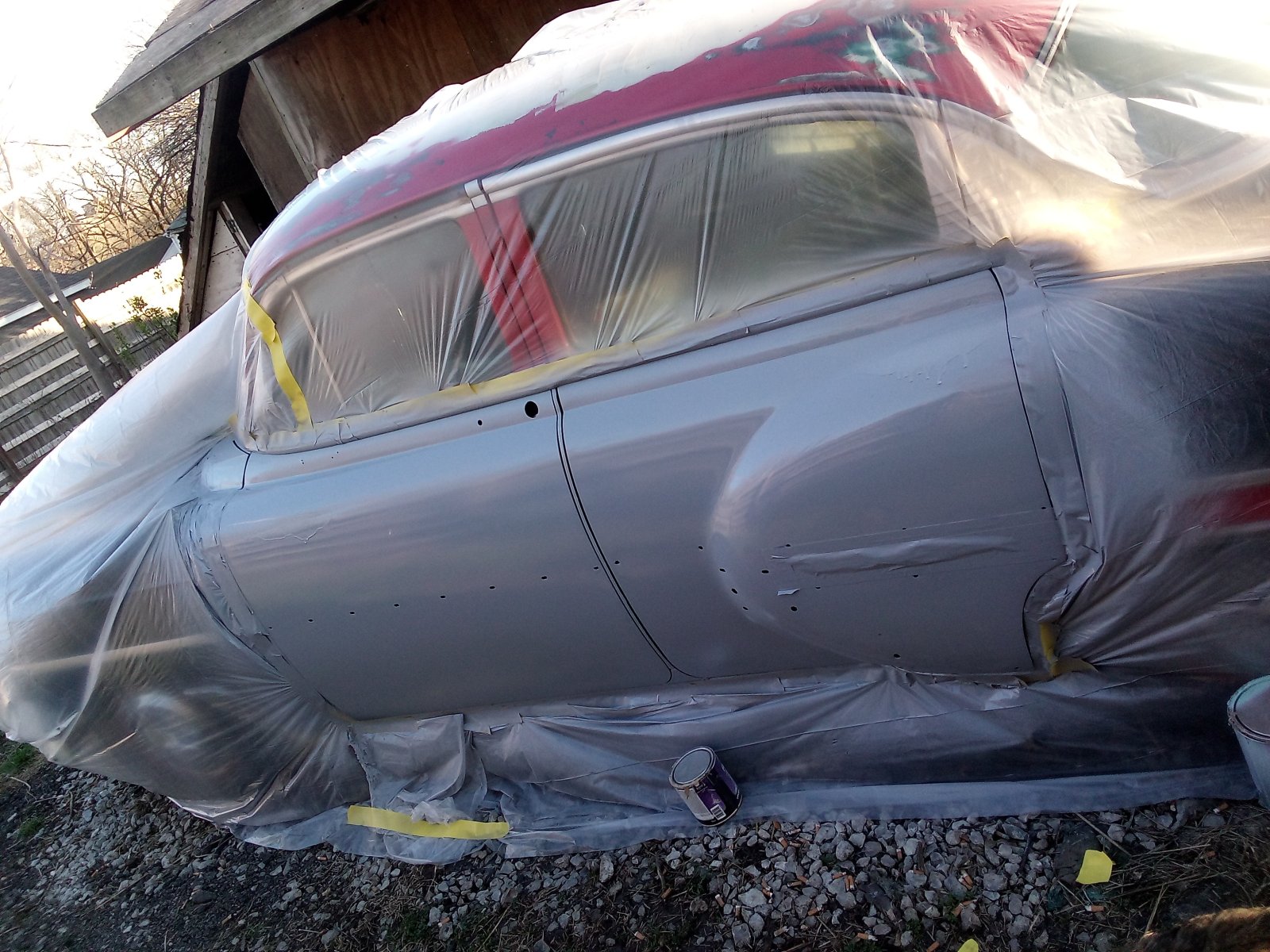

  26. And two more panels ready to be cleaned and primed. May just prime and paint these two doors before hopping back on the quarters IMG_2024-03-14-19-17-44-482.jpg
    Tim, 61Cruiser and Okie Pete like this.
  27. And tonight's goal met. I'll let dry overnight and wet sand in the morning and paint tomorrow afternoon hopefully. Going to leave it masked aside from Bel Air insert to save time. Figure I'll start back in on prepping p***enger doors for prime and paint Sunday. Then after all four doors are done I'll move back to the rear quarters and splash pan IMG_2024-03-15-18-12-35-180.jpg

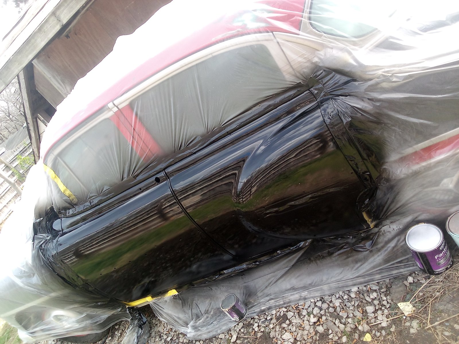

  28. And doors in paint. Only a couple pieces of trash in paint I can't live with but they'll be easy enough to polish out. I'll get the trim on tomorrow and start back in on the p***enger doors. Figure I'll prime p***enger doors Tuesday and paint Wednesday IMG_2024-03-16-15-08-09-681.jpg IMG_2024-03-16-15-17-40-528.jpg
