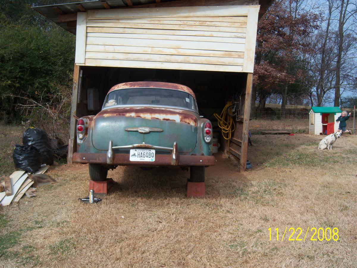

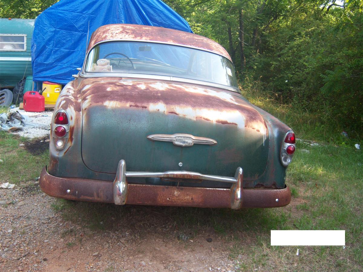

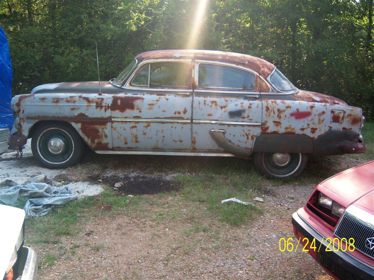

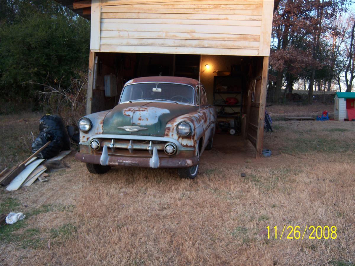

    I would like to chop my 1953 chevy 210 4 door
    the car is all stock and this is the only mod i
    would like to do to it i need to hear form the old time
    hot roders they seem to know a lot more than most i would like ​
    to do about a 5 inch chop but could i go more than that
    or if i go more than that would it be to much anb what is
    the best way to do this thing and were would i need to start
    i need lots of info
    thanks buggmann
    i put pics of my car up the last one or two
    are what i would like the car to look like when done:cool:

    i have not choped it yet the last two pics were done
    on the computer i was not sure if a 5 inch chop would
    be to much

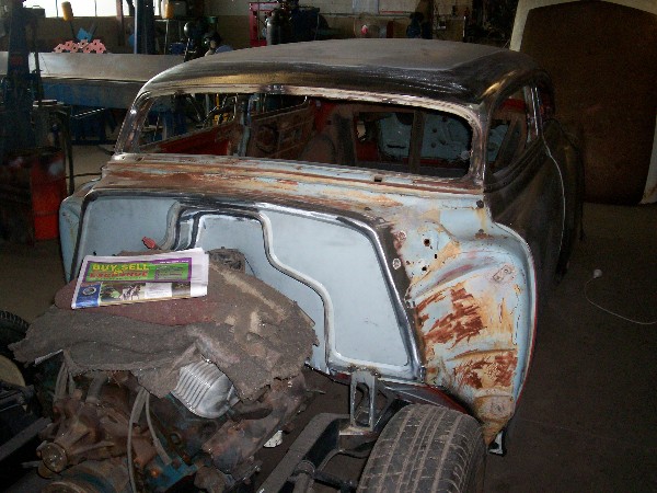

    4 at the most ,I think any more ,then things are just not in proportion,this 2 door was done 6 inches at the owners request as he already had a cut down screen to go!
    Also ya wanna keep some shape in the roof,eg , not flat looking, a 54 Nash roof was used on this,
    Even at 6 inches ,visability out the front is not the best'
