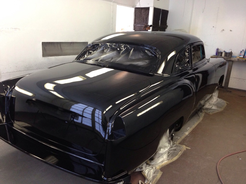

  18. mattcan53
    Joined: Feb 2, 2005
    Posts: 62
    mattcan53
    IMG_1399.jpg IMG_3122.jpg IMG_0890.jpg IMG_0603.jpg I've recently moved to SF so it's taken a while for me to get my ducks all back in a row. Lucked out in renting half of a homies 1500sqft shop up here. some of you might know him and his chopped hard topped 41merc.
    My chevy is still in Dago at Mike D of the Majestics paintshop.
    After 10 years of trying to pick a color, i ended up saying ****it and just going all piano black. Heres some progress pics of the frame

  30. mattcan53
    Joined: Feb 2, 2005
    Posts: 62
    mattcan53
    ... IMG_7877.JPG IMG_7824.JPG IMG_7869.JPG IMG_7863.JPG IMG_7848.JPG IMG_7856.JPG IMG_7844.JPG IMG_7847.JPG
