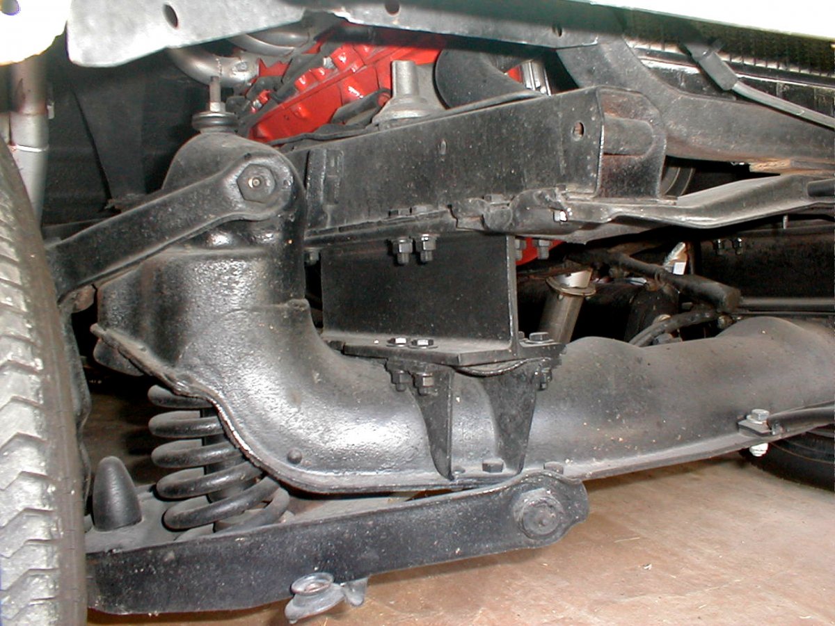

    4" I beam drilled to fit. Very easy to do and cheap. Drove just like normal at 80 mph+. I think all I did was adjust the drag link longer when it dropped down.

    real safe looking right ?

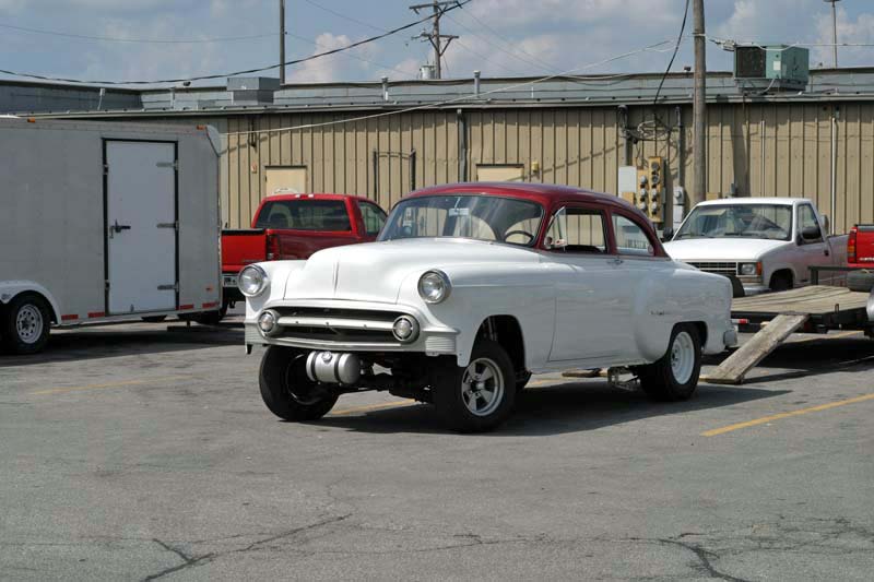

    I don't see a safety concern here. Maybe weld a plate on each end for lateral movement but that would be it. Can you do 4 or 5 inches without any modifications? I dont want to build a hiway cruiser, something to run around town is what I am looking for.

    Lol, the I beam version above definitely does not look to safe. You pound on them enough, it will flex, then hopefully only skew one way or the other. Kinda like a lopsided I.

    Those I-beams are industrial steel. Maybe IF they were cut to length using an O/A cutting torch, and heat damaging the structure of the steel, it "might" be unsafe. I've seen them used before, but it looks "out-of-place" (JMO). When the nephew and I raised the 51 Chevrolet Business Coupe, we used 16 longer grade 8 bolts, nuts, and washers, along with some 2 inch spacers to go between the frame and suspension crossmember. Then I side welded in an extra side support plate. Looked better than an I-beam; but I'm sure both methods were plenty strong. Still sorry I sold the 51 Bus Coupe a year ago.

    Butch I agree, they Structural steel, but with a
    .188" web thickness and a sideways load, as built,they will in time fail. Now had he put some flange to flange gussets at the pick up points , that would be a different story.i wouldn't 'expect' it to fail at all. I also agree, it does look out of place, in my opinion I beam, h beam, channel iron, just does not belong on a hotrod.
