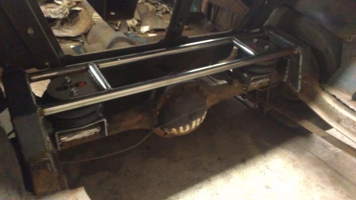

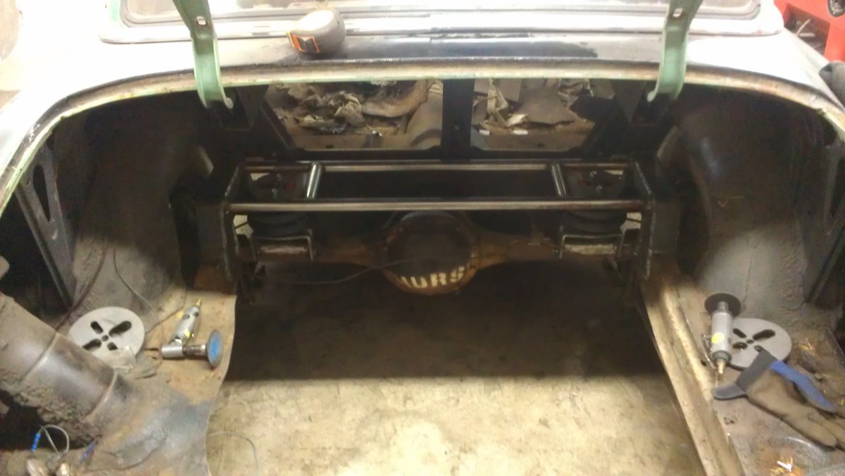

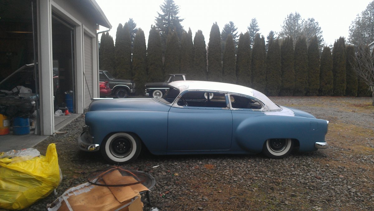

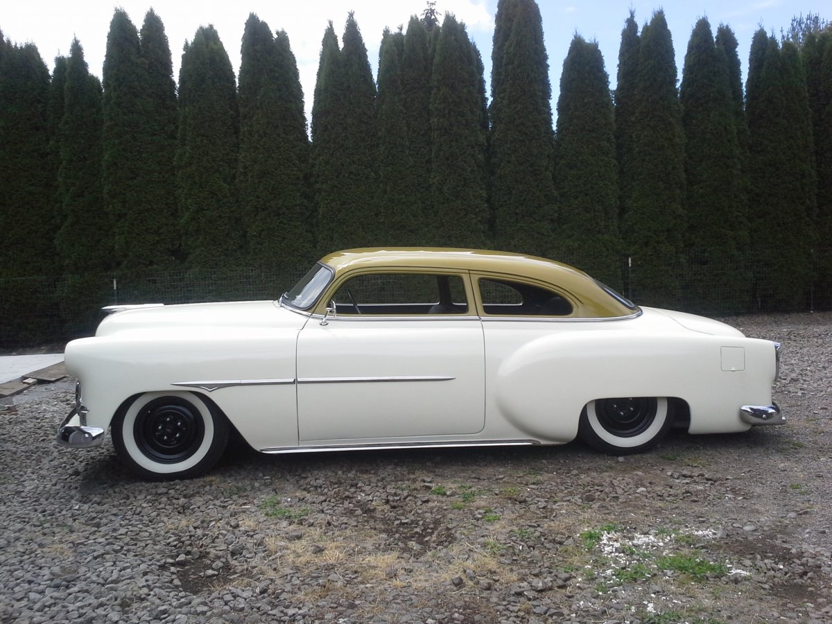

    In the pictures where car is blue does that have the four link rear end or is that still on the lowering block and three leaves with the bag over the axle? Also do you have any pics of the rear end. I've just bought a 53 and I wasn't going to chop it but after seeing your mild chop I'm thinking about a chop
    taildragger1957 likes this.
  16. taildragger1957
    Joined: Mar 18, 2009
    Posts: 160
    taildragger1957
    Thank you. I believe the blue pic you must be talking about is the mid chop picture? If so, that was after the 4 link. Though, I think it is pretty close to the same height as the leaf setup. Maybe a 1/2 or 3/4 inch lower with the 4 link.
    Here is a picture of it with the old leaf setup, right before i did the 4 link and pulled the motor out to do the engine and trans swap.
    And here is a similar angle of the car now. I have 15's on it now. I was running 14's before. So the wheel/tire combo makes it look different too. But just to use as a comparison.
    And here are the only pictures i could dig up of the rearend setup. When i built this setup. I was already planning on doing the 4 link the following winter. So i set it up like it should be for that. It actually rode great with air in the bags. But got a little growly in the torque tube if i tried to drive aired out. Anyhow, hopefully it answers your question. Good luck with yours.
    (oh and my buddy who owned it before i did was good friends with cody at Hurst racing tires, which explains the hurst stencil on the rearend. Im sure someone will mention it. Lol.)

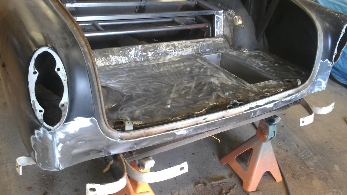

    and one with the trunk somewhat back together.

    So you were able to retain the stock fuel tank and location with the air ride set up?
    Sent from my SM-G930V using The H.A.M.B. mobile app
  19. taildragger1957
    Posts: 160
    taildragger1957
    I had to rebuild the floor back there. But the stock gas tank (Repop new tank) went back in the same spot it was before.
    Couped_Up likes this.
  20. Couped_Up
    Joined: Dec 26, 2011
    Posts: 17
    Couped_Up
    from Ocala, FL
    Does it sit higher than the original location? Basically what I'm curious about, does the tank hit the ground when you're aired out? I'd like to retain the original gas tank location if possible when I add air ride to 54 hardtop.
  21. taildragger1957
    Posts: 160
    taildragger1957
    Its roughly in the stock location up and down (might be a 1/4 inch higher or lower depending on how good i am at rebuilding trunk floors. lol) Its definitely the lowest thing back there. But my car doesn't lay all the way out. That being said. I drive it real low everywhere and have never clipped it on anything.

    What blue was that on the car before the repaint? Been looking for a satin blue like that.
