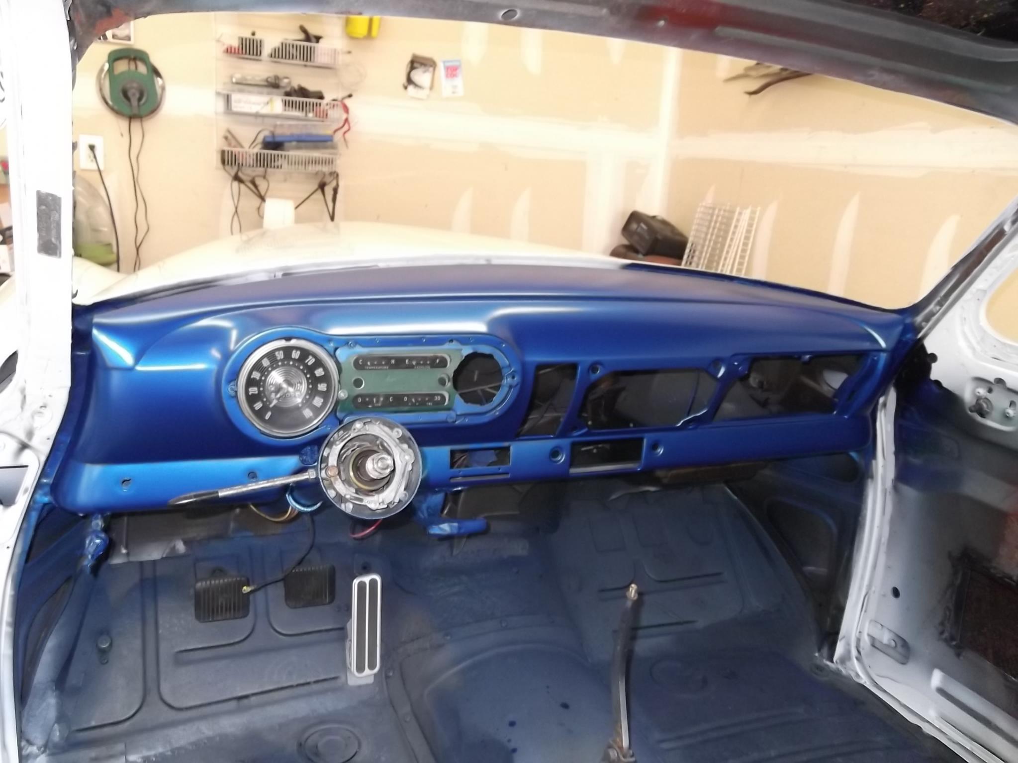

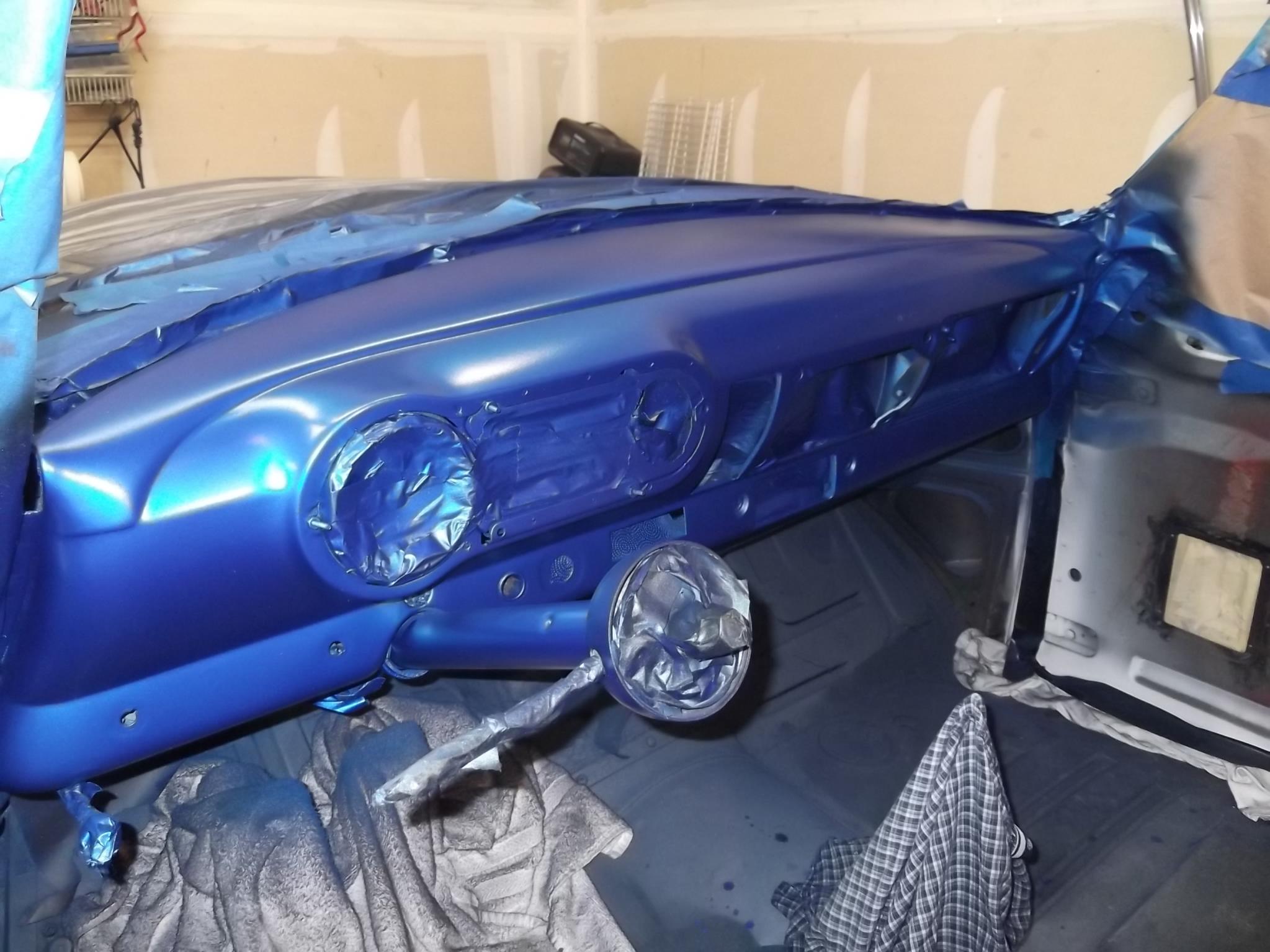

    Got the dash painted

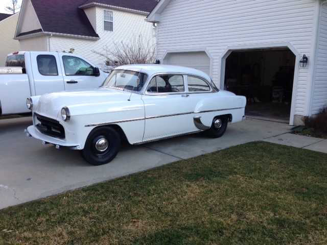

    weather was nice today took her out for a blast and snapped a few shots.My daughter Loves it! As soon as i fire it up she comes running!

    Love it! I agree on the color scheme decisions, very hard!! Im thinking white on my car as well.

    Looks great I like the white & blue

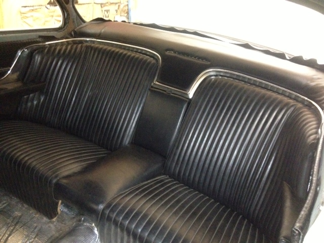

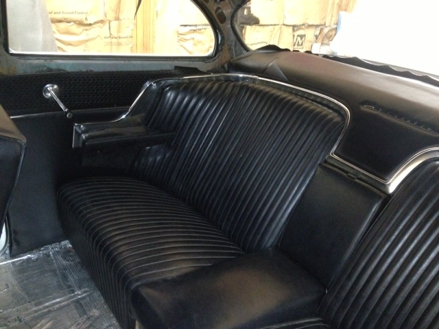

    scored some cool back seats!i think they were out of a thunderbird I just set them in there to see how they look. they fit pretty good should only take minor alterations.

    Making progress on the tbird back seats

    put the dash back together wanted a tach so this is what I came up with.I think its pretty cool .when you look in from the window at first glance it looks like the original clock.

    Damn, those T-Bird seats look like they grew there. Excellent work.

    The Tbird rear seat is *****in! Great idea

    Thanks guys,A buddy of mine had the seats stashed away for years they are in great condition .He decided he was probable never going to get around to use them so they were donated to the cause.

    What year T Bird supplied those seats? People are going to start gutting them, then go looking for a 53-54 Chevy, you've started a trend. Bob

    The seats are out of an early 60s Tbird . The only challenge to making them fit is the back shelf I trimmed It and added a piece to the back Not to big of a deal. My buddy told me the Merc guys use these seats a lot. when I first decided to use them I ran a search.THeres a couple other Hambers who did the same thing.Alot of good info.I was thinking abot using the center console also but decided against it . I like the way the Corvair buckets look with out it.

    any close UPS of the rear decklid installed and during the fab? Just picked a rear 65 seat myself and was looking for pics. Car is looking good!
  26. Johnnymurt69
    Joined: Oct 4, 2009
    Posts: 105
    Johnnymurt69
    Sorry man no pics.I just dove in and started cutting. The deck lid is three pieces the outer ones needed minimal t*******.I used the stock card board deck for a pattern to fill in the back of the shelf I had to bend the seat backs a hair.Fabed up a couple brackets and had to trim the garnish moldings ( you can see them in the pics) And that's pretty much it. I couldn't believe how nice they fit.
