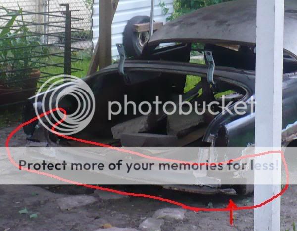

  12. skyrodder
    Joined: May 7, 2005
    Posts: 1,925
    skyrodder
    I know, I know, i am going to have do alot of work on the back lower half... but here is how I did the Rear.. and if you do it.. trust me your going to want to use a plasma cutter for the inner structure in the trunk area... you can use a sawzall but you will need at a **** load of blades, because they will break with all the vibration.. I did a 4 inch section on it, but the wheel wells have a lip at the top that i had to cut off , so now the top outer part of the quarter panels are literally sitting on top of the wheel wells

  14. new wave terror
    Joined: Sep 4, 2004
    Posts: 121
    new wave terror
    Wow,thanks for all the help and pics guys.I understand a little more now.This should be a good long project haha.I will keep all updated.Love the work area skyrodder,as Im basically working with the same thing until I get a shop up.
