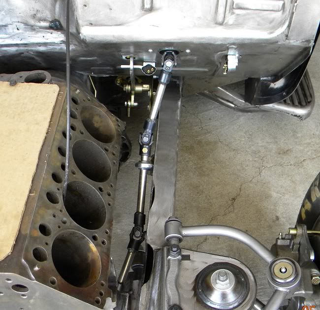

    The u-joint that is installed on the rack&P is big and hits the crossmember.
    I have to learn how to do, whether to buy another u-joint or ...... I do not know :)

    I bought those same SS ujoints and had to return them. I didn't realize how huge they really are.

    Exact Nicolas. I never imagined there were so big :eek:.
    The rack&pinion should I install a joint 9/16-26 x 3/4"DD,
    you have the same joint? What have you installed?
    Also the U-joint which is to be connected to the column is enormous.
    I was surprised when I saw it and then
    I understood why they cost so much :)
    Thanks for you time
    Frank

    I replaced them with weld on joints. They are much smaller. I also went with just a coupler on the rack instead of a ujoint. If you have three joints like me, you need a support bearing as close as possible to the middle ujoint.

    Yes Nicolas,
    I have three joints and I've also bought the bearing.
    The system we've adopted you might be a good solution for me and thank you for having recommended to install as close to the middle u-joint.

    This would be perfect for me ..... but where can I find and what's his name?

    I used a Sweet Mfg. 9/16"-26 to 3/4 round non-flex coupler. Othe companies make them too. They come in different configurations.
