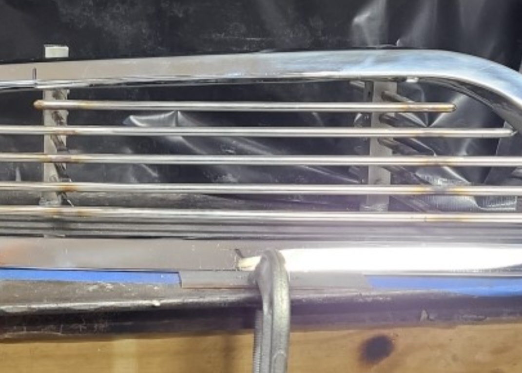

    After going nuts about my nuts, I decided to detour around the sanding of magic mud for a few days.

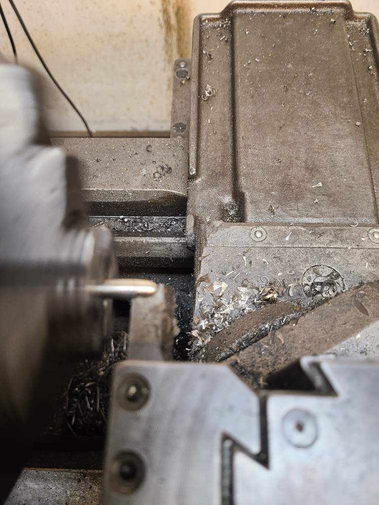

    Instead, I am focused on the custom grill inserts I previously drew up in CAD. So first, I made the individual 1/4" stainless rods of pre-determined lengths. Using my buddy's lathe, I ground a tool to match the bullet-tip ends I envisioned, cut them to the calculated lengths, and banged the ends against a plastic surface on the floor so that they curved to fit the curvature of the grill surround:

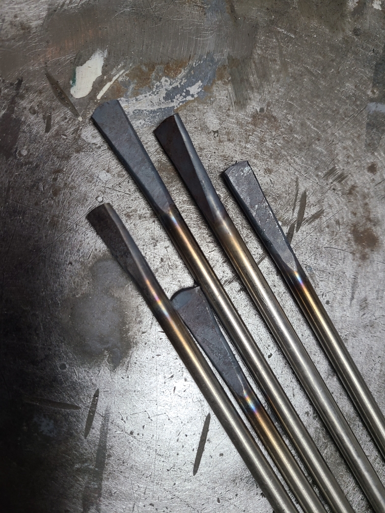

    Next I made the rods that get welded behind the grille bars and are positioned in three vertical stands with holes on 0.600" centers. I flattened the ends by heating and hammering to 1/8" thick at the ends:

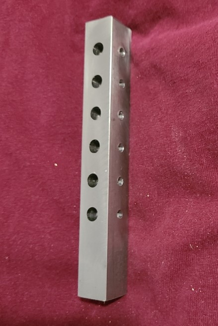

    Then I machined the stands out of 5/8" square stainless bar in the mill. Nice that the spacing of 0.600" holes was an even 3 turns of the cross travel on the mill! The side holes are drilled and tapped for 8-32 set screws, and the tops and bottoms are drilled and tapped for 1/4-28 NF mounting bolts or studs.

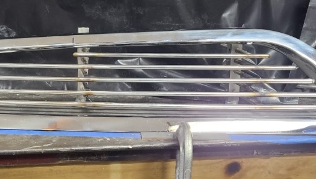

    So I set it up on my bench with the grille surround registered in place and built what I thin came out pretty COOL (The location of the turn signal will be determined when I get it on the car. I'm going to paint all stuff in the background flat black. It ended up that I used five rows of bars, rather than six, so the upper bar lengths had to be modified via another trip to the lathe.
    Whaddayathink?

    Love this project and the grill design looks good. It could b the lighting or the angle but the top bar looks crooked.
    To me it looks like the top bar is lower on the right. Also if you keep the blinker in the current position it might look good if you extended the top bar to fill that space up.
    Just a suggestion. You do great work and I trust your eye.
    Hillbilly Werewolf and SS327 like this.
  6. Irishjr
    Joined: Jun 8, 2004
    Posts: 478
    Irishjr
    I tried to keep the "border" distance about equal all around the perimeter, so I had to shorten the top bar to make that happen. Here's a pic of it without the turns signal:
    I think it's an optical illusion caused by the very shallow slope along the top of the surround, kinda like what we used to call the three-pronged flux-sucking shunt :confused:
    When I get the assembly mounted on the car, I will be able to play with the exact location and even tweak the bars somewhat. As to the location of the turn signal, I want to play with it by burying it back in the cavity with power to it, to see how its visibility works, and how it is least visible when not powered up.

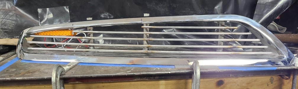

    I have progressed to the point of 90% completed the passenger side grille installation on the car. I painted the mounting "posts" and horizontal rods behind the polished face rods with flat black, which I will also do to the housings on the front clip (eventually).
    I also fabricated brackets for the amber parking/turn lights to mount to the back face inside, about 4"-5" behind the rods:
    I was concerned that the flashing lights might not be sufficiently visible, so I hooked up a battery and:
    https://www.youtube.com/shorts/wjk07ArvuWY
    Looks more visible than I thought it would. I'm satisfied.

    I wondered to myself how visible they are from a POV not straight on, as in your image. Not so much after dark, where the light and flashing should be visible to someone at 90 degrees to you, but with the 4"+ deep recess, I wonder if it would be better to move them forward and allow them to be more visible with less shrouding, so to speak.

    I also was curious about the visibility, being that LEDs are very directional. That's why I was impressed that the stainless bars helped to disperse the light in other directions. Did you watch the video url I included in post #278?
    Here it is again:
    I also think that the UP 36446, being embedded in plastic that also diffuses the light, helps to "magnify" the effective visible area.
