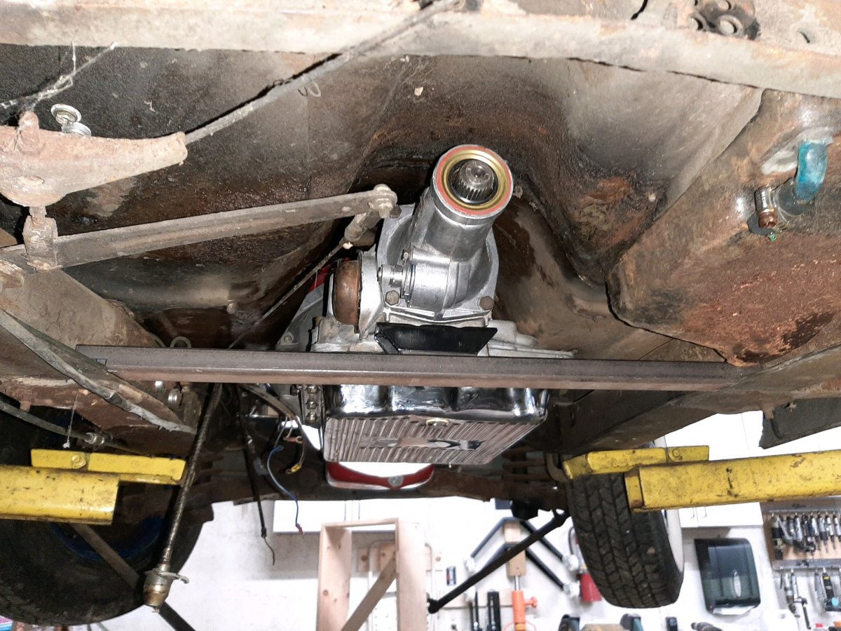

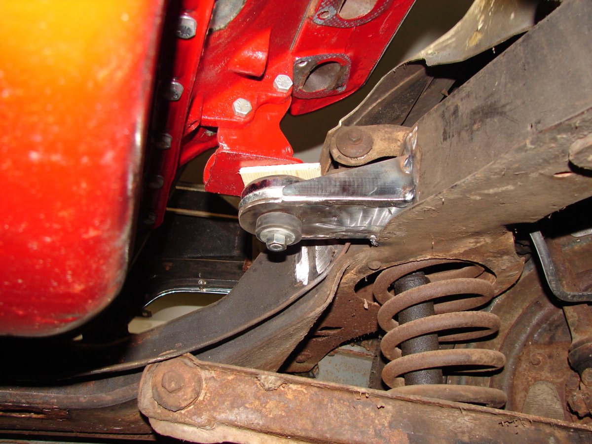

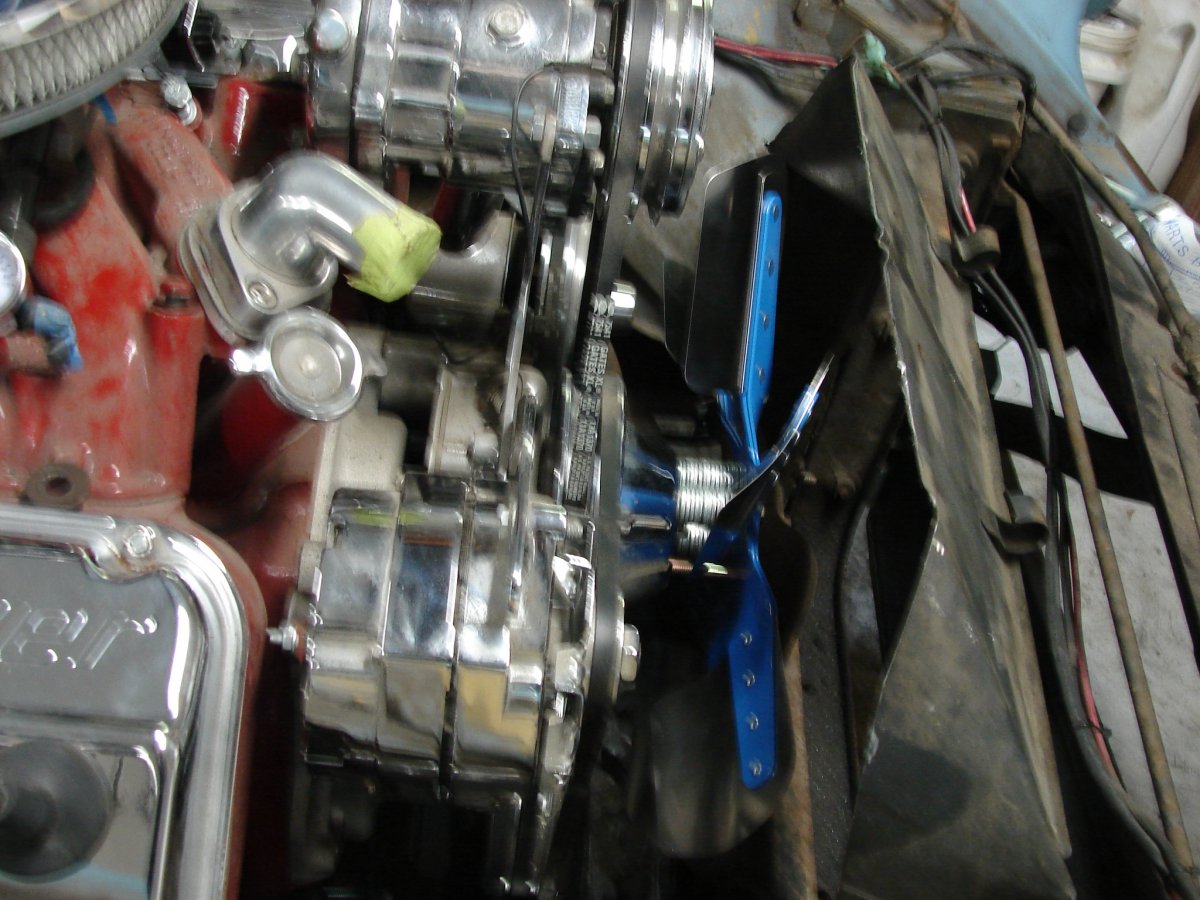

    Working on the motor and transmission mounts. Just worked out that I can do almost all from below:
    Temporary ****** mount. I will be making it easily removable, but for now it is holding up the back end just fine.
    Start of the motor mounts. I have left room for adding or removing shims. right now the crank pulley rests on the crossmember, but I will be notching about an inch for clearance for belt R/R.
    One thing really worked out slick. Here is access to the oil filter thru the wheel housing:

    ****** mount tacked in place:
    I am amazed at the plentiful clearance under the tunnel.

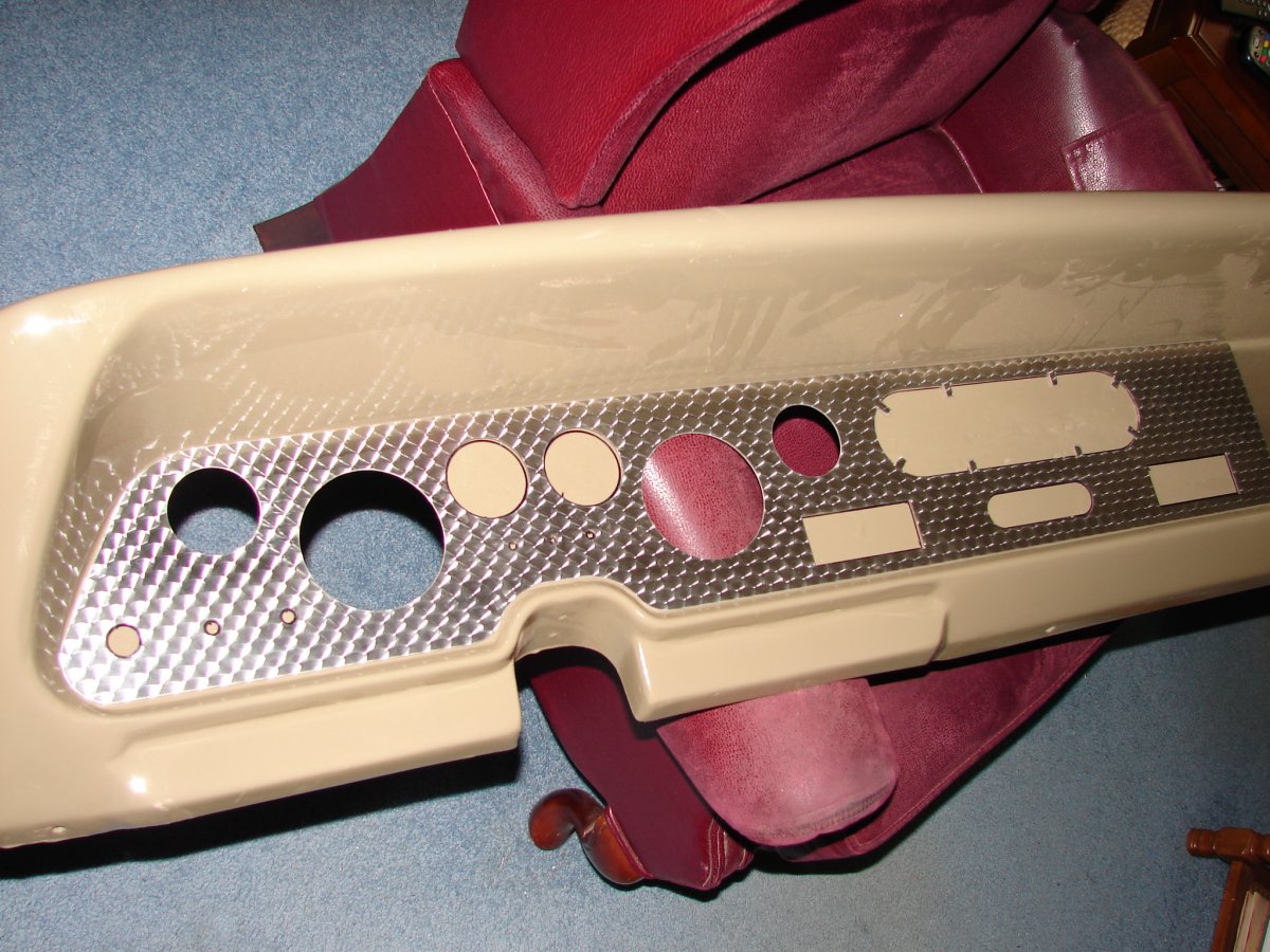

    I am temporarily changing gears.
    My next step is to install the new steering column. Since I am changing to a 700R4, I need to have a column shifter, so I bought a tilt column and a N.O.S. 1967 Chrysler steering wheel and horn ring with Chrysler horn ****on (more on that later). I also am changing to a Hawk dash, which I bought on ebay:
    The '53 dash will not hide the A/C unit and the Hawk dash will (more on that later). So I need to install the Hawk dash and make sure the column is securely mounted to the structure of the car.
    Well, in preparation for the Hawk dash, for which I received new gauges from my wife last Christmas, I wanted to customize the dash. I am moving the position of the gauges and putting a new radio hidden behind a fake AM radio, plus adding A/C outlets. So I made a setup to do an engine-turned stainless steel insert with a bead rolled around the perimeter that mimics the Hawk panel.
    I started a thread last March that I am sending you to to explain the process and show you where I am in completing it:
    https://www.jalopyjournal.com/forum...-and-bead-rolling-a-hawk-dash-insert.1188233/
    Check it out and c'mon back here.

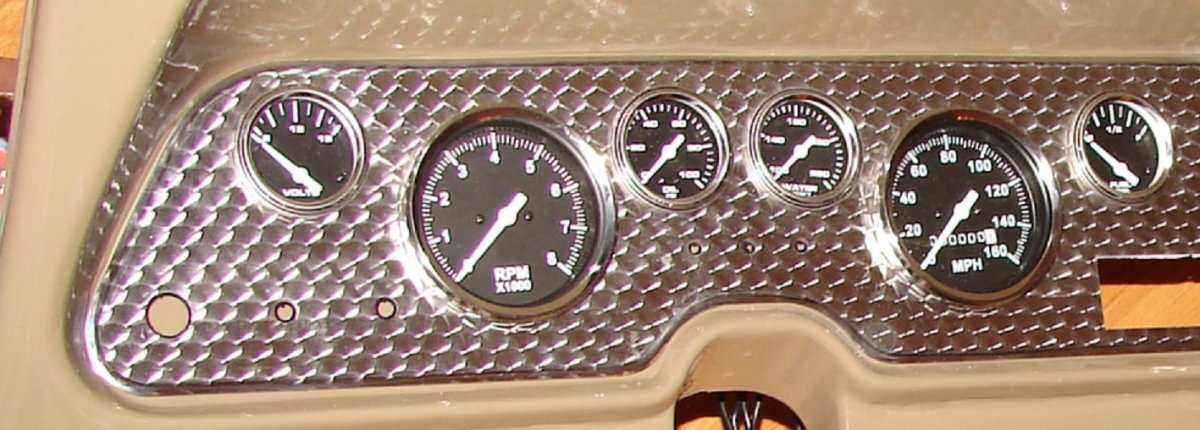

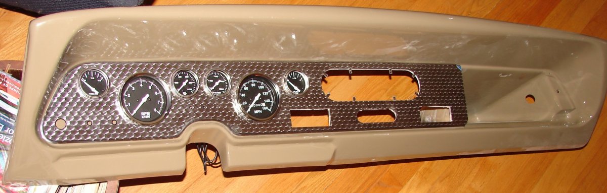

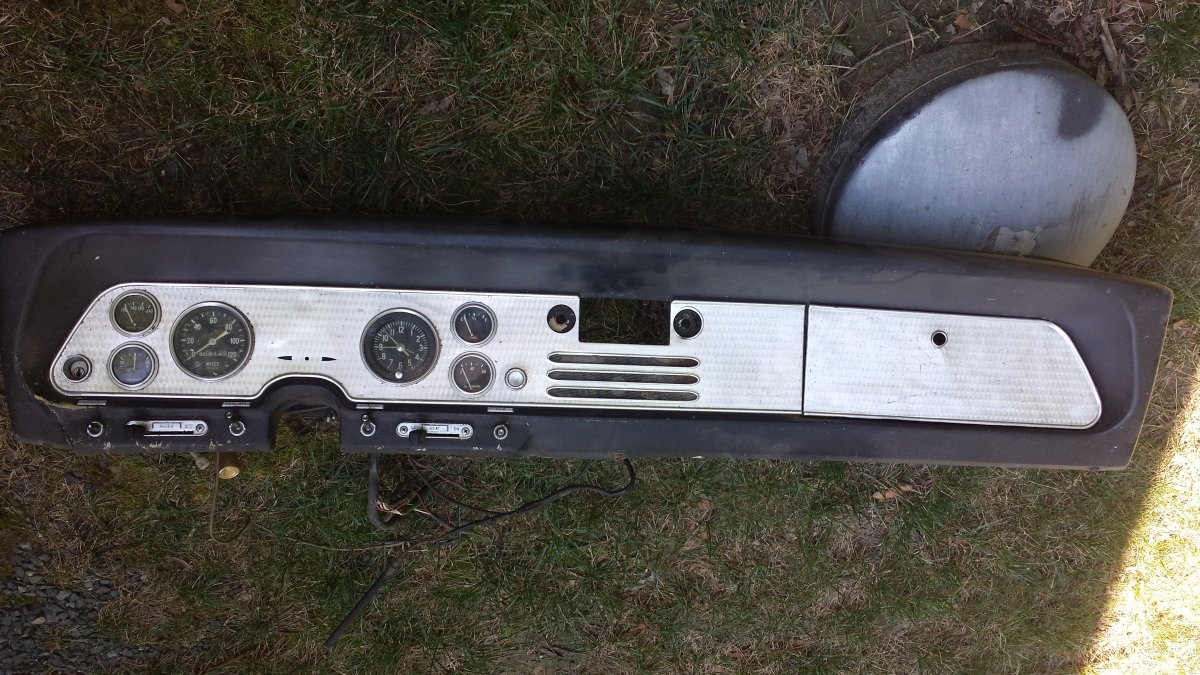

    So today, I finished the engine turning on the waterjet cut stainless sheet and tried the fit in the Hawk dash:
    It fits! Now to roll the bead around the edge, cut the holes for the new locations of pieces parts, and install it so I can fit the steering column.
    Abut the color of the dash....I have had 9 hides hanging on a roll in my wood shop that I bought from Jalopyrama Mike Szuba a number of years ago. So I already know the color of the interior. The dash color is complementary to the leather.
  24. Irishjr

    I finished out the engine turning thread with these pics:
    Feelin' good about the dash. Now to put it in the car and mount the steering column.

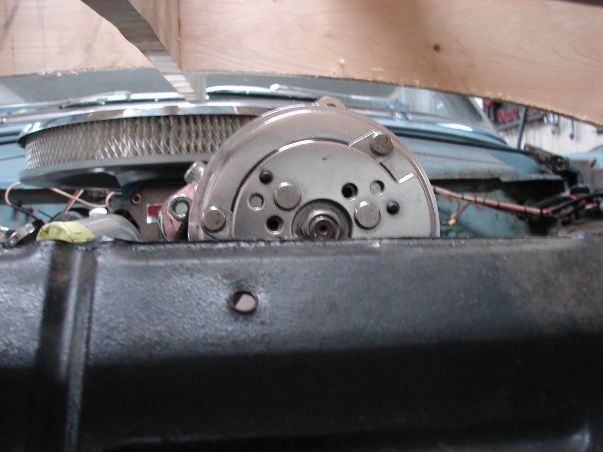

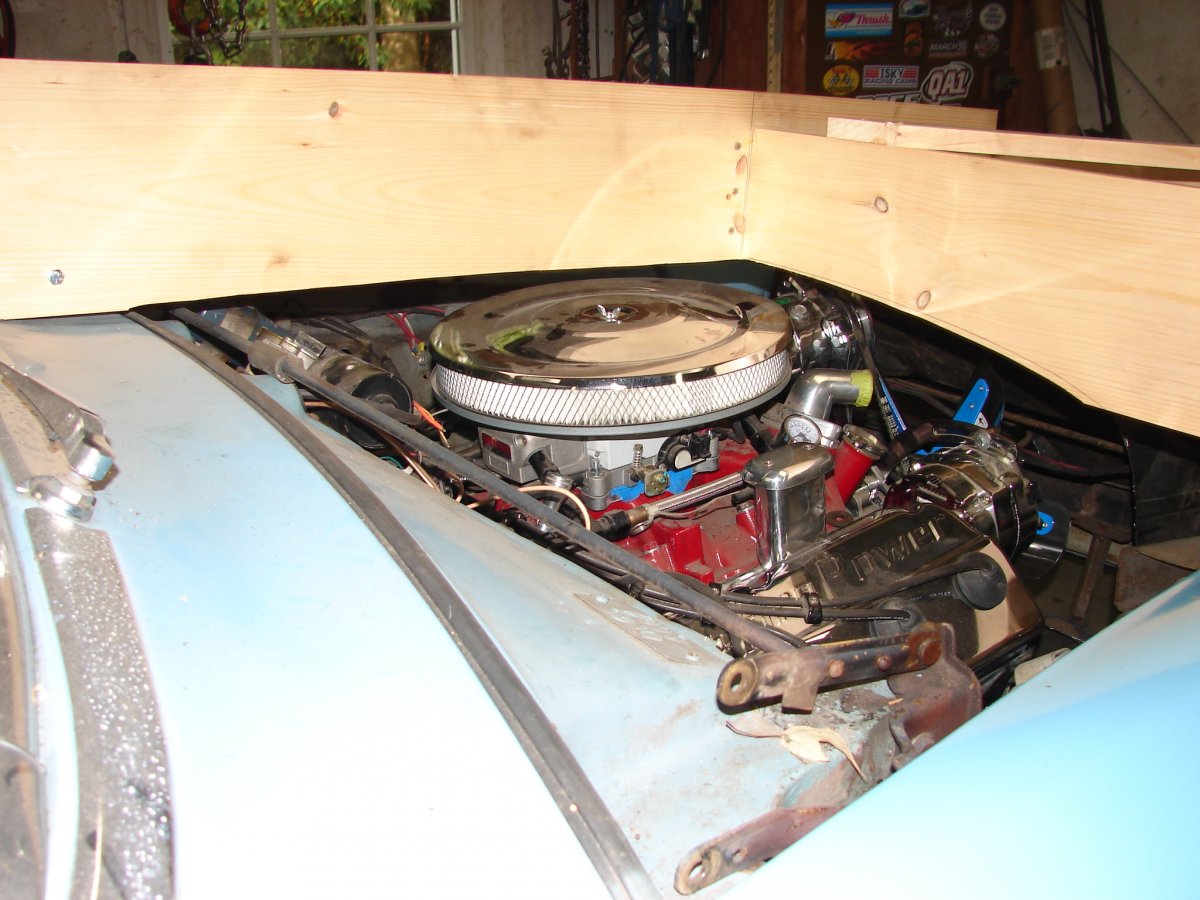

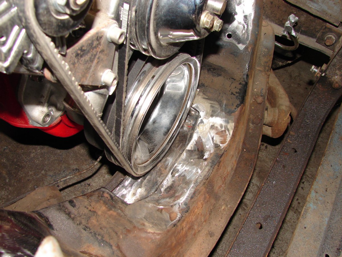

    I removed the Hemi and notched the crossmember. Cut down a ways, so I rebuilt the pocket with 3/16" plate. I welded the engine mounts most of the way, but still may reinforce them more, especially if the rack & pinion mount will be mounted off the bottom of the mounts. I appears that that will be a good spot.
    Today I also temporarily mounted the fan blade with stacked washers to determine how much of a spacer I will need (1-1/2") and cut the fan shroud apart to start reconstructing it with the correct configuration for the lowered height of the engine.
    Now I have even more clearance with the hood:

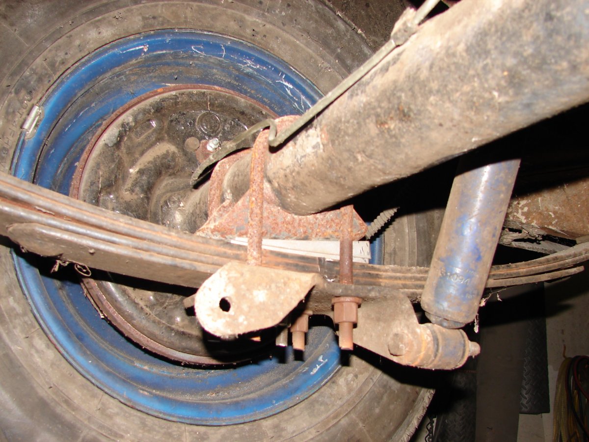

    Aligned the third member pinion by adding tapered shims. I had installed the 2.73:1 Ford 8.8 rear a few years ago and welded on the spring pads at the same angle as the Stude had it. Amazingly, no other mods were required. Now that I am putting the Hemi at a reasonable angle, and am using a 1-piece driveshaft, I had to use 7-degrees of shim to bring it parallel with the engine/transmission. The Stude driveshaft was actually done with the pinion pointed down about 3-4 degrees!

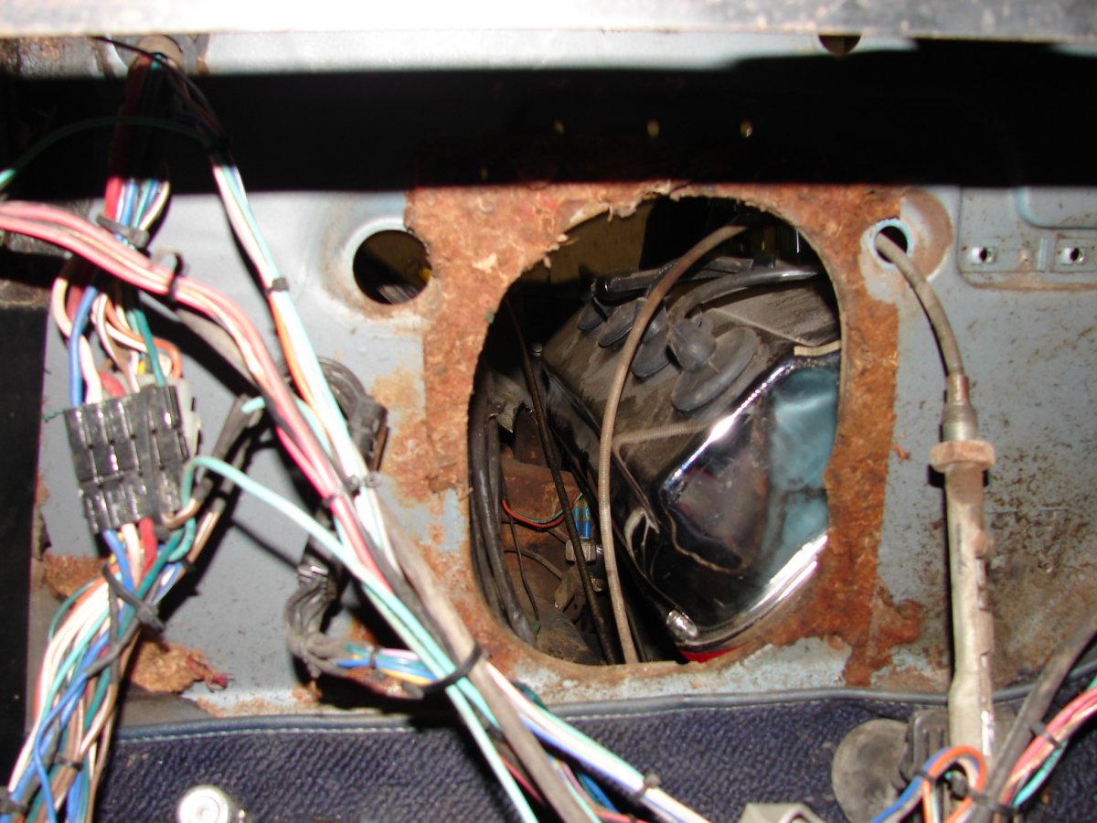

    Feeding the steering shaft through that big hole in the firewall looked easy....but NO!
    I am now in the middle of shortening the steering column. More about that later......

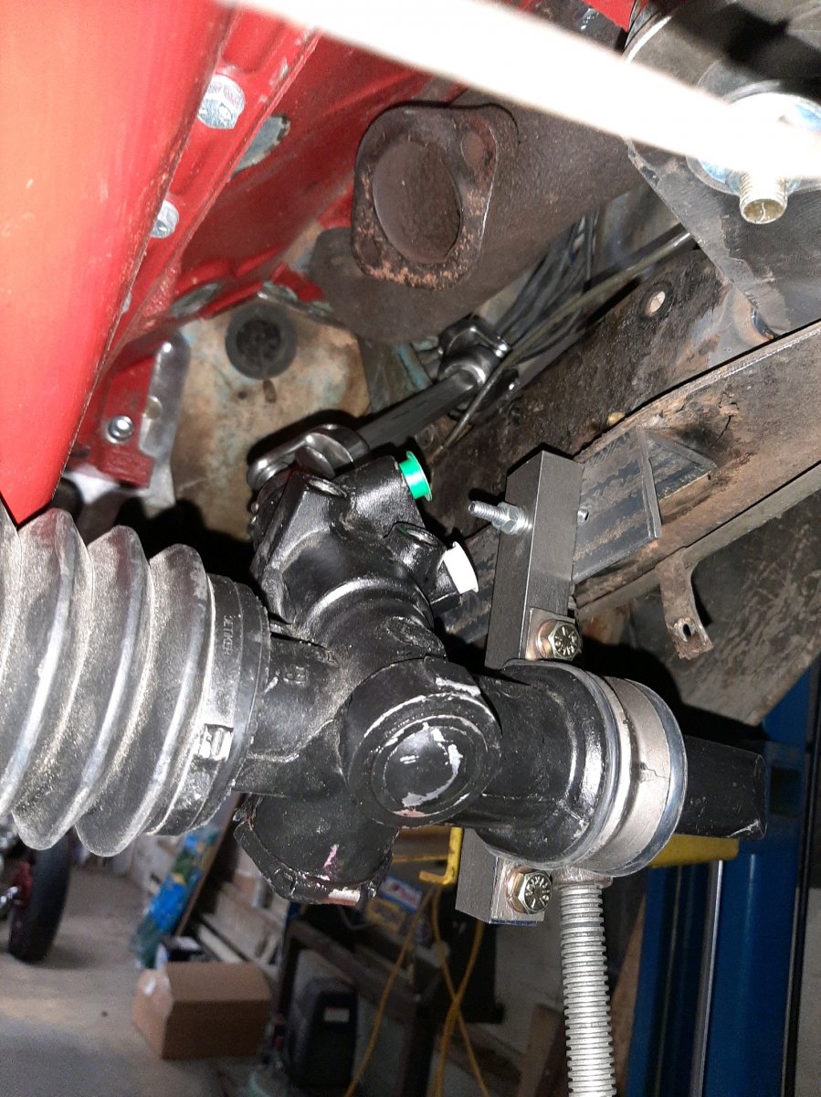

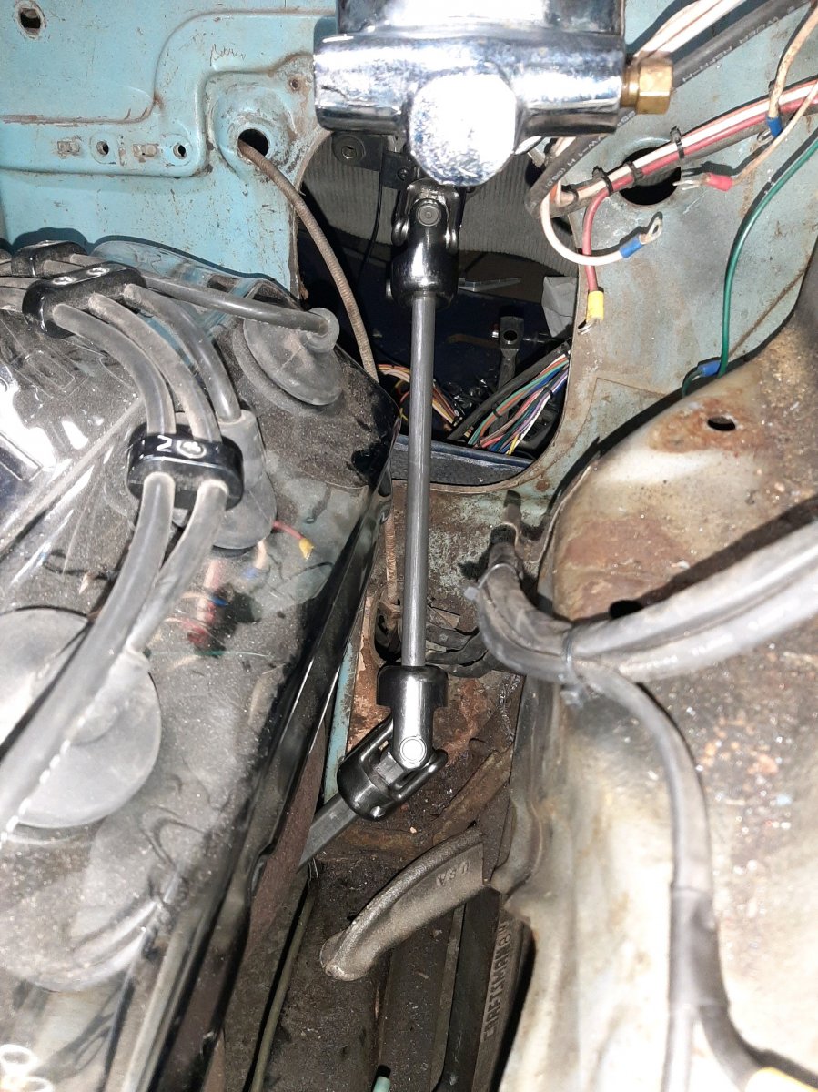

    Those damn Hemis are so wide! So I had to do the radical thing. I shortened the steering column sufficiently to move the top U-joint behind the firewall and will be using three u-joints to get down to the R&P steering. I did this same type of installation on 40 COOP, when, in 2010, I channeled the car. I used a 3-on-the-tree old Ford truck column that I modified to put a cable shifter ***embly of my own making behind the firewall. This was to get to the Camaro gearbox on a '69 subframe that I installed on the first major mods of the '40 in 1979! This time, the challenges were a bit different, but the clearing of a Hemi was similar.
    The aftermarket steering column, with shifter, but no key, was a new learning experience once I got into it. After getting it apart with difficulty, as it is different from a stock GM tilt column, I found that it was actually simpler to put back together than the GM. The compressing of the spring was done after it was fully ***embled using only a simple screwdriver. But that's a differnt story...
    I had previously adapted a 1967 NOS Chrysler steering wheel to the column, and really think it will work great on 53 COOP. Note that I bought a Lokar cable shifter kit that clamps on the column, but we'll see how that fits with the brake pedal, etc. So you can see how stubby the column now looks:

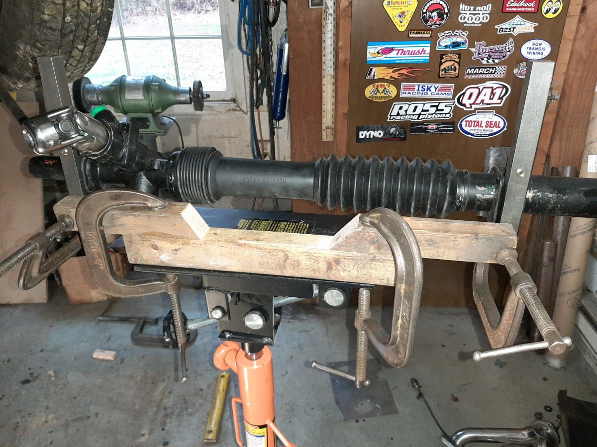

    Down on the bottom end, I needed to find room for the R&P that cleared the pan, cleared the tie rods, and allowed the steering shaft to clear the Hemi. First I discovered that I needed to reroute the end-to-end tubing to give better clearance with the pan. So for now I just removed them. Then, I discovered that I am getting too old to just hold the unit up under the car and measure for brackets with only two hands and a 76-year-old body.
    So I made a bracket to use my HF transmission jack to insert it into the correct position:
    That made it a lot easier, for sure. After many, many ups and downs with the jack, I found the right spot for it and clamped the brackets in place to the bottom of the frame. I could now verify the steering shaft placement, including cutting the two shafts to length. I still have to install a spherical rod end to hold the geometry for one of the two shafts, but that will be easy by comparison.
    So, here are pics of the shaft in place.
