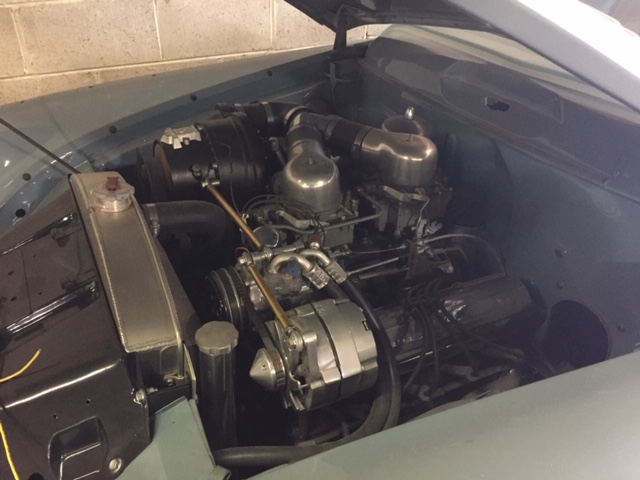

    Irish- FYI, the car has a cad motor, w/ Dual quads, and supercharger, thanks.

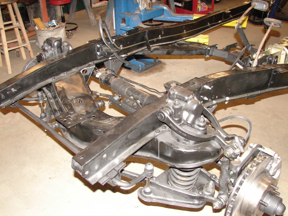

    Not. so, Mike. This is a Grand Am rack that has two threadded holes to which the adaptor that I will make attaches. The center moves back and forth, not the tie rods out the ends, as on more conventional R&Ps.
    This is a picture from a firend's '41 Chevy that I used the same setup. It works fine, especially after determining the length of the tie rods using a bump steer gauge.

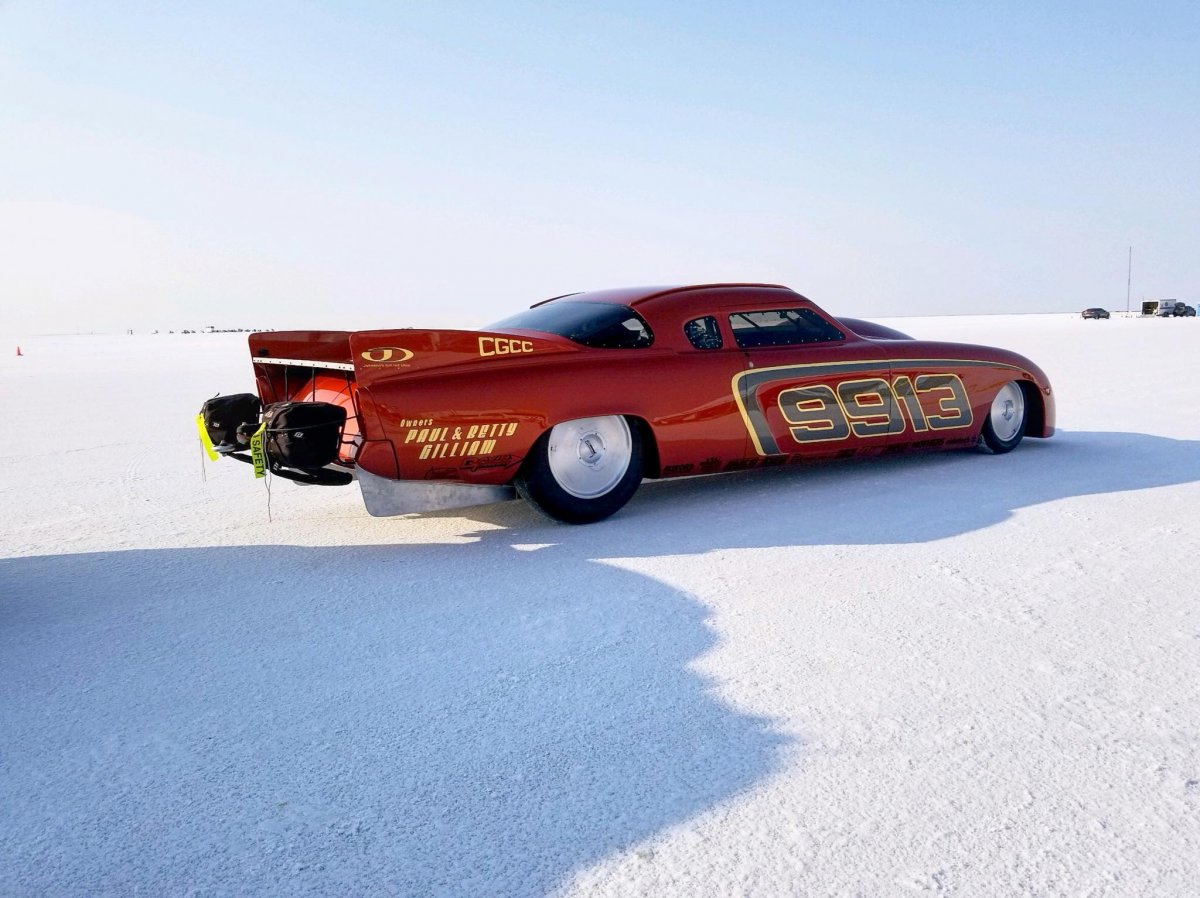

    loudbang and jim snow like this.
    I was not there when this one was chopped
    not sure how they did the back gl***

    I've been by that car and love its radical lines. But, race cars don't have gl*** windows, so that doesn't count :)
    Part of the reason I'm chopping it is I always wanted to do a curved-gl*** chop. That's why gentleman's chops also don't count (too easy). :rolleyes:

    Mike, the rack here is does not work like your Mustang rack.
    Enlarge this photo and see that it steers from the middle, not the ends.
    Hope this helps.

    The center moves back and forth and the bracket that I made allows the length of the tie rods to be about the same as the distance from the inner shaft to the ball joint on the lower control arm. On the '50 Olds that was done in R&C a number of years ago, they made the mistake of having made an adaptor with tie rods that were way too long, and the bump steer was about 1"!!!! Then they made a new adaptor WITH SHORTER AND CORRECTLY POSITIONED TIE RODS.:rolleyes:

    It's a center steer rack. This puts the inner tie rod locations almost exactly back to stock, or at least as close as you can get without the original monkey motion these cars have.
