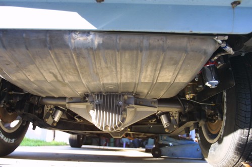

    Mike, what rearend are you running on the one with Wilwood brakes?
    Hnstray and loudbang like this.
  10. Mike VV
    Joined: Sep 28, 2010
    Posts: 3,324
    Mike VV
    from SoCal
    Winters QuickChange.
    Hung on early Chevy truck arms, and a wishbone centering device.
    Mike

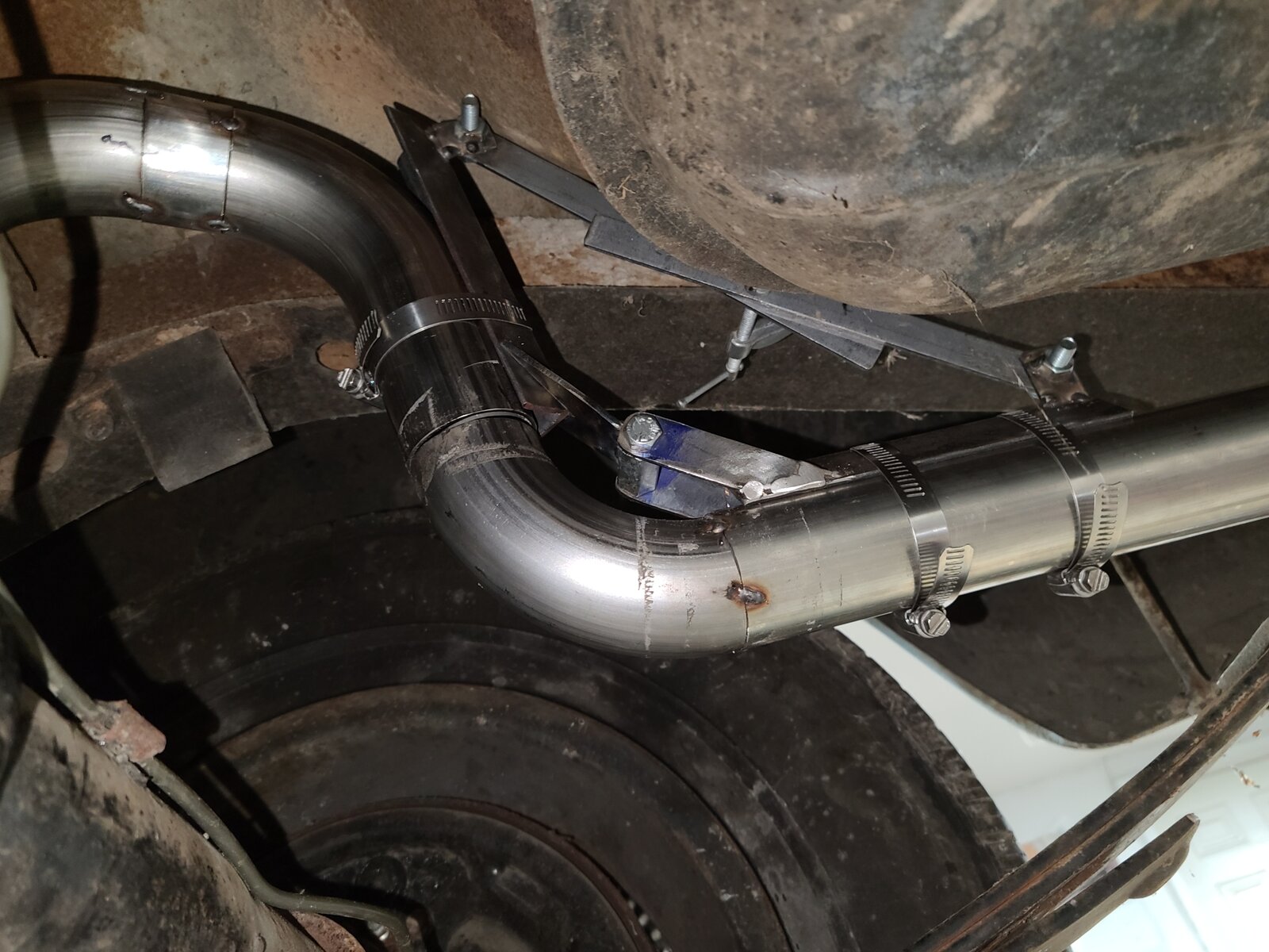

    So now it's back to the exhaust (I know I'm bouncing around). I actually have one side done to the baack of the differential and the other side just started. I am doing it all in 2" 304 SS and have been welding it up from straight pipe and elbows. I'll be posting some pics soon, but I thought I would show a tool I just designed and built to help join pieces of the tubing. I have had some issues with making good joints and positioning them correctly so I can tack weld them. Here is a drawing of a clamping protractor I made:
    Here are pictures of the two ways of using them, clamped on the inside or the outside of the bends. They are infinitely adjustable from straight to over 90 degrees. I will probably make anothe 2 or 3 to make it easy to finalizing the position along the full length.
    I haven't found anything like these in the tool market. I think they will work very well for most applications and should work for a wide range of exhaust tubing diameters.

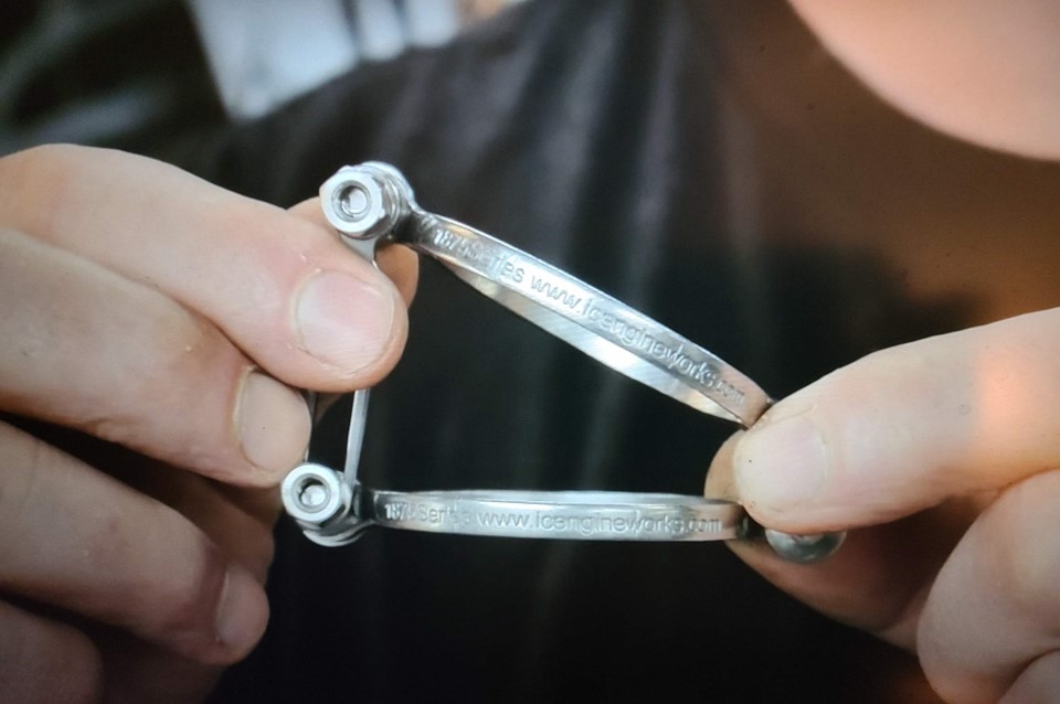

    Damn ya! Now I can't stop watching THROTTLE STOP GARAGE! :(
    So here are a couple of screen captures from his videos:
    Those might have been OK, but what I built will probably be better for holding two 2-feet long pieces of exhaust pipe in a stiff relationship to one another.
    Another hardware store visit and I now am building three more just like it for even more flexibility in fitting up the pipes.

    Here's my clamping protractor installed on the p***enger side tailpipe, behind the axle. It makes temporary, rigid connection. I have to mark and trim the joint and then tack it in place. I'm satisfied. :)

    That jig is brilliant/simple/cool as hell!
