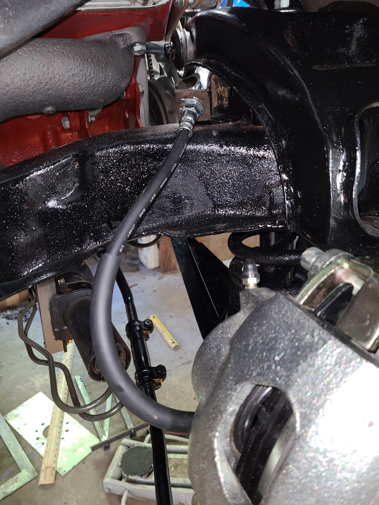

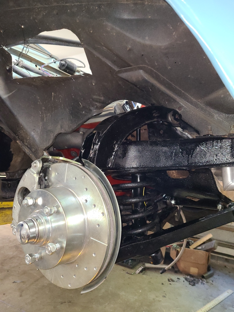

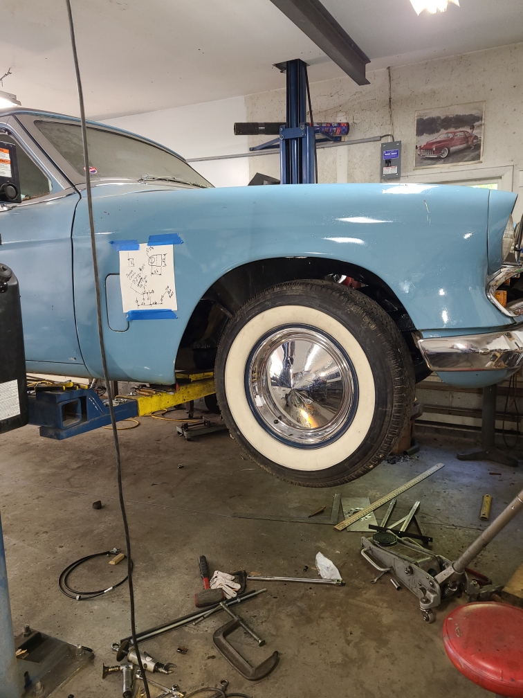

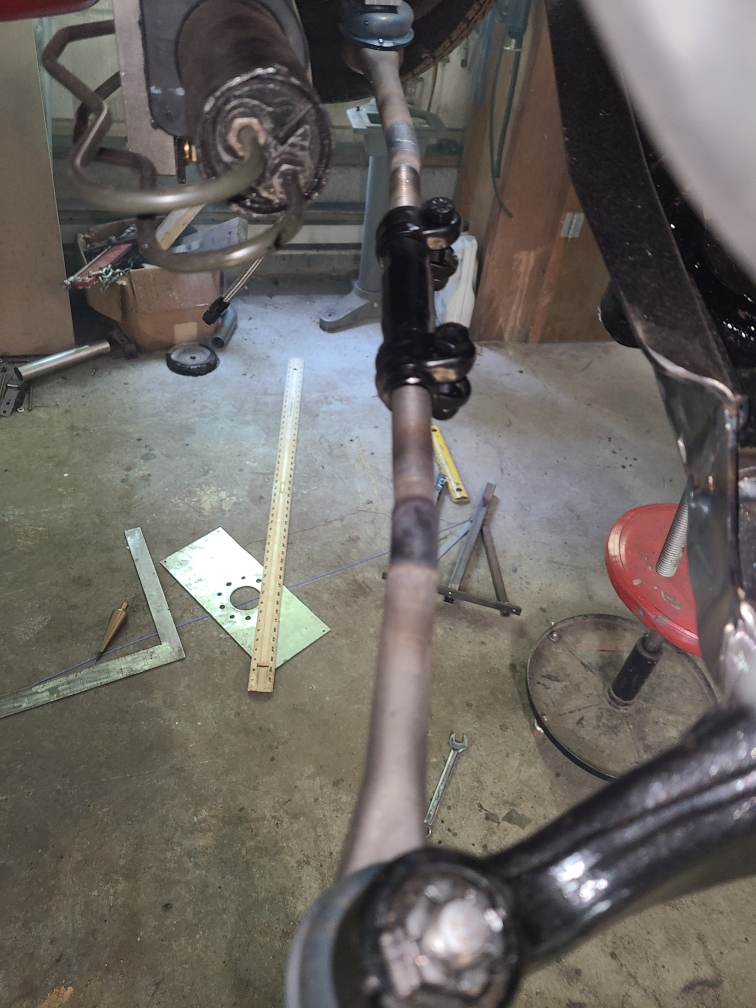

    Been back at it again. Finished up one side today. I'm not doing a body off or making all the mods finished like a show car. It's a driver and at my age (77) I might not finish the car if I tried to do that, so I am painting the undercarriage as I go with POR-15 and re***embling.
    One thin.gk that worked out well, was the Camaro brake hoses matched up perfectly with the Studebaker connection point on the frame:
    So now I can go down the road with at least half of the stering working::):rolleyes:
    See ya on the other side......

    Switched over to the other side. It's going faster than the p***enger side, as expected, because I only have to copy, not re-invent the wheel (isn't that appropriate) ;)
    Unfortunately, I have been busy on other stuff and finally am back on the 'Baker:

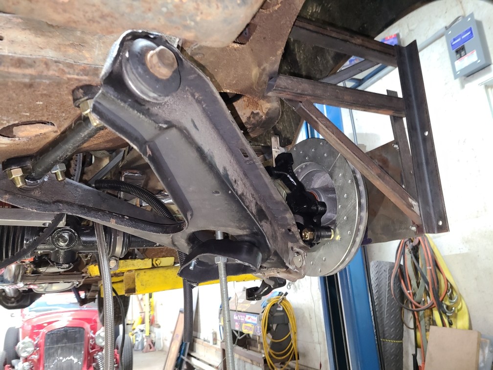

  9. Irishjr
    Joined: Jun 8, 2004
    Posts: 484
    Irishjr
    If I were doing it again, I might take a much different tack. You are right, the spindle height is quite different and a taller spindle might have been better (if there is one). I know that under a bounce the camber will be change much more to the positive (out at the top), so I hope that will not be a problem. I think that if I were using bias ply tires, that would be too hard on the sidewalls, whereas the radials are going to be much more flexible and keep the tread on the pavement.
    The other thing is that the control arms are rotated forward at the center when looking down on them, The Olds that were done in the R&C article were perpendicular to the center of the car. Thus, the center pivot that Studebaker used, kept the tie rod parallel to the movement of the control arms, minimizing bump steer. I may end up with minor bump steer that cannot be corrrected, but it's a cruiser, not a hard cornering sports car.
    I just couldn't bring myself to use a MII-style aftermarket front end.
    I think I would look at a Ford Crown Vic bolt-on front suspension. Even the wheel bolt circle is same a the Stude, and they are very plentiful. I don't know the tread width, but it could work. But that will have to remain a fallback Plan B......

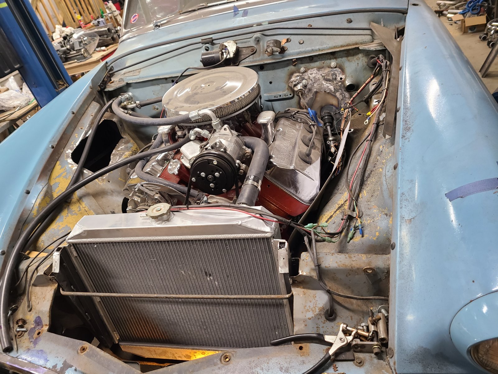

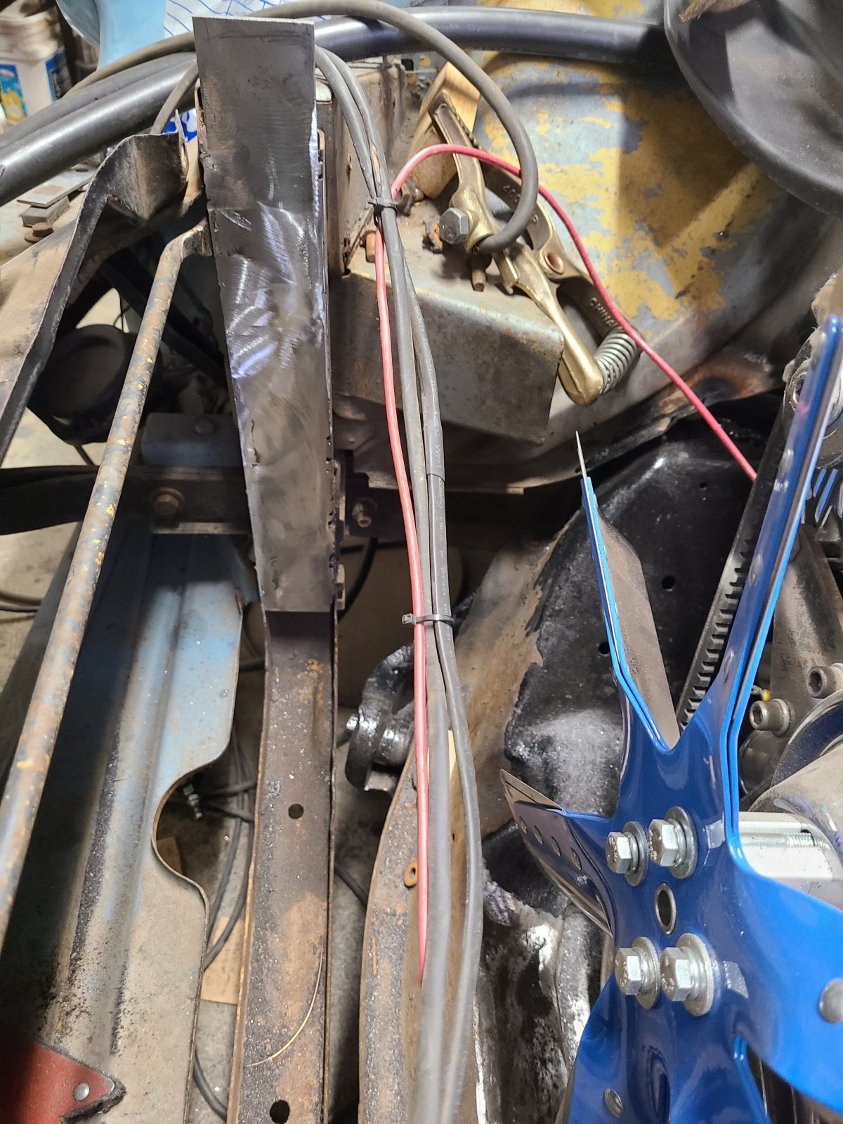

    Well, I didn't do much on the driver side suspension. Instead, I've been in the engine bay.
    Back over the December holidays, my daughter and grandkids were here from Denver. 17-year old Sam (my middle name and my uncle's name who died at Normandy) is a senior and has been accepted at Colorado School of Mines. HE WANTS TO BE A MECHANICAL ENGINEER! Whatta kid!!. So Sam says to me "I want to BUILD something. So we spent quality time out in the garage doing things he had never done before (his father is a home remodeler by trade, so he mostly has done things with wood, drywall, mud, concrete, nails, screws, and the like)
    At least he knew how to measure:
    So we made brackets and installed the radiator. First we filled the vertical "C" shape with a flush plate to give a surface to weld a 3/4" square tube with nutserts to hang the radiator and A/C condenser. The radiator is moved back from the stock location to allow it to be raised above the thermostat housing.
    Sam learned about planning (and fixing wrong plans), cutting metal, MIG welding, installing nutserts, etc.
    This is a Mopar radiator that I had the lower hose connection turned up to clear the rossmember:
    So Sam went back to Denver (next month we are heading out there for his graduation). Oh, he did have some clutch time in 26 COOP to learn how to handle a manual ******! ;)
    Next I had to cover a large opening to seal the intake to the radiator:
    I think that covered it nicely:

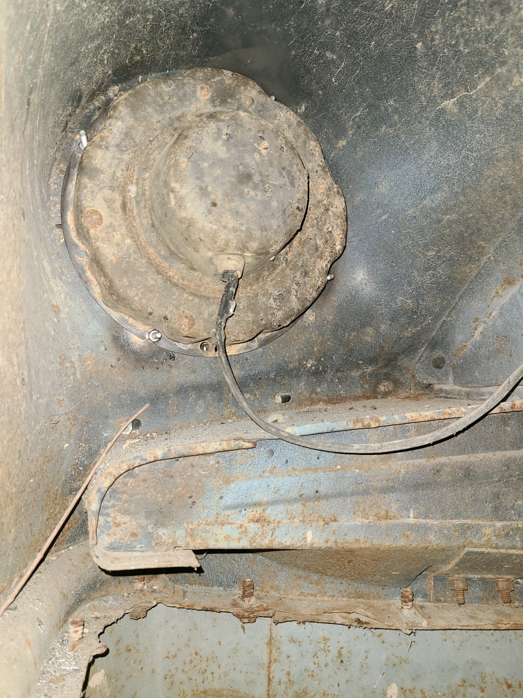

    Two pictures earlier, you may have noticed a big hole in the inner fender panel. That's where I had decided to mount the battery before I remembered the hole in the floor below the removable front seat cushion, where the heater core use to be. Good place for the battery! Now I gotta fill the ****oo hole...
    Well, I also needed to mount the A/C receiver tank and there's no really nice vertical surface to mount it on, sooo...
    I am going to bury the bottom of it in the fender well. I found it hard to determine the oval hole location on the sloped surface., so I made a piot round with a 2" OD piece of tailpipe below, clamped it place, and used a calipers to scribe the oval for a piece of 3" OD exhaust pipe to be welded in place:

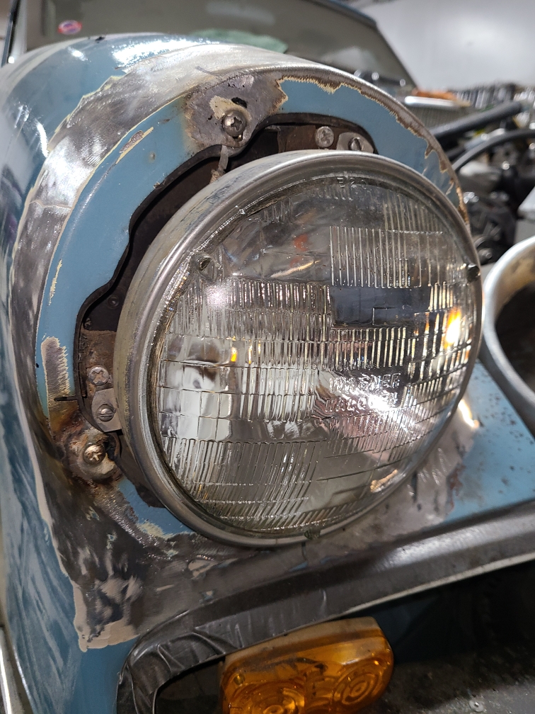

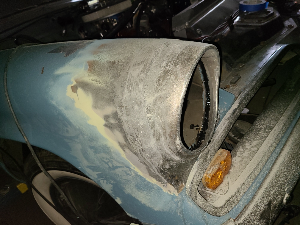

    I know I gotta get the suspension finished up, but I guess I must have Senior ADHD. I'm working near the headlights. I have this idea on how to restyle the headlights. I wanna try it. Let's do it.
    So where did the term Frenching come from? Got me! Anyway, I have never "frenched' headlights before, so here goes:
    When Bob Bourke (under Raymond Loewy) designed the '53 Studebaker Coupe, they had conventional headlight rims with a slight eyebrow, and wanted them painted the same as the car color. However, the big shots wanted more bling, so they insisted on chrome plating the rims. many Studebaker owners painted them anyway, and that's what I did with mine back in 2010 when I bought the car.
    But this is going to be a "full" custom in the vernacular from back in the day. Gotta be with frenched headlights. Besides, the high quality fit and finish of 1953 wasn't too good. Things didn't line up so well.
    Besides, I wanted to round off some of the sharp edges around the headight and eyebrow.
    So the first thing is to move the buckets behind the flange on the fender, so I can R/R or adjust the beams by removing the bucket from the back. A little metal removal of anything projecting out the front and silver soldering 4 #10 stainless screws to the flange was pretty simple. Problem solved!
    Then Iblasted the rims and glued them in place with 3M panel bonding epoxy adhesive, followed by laying a layer of fine weave gl*** across the outside permiter gap, using West Systems epoxy:
    You can see how the front lip has been rounded over. Now I will apply a little magic mud and primer. For now, that's where I am on the frenched headlights.

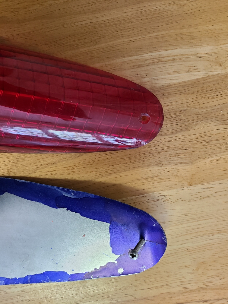

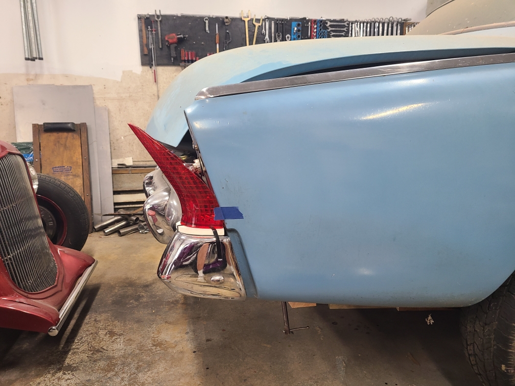

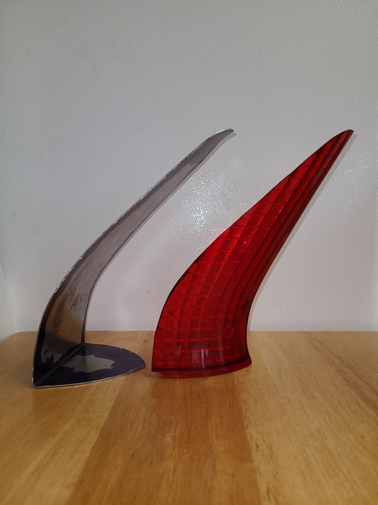

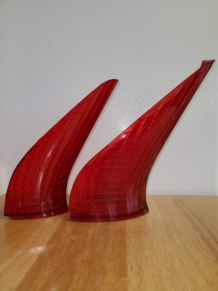

    So today I was kinda loafing out in the garage. It was abeautiful day, my sailboat Vesper was launched yesterday and I put the foresail on the roller reefing in about 12 knots of wind. That tired me, so I just played around.
    The last paragraph of the previous post was what I played with. In order to fit '56 Packard taillights on a '54 'Baker, they have to be cut down. I had masked off where I thought I needed to cut a lens and that's been sitting there for aleast a year, so here goes...
    I think this is going to look good:
    Here I taped a bit of template cardstock to better mock it up:
    The uncut lens is on trunk. I should have taken a picture with one next to the other to better show the difference, I think I am going to move the trim piec back about 3" to beter go with the extended fender.

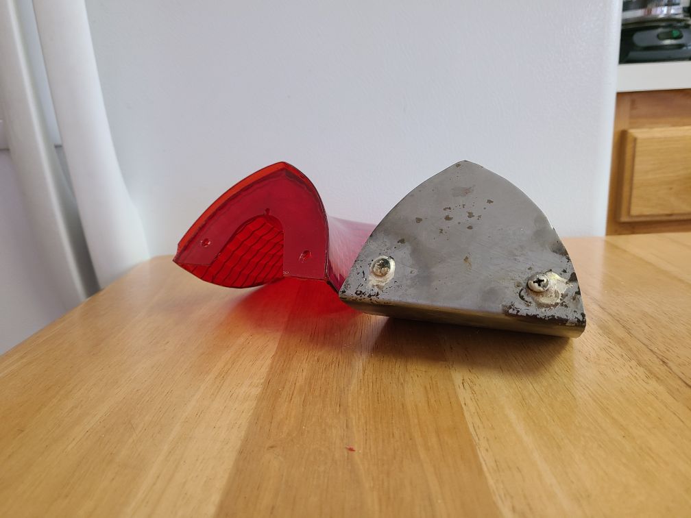

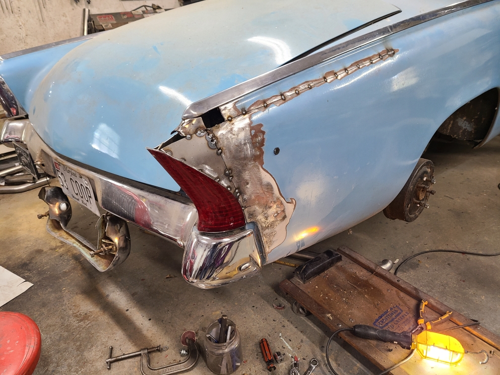

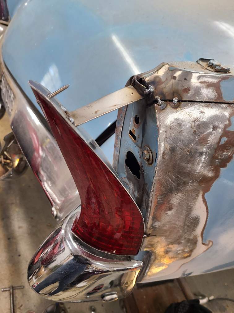

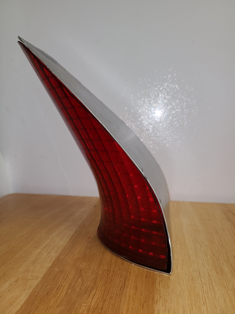

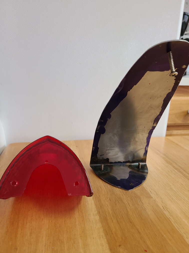

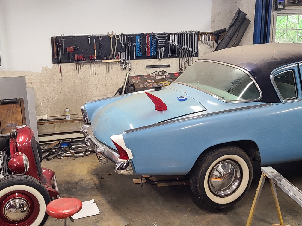

    Continuing on with the Packard taillights...
    I don't know about you, but sometimes I can't stop working on a side track (and not getting something like the front suspension done) until I get it worked out in final form like I have it planned in my head. So about the Packard taillights:
    I wasn't sure how to develop the smooth fit of the lens perimeter. Should I use a round rod to form it or perhaps somethin about 1/8" thick that I could later round off the edge in a "frenched" mode. Instead I came up with this formed #18 ga. plate fit to the curve of the front edge of the lens:
    It turned out to be simple to make by single bend in the break and hand bending the rest of the curve. Then I added a couple of locating pins (#10 stainless screws silver soldered to the base and a stainless countersunk sheet metal screw at the top:
    Then prop the ***embly in place, mark where it should be tack welded to the end of the fender, and stick it in place:
    By the way, note how I cut along the convex bulge of the top of the fender, just below the trim. This alowed me to pry the fender side out about 1/8" to match the widest part of the lens base.
    Then I added a tab near the top to hold the ***embly in place while I added filler sheet metal. This will be removed once I cut out the center portion of the curved plate for the LED light from Lambert Enterprises and add a sheet of acrylic light diffuser to spread the light out inside the lens.
    Next, I decided to move the fender top trim back about 1-1/2" to keep it looking right. I just moved the curved sheet metal back and added a filler portion. Later, I will be relocating the curved sheet metal at the front of the trim back the same 1-1/2" and welding up the seam ahead of that for a smooth look.
    I still have a little bit of filling in, but for now I am really happy with how it looks.
    I have been dreaming of having a car that would look good with '56 Packard taillights. OK, so the '53 Stude fenders are not as tall as the packard, but I think it came out looking good. Here is a side-by-side of the two lenses, one trimmed and one stock:
    Tomorrow I'll get the sheet metal filled in all the way.
    G'night...

    Hey, Irishjr;
    Good idea on the taillights. Have you tried to move the little stude fender tip back to the Packard light tip, so's the fender would look like a stude factory piece? & of course, slide the stainless top along w/it. Looks to me as if the stude fender-top curve would be correct for the lens size you have. I think it would look good, & well proportioned. It would look a bit less custom. Tell folks that it *could* be a factory prototype instead of the std tail-light treatment. But you're not 100% sure... :D :D .
    Marcus...

    On the "cheap" (Government type's) 53's and 54's, BOTH, the headlight rings and the tail light housings...were "not..." chrome. They were painted body color.
    Mike

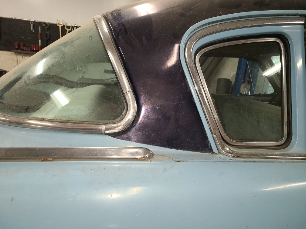

  28. Irishjr
    Joined: Jun 8, 2004
    Posts: 484
    Irishjr
    I kind of agree with you about how far to move it back, except I like how the leading end of the trim lines up with the leading edge of the rear window.
    However it's only a bit of cutting and welding if I want to change it. I'll finish out the tip of the tailight surround today and see....
    Thanks for the input.
