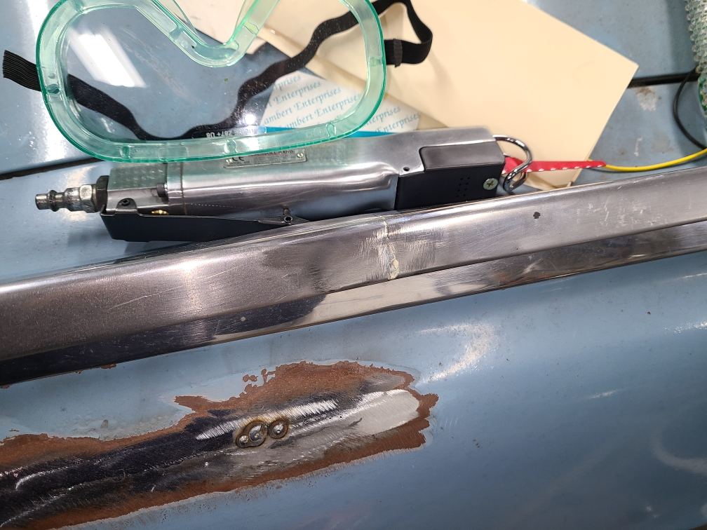

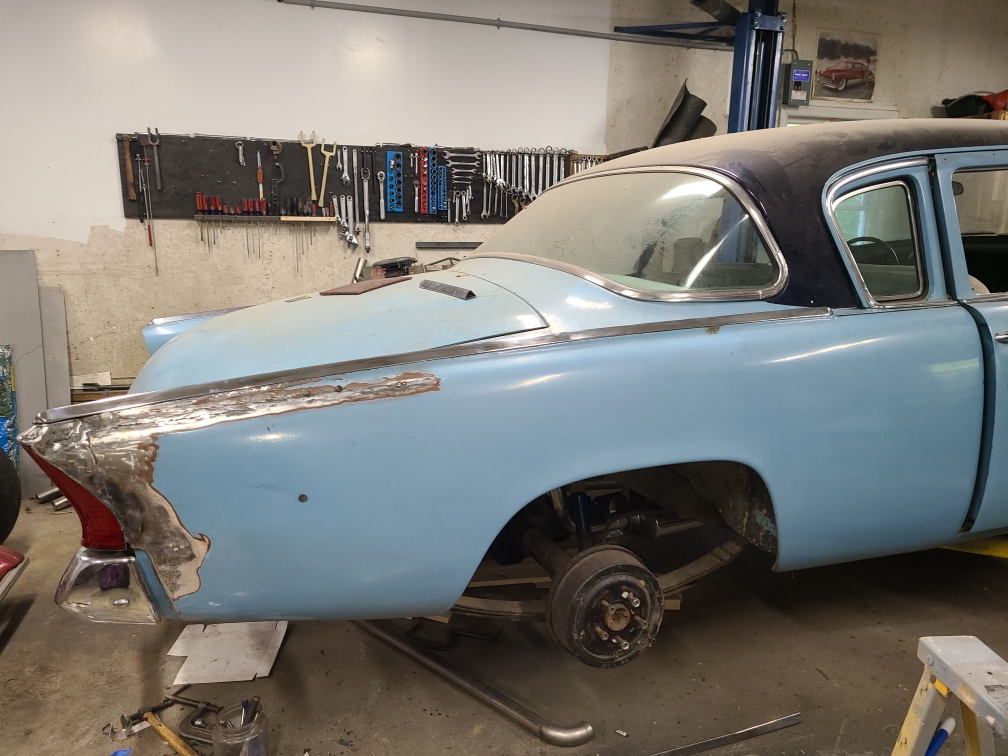

    Keeping on with the taillight, I finished off most of the metalwork (at least on the side you can see. I am pleased. Now to make the driver side look the same....
    Tomorrow I will start on the other side...

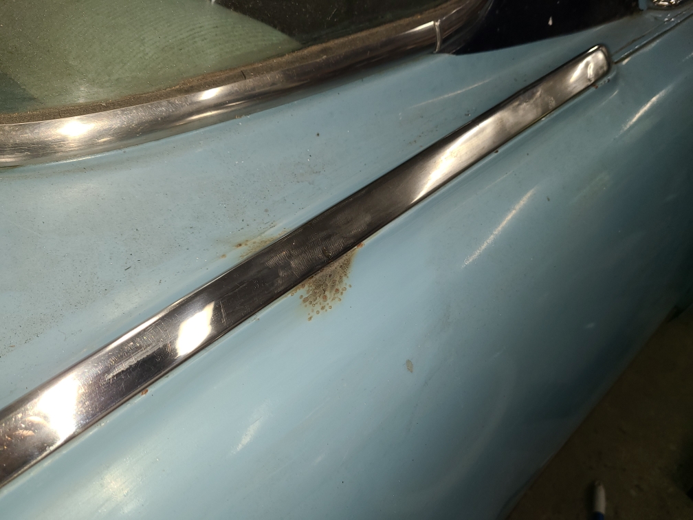

    nrgwizard-
    I tried the simple way, but it turns out I like your idea better. I collaborated with Cody Walls, in Delaware, about lengthening the trim piece (kinda scarey). He also agreed that it would look better extended. So I mocked it up:
    At the C pillar it may still work without extending the trim, as I plan to do a "tribute" two-tone blue paint, but with metallics and a fade instead of a hard line.
    I'm gonna play with it before I start cutting, perhaps moving it forward about an inch, but I'm liking it better than it was.
    Thanks for the suggestion.

    Hey, Irishjr;
    You're welcome. Glad it turned out that good. :) . On the trim cover piece, you could extend it a few ways. Get another piece n cut, then tig weld. As you know the material is thin. Did I mention "thin" ? :D . You could do an extension by cutting & ****ing w/a cover piece like Stude did on the window trim. Another way might be w/a thin backer piece made from s**** trim, & silver-soldered(or maybe reg solder, can't remember trying that) one or both joint ends. Or jbweld. Hardest part of the mod would be the perfect-joint required. I don't think a perfect joint would distract from the mod, & would offer "a clue". Not sure on which end I'd do a visible joint, near the color-change just might move the eye from the joint to the paint. I do believe I'd use a modified trim clip at, or near the joint for strength. The back end looks about right where it is. If you extend the 'T' section twixt the fender/body joint, & cut back the trim mount, that just might look good too. I'm no welding expert, since a trim piece will be sacrificed, I'd spend a little time cutting the cast-off into thin strips for welding filler. At least the material would be the same, & theoretically, should polish out w/o a trace. BTW, since you're extending the fender trim, maybe consider putting the front tip just under the window surround trim, just a hair in front of the drain gutter.. I always thought that the fender(hide-em) trim was too short, visually.
    Marcus...

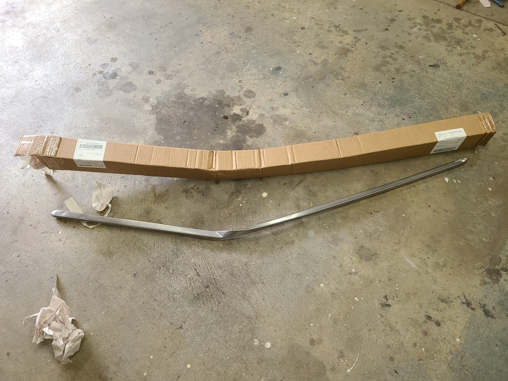

    Thanks to all of you who have suggested things on the taillights. I really appreciate them and ultimately I am REALLY happy with the results.
    UPDATE:
    The extra trim piece arrived. Unfortunately, it was bent:
    Unfortunately, I had to submit a claim with Mr. DeJoy's USPS.
    Fortunately, I will probably get my money back.
    Fortunately, I only needed some end pieces.
    Fortunately, it provided me with enough pieces to try the splicing.
    Fortunately, the silver soldering with a backup piece worked.
    Test piece:
    Fortunately, I did a neater job on the actual trim. It polished out pretty good, although I still may send it out for chrome plating.
    So thanks to all for how well it looks:

    Here is where I am on the taillights. I also welded the bumper bolts, flush front and rear, and sent them and the top-of-fender trim off for chrome plating.
