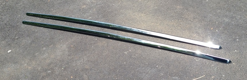

    So recently I received the trim spears back from Custom Chrome Plating in Grafton, OH. I had the other plater, who has my bumpers, forward them to CCC because he said he couldn't do them because they were stainless that I had silver soldered to extend them.
    Then I called CCC and asked to talk to Jon Wright, the owner. The lady said he wouldn't be in 'till about 11, so I asked her to foward a complaint to him....after a pause, I told her, "These are so damn perfect, I will have to start my project over again!" She said I almost gave her a heart attack! :p:p;)
