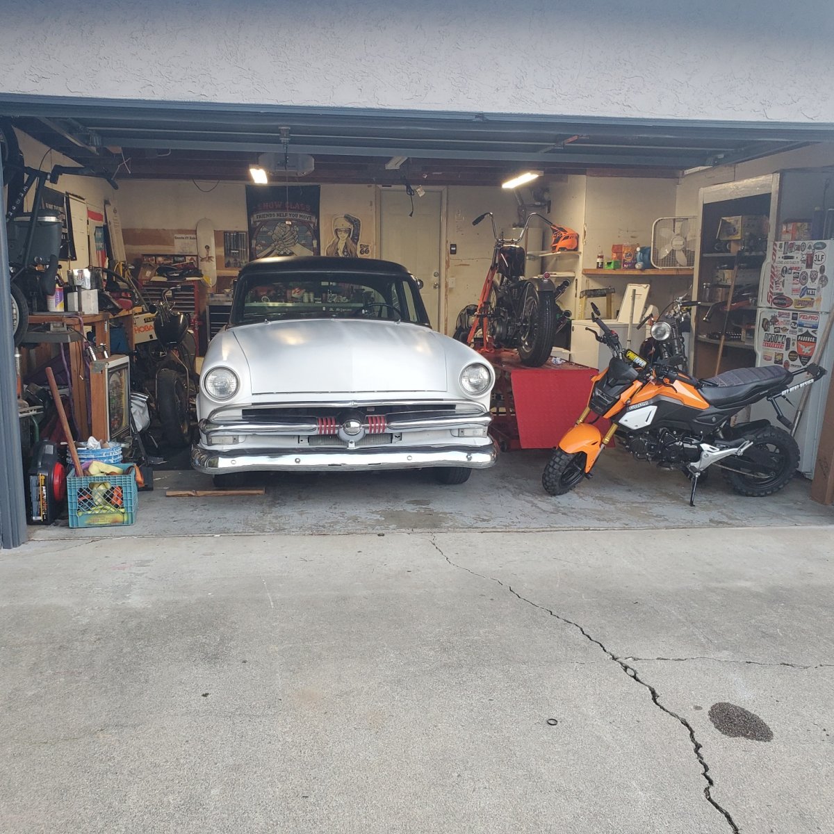

    Update: got the car home safe and sound, and its just as good as I remember it. The aerostar coils and front camber kit I bought for it were still in the trunk with all new shocks, and it now has a working radio. The goal is to rebuild the front suspension and possibly put a new steering box in, rebuild the rear brakes (dont know when the last time they were done) and new tires, and then possibly exhaust. It's a tight squeeze in the garage now. 5 bikes and the car..

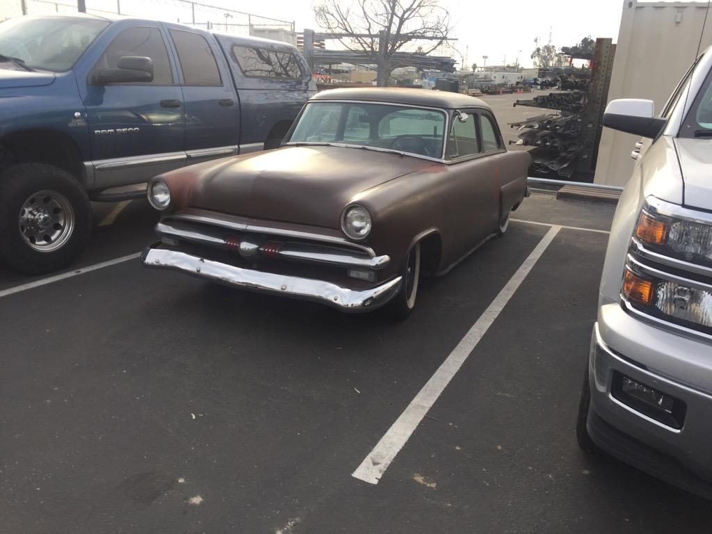

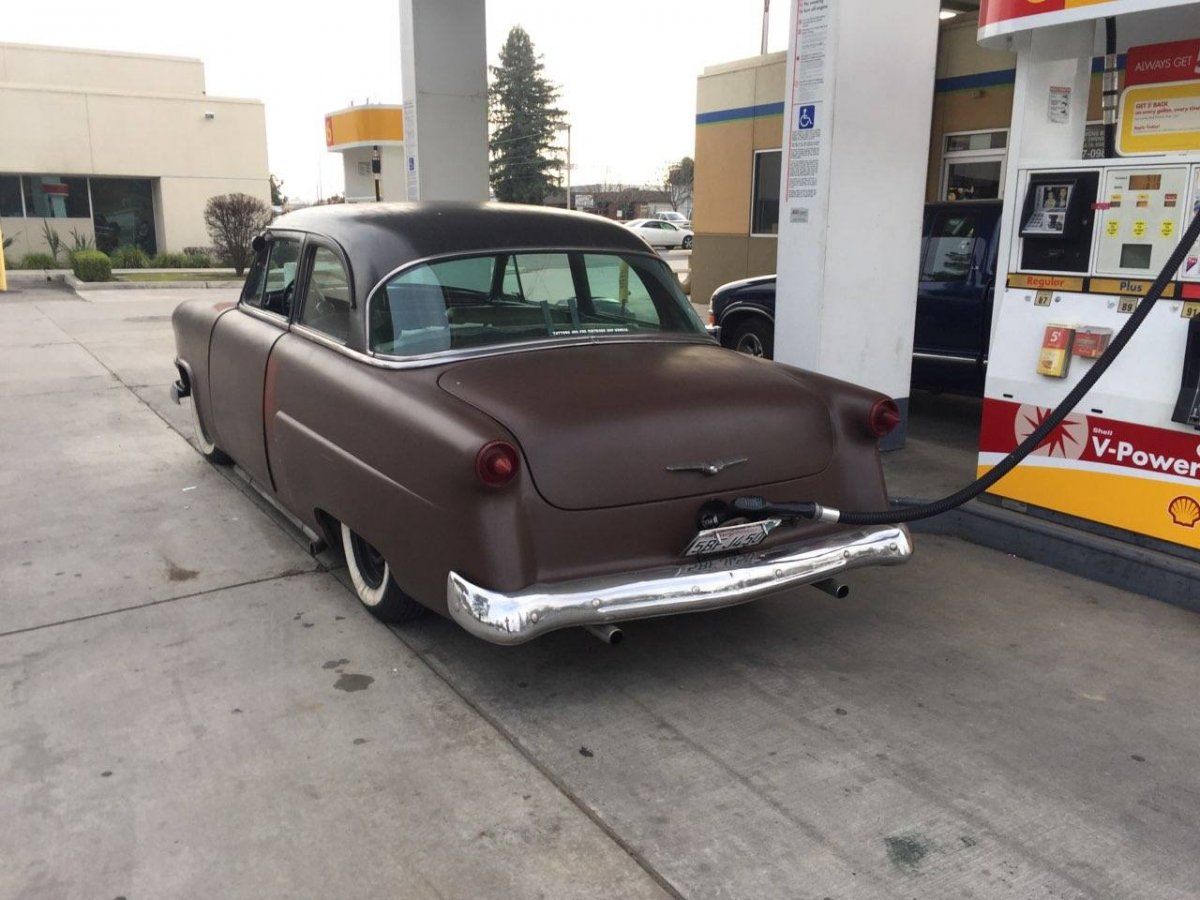

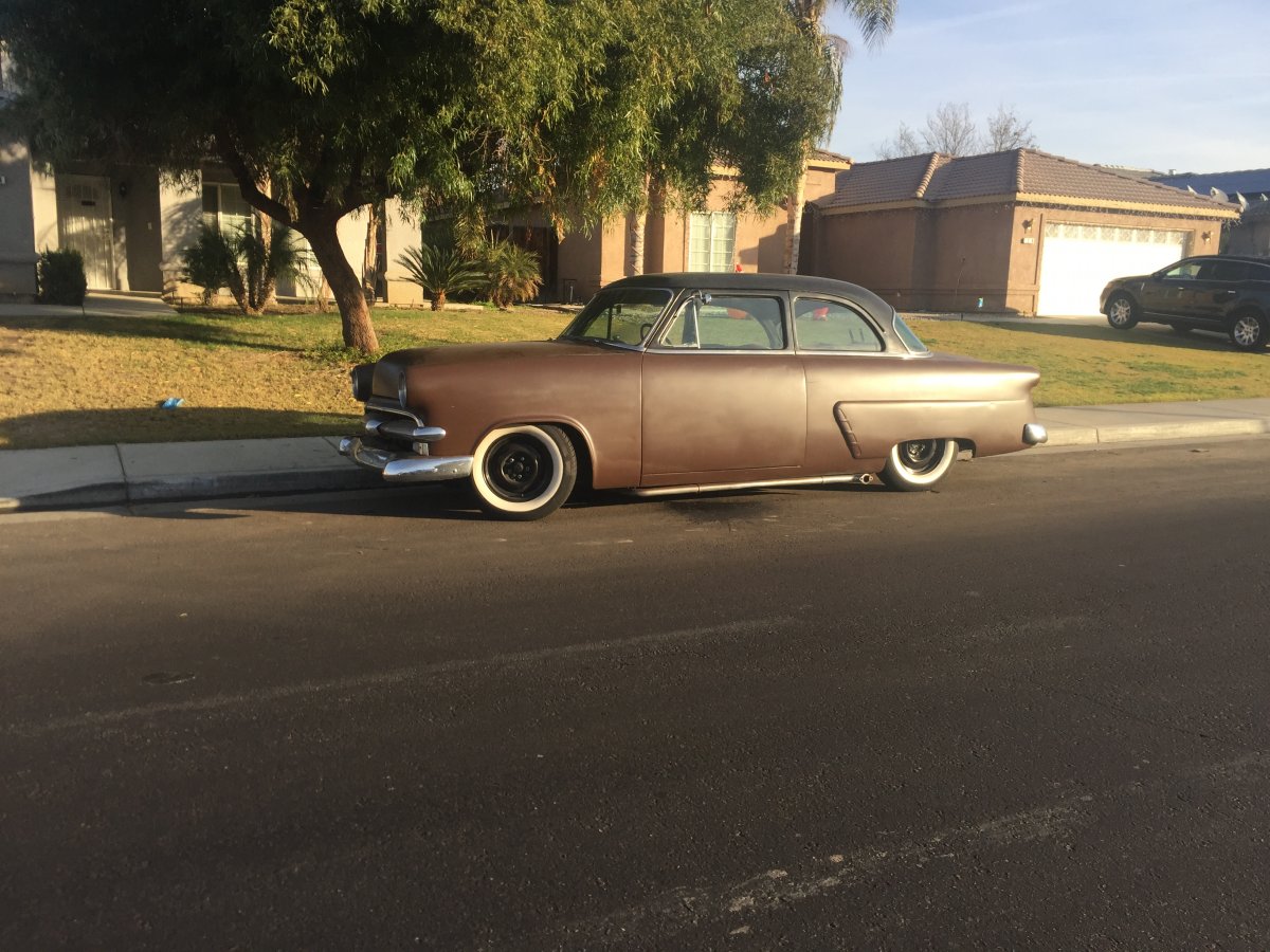

    Figured I'd attach a couple pics from when I owned it the first time.

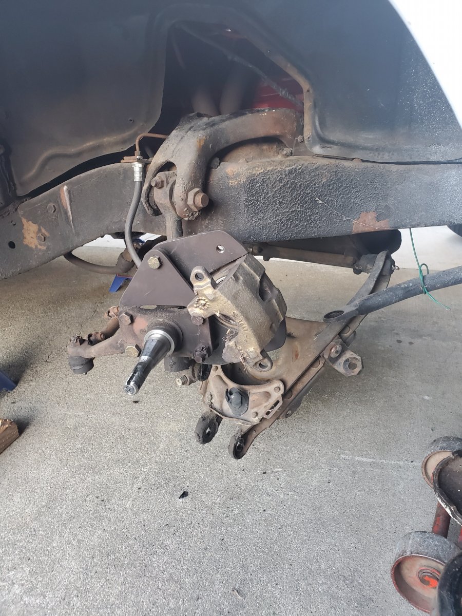

    Well: drove the ol girl to work today and it drove fine other than the trans has a weird shimmy going into overdrive. I got the fluid and filter and even one of the fancy neoprene gaskets with the steel core (I love those gaskets) and figured I'd jack everything up and check it out tonight. Turns out the front wheel bearings were LOOSE and likely ruined. I'm not gonna chance it, so it's off to the parts store for me tomorrow for bearings and seals.
    Once I got that far into it, I noticed I was 2 bolts and the sway bar away from replacing the front springs, so I figured I'd throw the aerostar springs in. While replacing the springs, I noticed almost all the dust seals in the front end are done for, and most of the zerk fittings wont even take grease anymore. So it looks like a rebuild of the front end is in the near future. Kingpins seem tight, and all the bushings seem tight, but for $400 or so and a days work in the driveway, I'll re do the front suspension soon.
    While ordering front shocks, I ordered all new bushings and such for the rear suspension (it was cheaper than the front suspension at the moment) and figure I'll re do all that next. Maybe even throw in a new ****** mount and u joints for good measure. But for now shes sleeping outside in the driveway for a couple days. 20200303_182221.jpg 20200303_182221.jpg

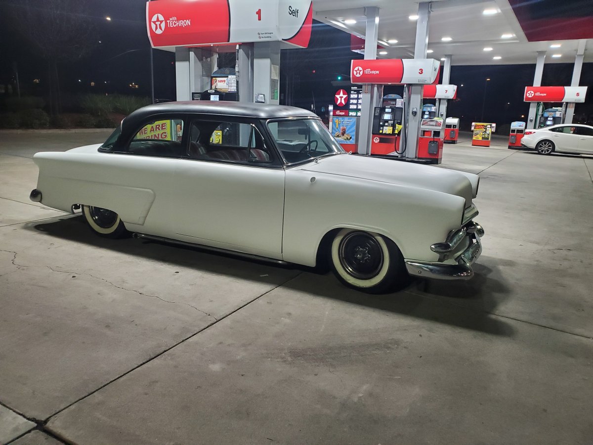

    20200222_202220.jpg 20200305_182813.jpg a little before and after. Got the car on the ground last night and it got raised up about 2" in the front. So far I've replaced wheel bearings and seals, front springs, motor mounts, front brake rotors and pads, and checked the front end over. I still have to flush the trans and the rest of the fluids, rebuild the rear suspension and possibly replace the radiator, and a basic tune up (plugs, cap, rotor, and wires) and I figure she will be about dialed in!
