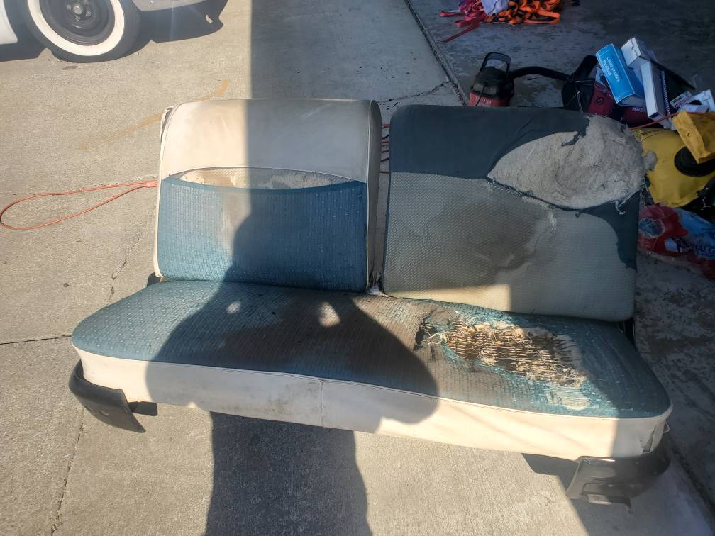

    Got the rear brakes replaced and re did the front accessories on the motor with a new water pump, hoses, thermostat and all that. She runs at a cool 180 degrees now. Next I picked up some 64 thunderbird bucket seats from Craigslist to go in. Just need a 60s falcon center console, but the interior should be a LOT better. I also bought a set of 15" lyons hubcaps for the car (they don't fit) and the rubbers for the fender skirts (they sent me merc instead of ford) and a factory style rear view mirror (with no brackets or hardware)... so im moving forward. Two steps forward and one step back at the moment. 20200531_161732.jpeg 20200531_161856.jpeg 20200531_161943.jpeg

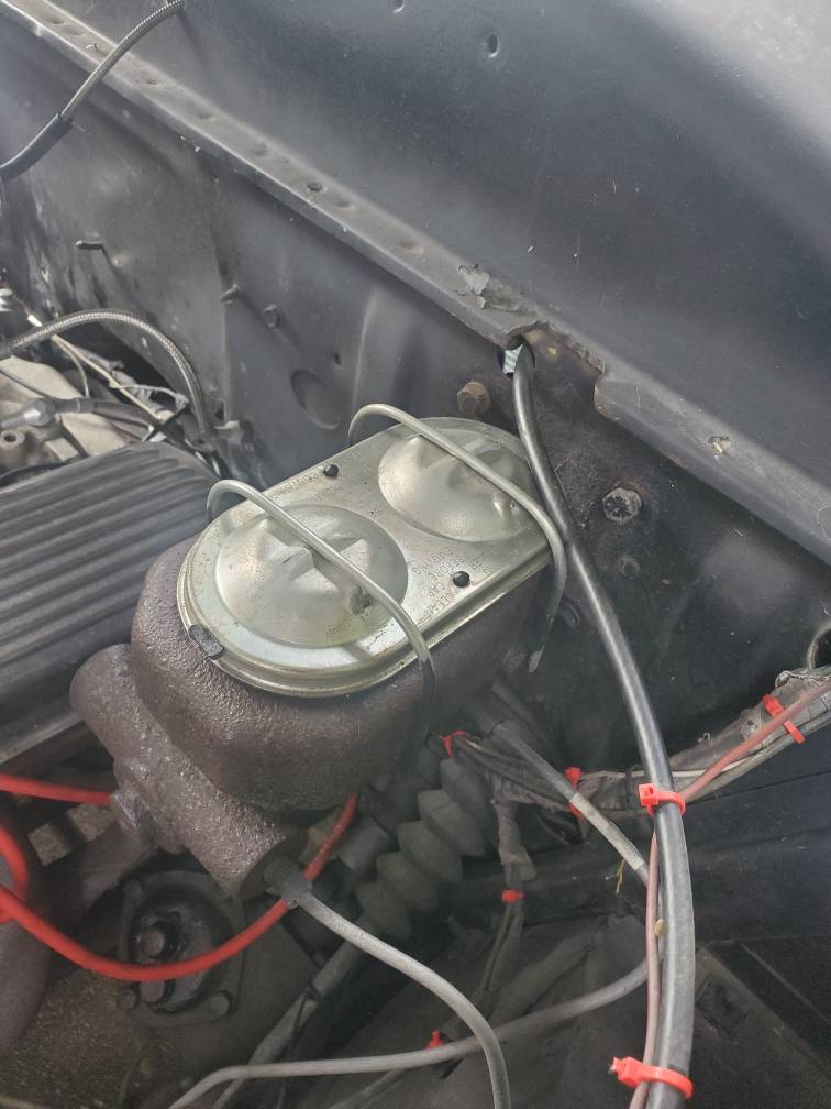

    I forgot to mention in that last post im contemplating going to power brakes, or at least putting in a new master cylinder. Anyone know what my master is out of or a direct bolt in? I'm thinking 60s mustang or something would be close. I'm disc front/drum rear.

    The 1952-54 Fords use the same brake shoes as 1967-71 V8 Mustangs you can use this combo for drum/drum or disc/drum https://www.ebay.com/itm/1967-1970-...ustang&hash=item59128e525c:g:lcwAAOSweatemeJK The master shown in your picture is a GM master used in the 70's a lot of folks called it the "Corvette" master I guess to sound cooler.

    Later Ford masters have the same spacing as the old ones, 3.20" or 3.25". Mine in the '59 is a Fairlane/Mustang disc drum unit.

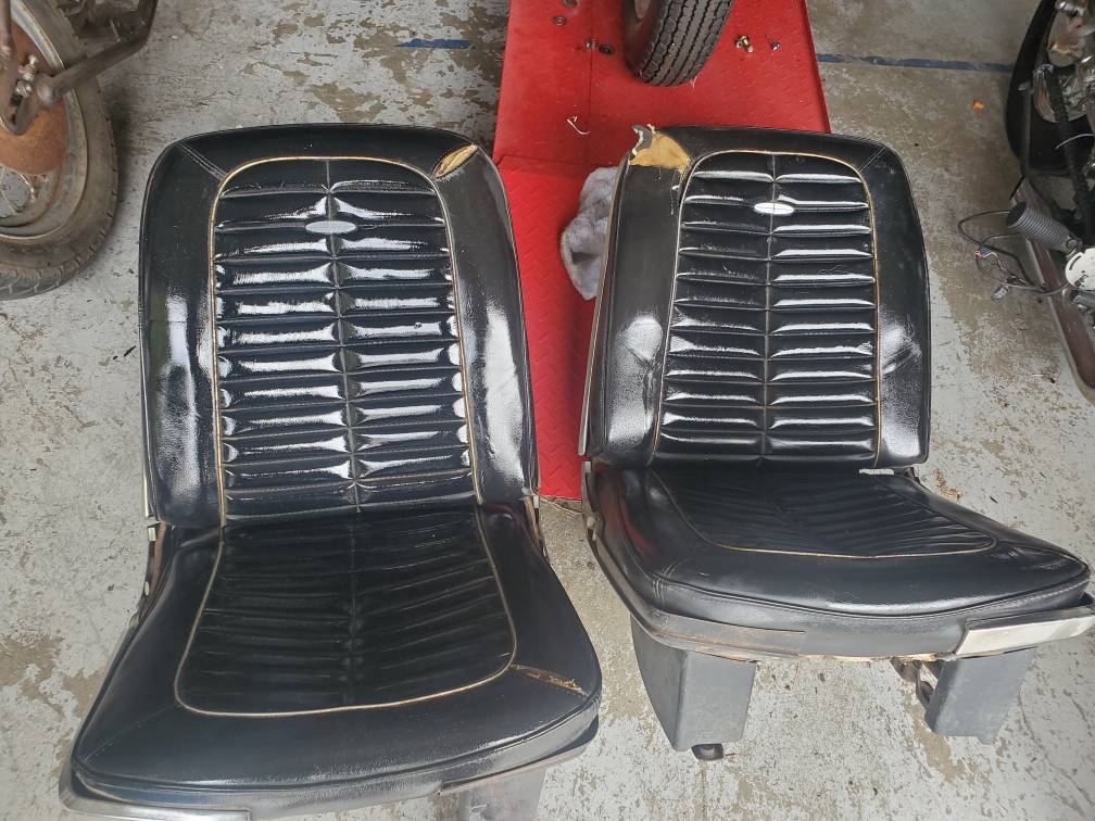

    Ferdyeight
    Got these t bird seats finally mounted in, and got a lot of the rust scrubbed off the floor boards. Still have to pull the door panels and rear panels out, and coat the floors and insulate everything. Also have to fab up a new driveshaft tunnel. IMG_20200724_093926_236.jpeg IMG_20200724_141155_472.jpeg

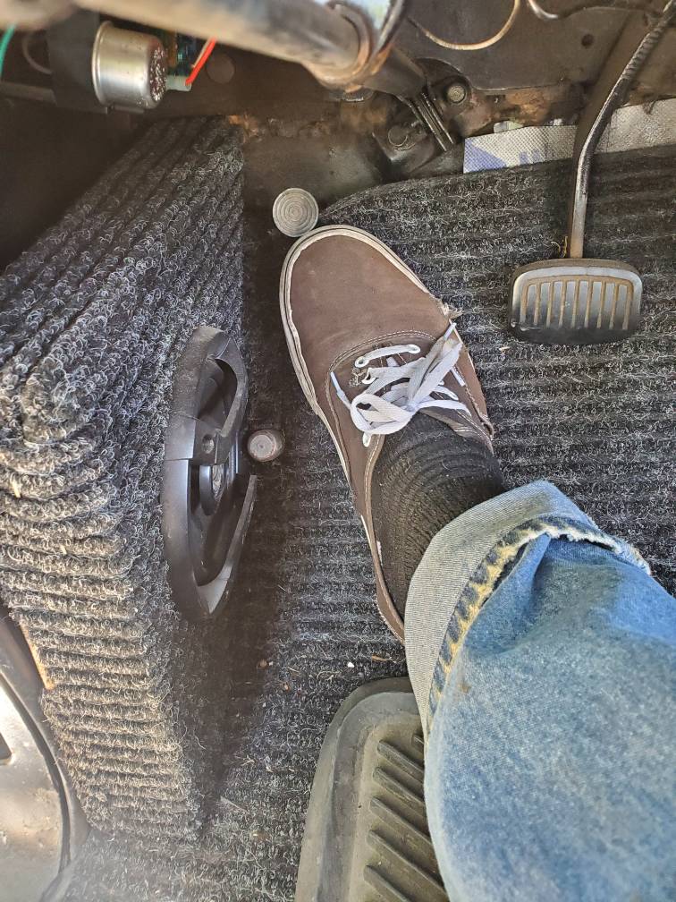

    Anybody know what this switch does on the floorboard? Windshield washer or something? 20200724_143414.jpeg

    Starter?

    That kinda makes sense. I cant see what's on the back side of it..

    Foot pump for windshield washer, I think. I'm out of town right now and can't look at mine.

  19. No, I don't think it's a washer; the washer foot pump was mounted inside the car, and were all mechanical and pretty obvious as to what it was. I suspect that was installed by a PO, you'll have to figure out why...

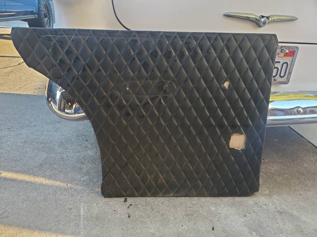

    First try with upholstery work.. separated the rotten backer boards from the rear panels, and got it glued on with heavy duty adhesive! I gotta locate an ashtray and trim out the holes for the arm rest and the window crank. IMG_20200806_193708_250.jpeg

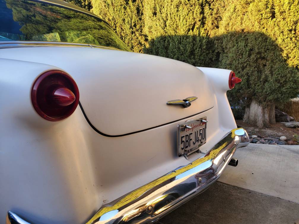

    Also: spent a couple weeks looking for tail light lenses like this, as it turns out they're caddy lenses glued over the center bullet of the originals. Sometimes I amaze myself with how I overlook the simple solutions. Only markings on em are fomoco and theyre almost seamless. Gonna build a new set since these are wore out. 20200806_194039.jpeg

    Nice! So the diamond tuck material was already there and you just replaced the backboard?
  26. Ferdyeight
    Joined: Mar 8, 2016
    Posts: 365
    Ferdyeight
    Yup! The door panels and rear kick panels are that material. So I just bought reproduction back boards and high strength adhesive to put it all together!
