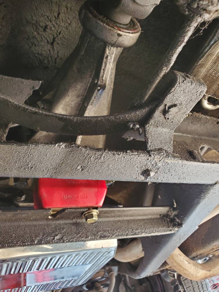

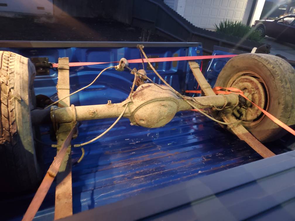

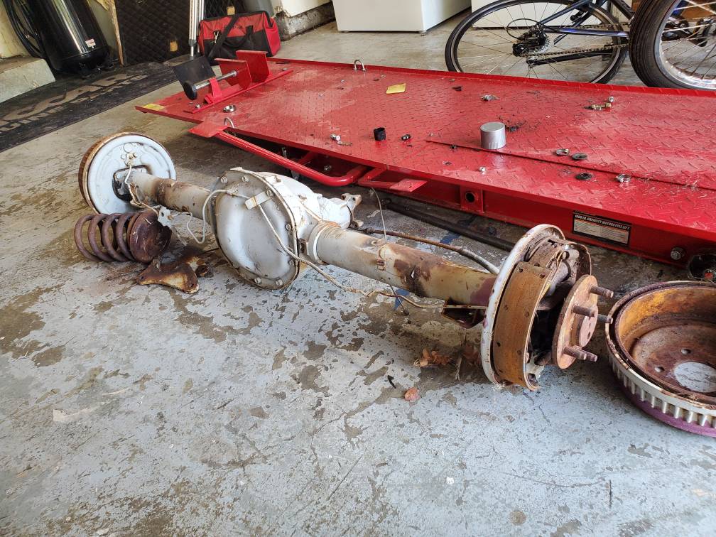

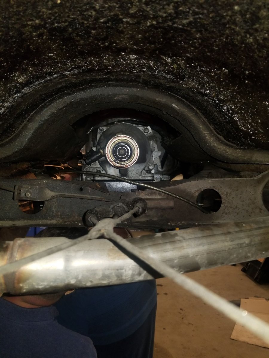

    Got my new rear end from my uncle, its a grenada rear with 2.75 gears. Hoping it will work behind the AOD and hoping the pinion length is gonna be OK so I dont have to buy a new driveshaft.. but i got a new speedo cable and gear and now I can see how fast I'm goin! 20200902_172910.jpeg

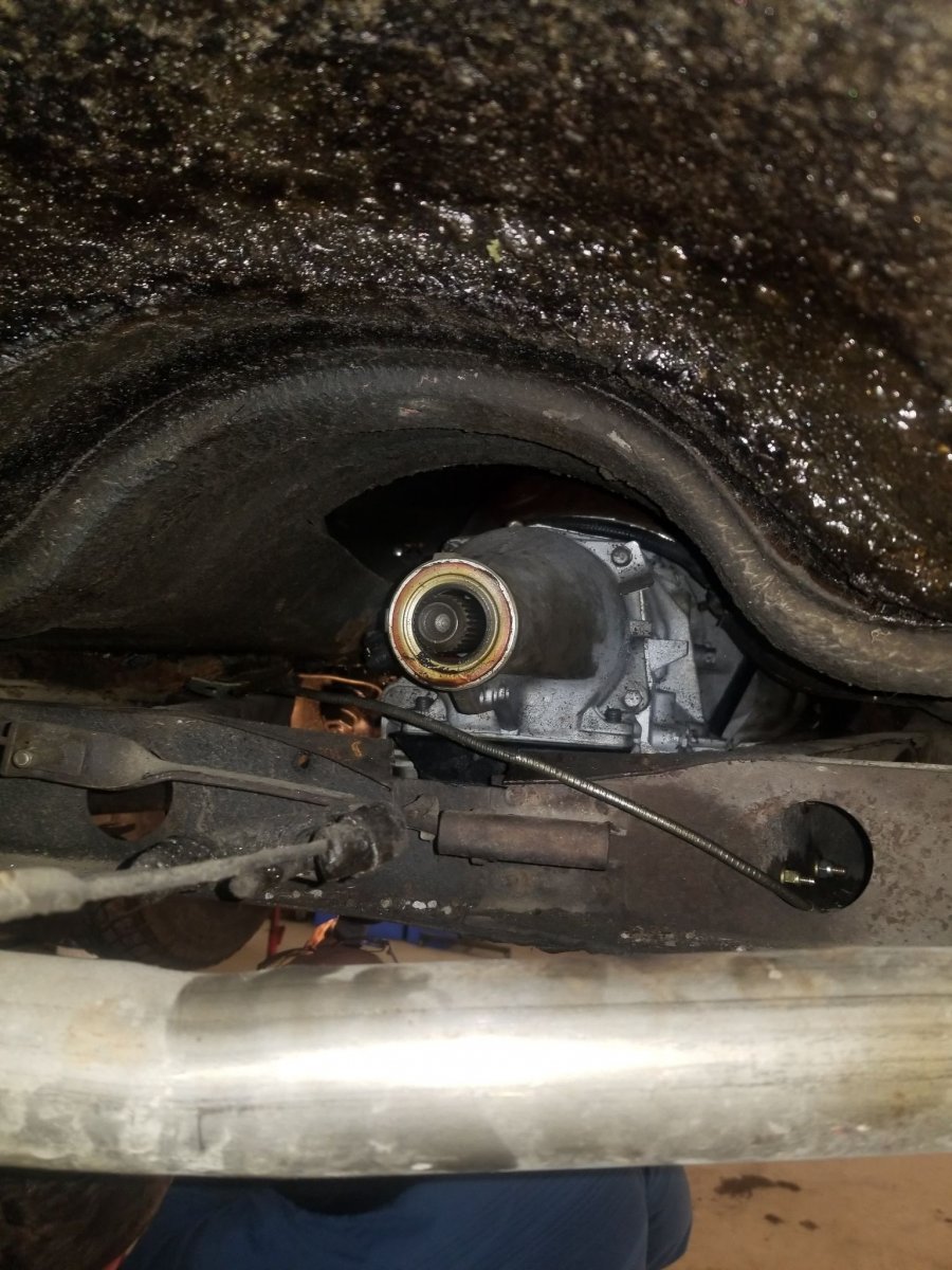

    And i have to fix this setup somehow. May have to wait till winter when the car goes to my dads where I have access to a lift to do the floor pans, driveshaft tunnel, rockers and front door patches. And hopefully I can con my dad and uncles to re align the front sheetmetal and get the body gaps somewhere close to respectable.. 20200902_163430.jpeg 20200902_163442.jpeg

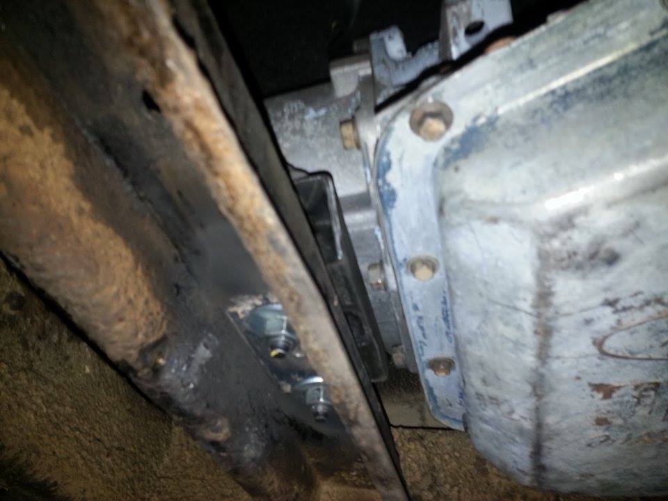

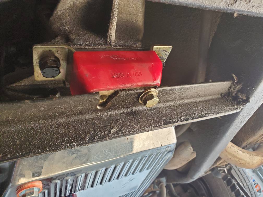

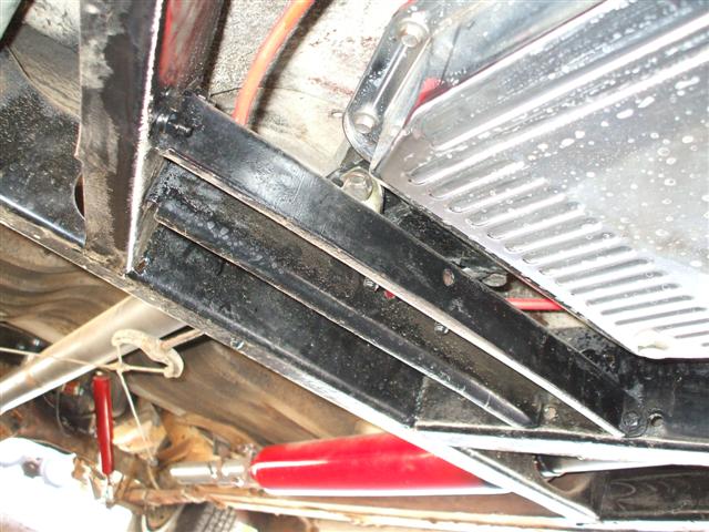

    Looks like someone wacked off the original transmission cross member and replaced it with angle iron. This is a '53 with a 302/AOD using a Butch's 15" swap kit https://butchscoolstuff.com/52-53-ford-car-15-sb-ford-engine-transmission-mount-kit-2501cpb/ It only required some redrilling for the mount. Second picture is from the rear. AOD 2.jpg

    Different angle from the rear shown here. If you can locate a drive shaft from a 1982-86 Crown Vic it may bolt right up,I used one in my '54 with a 302 &AOD just changed the rear U-joint to bolt up to the stock rear.

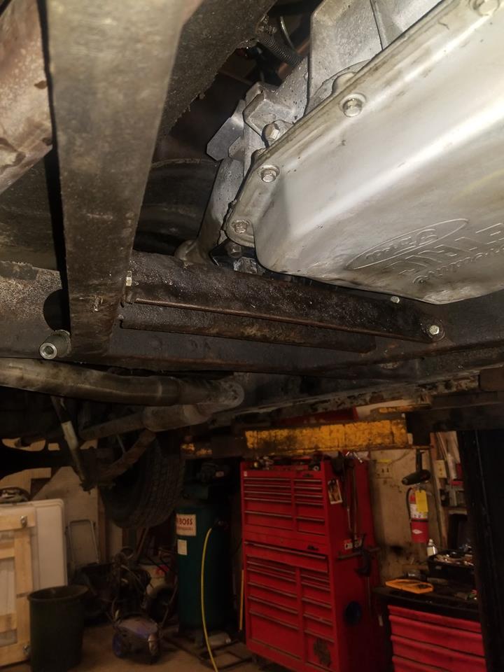

    Here is another view of the '53 stock cross member with AOD The next picture is my '54 with the 1986 Crown Vic drive shaft. AOD53.jpg

    Looks like a lot cleaner of a setup than what I currently have, im going to have to look for an original trans crossmember to fix mine.. is it possible to pull your trans out without pulling the engine with the setup you have? I need to put a new trans in my car, and I would hate to pull the motor too.

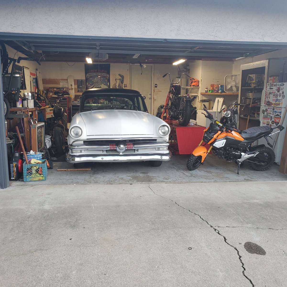

    Thanks! I had to take all the bikes out of the garage to clean up and figured I'd get a couple cool pics.

    Contact this guy for a transmission cross member https://www.facebook.com/watch/?v=347866255934591 You are also better off to pull the engine and transmission as a unit and do the install it is not uncommon to have an issue getting the AOD torque converter seated properly it is much easier with the engine and transmission out of the car. You can find some great videos on youtube to help get that converter in right. Also when you reinstall the engine and transmission as a unit it will help you to know where to redrill the new mount holes in the replacement cross member like you see in the pictures above.

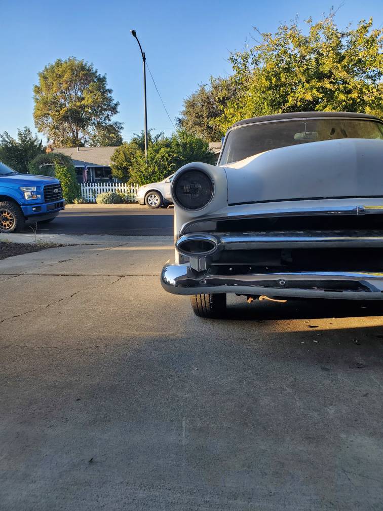

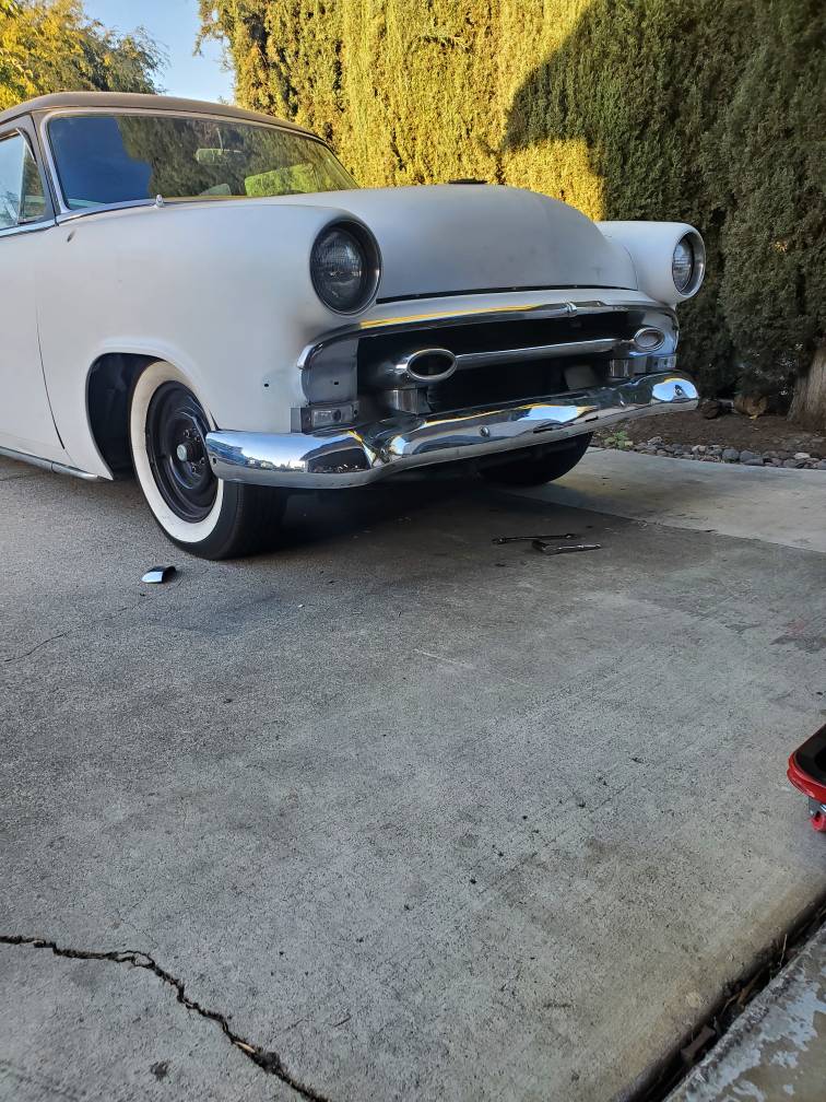

    Update: got the front bumper pulled in 3" last night. Olds grille is just set in for the moment. 20201015_174554.jpeg

    Maybe that open space at the grille ends might be a good place for fog lights,I remember that Bay area and Delta fog when I ran routes back there. ;):D Lots of style to choose from that might be right diameter.https://www.google.com/search?q=rou...ECBgQBA&biw=1343&bih=648#imgrc=5M7vrqXwh_QoZM

    I'm actually going to widen this grille about 14" and V it a little to fit the front of the car. Im hoping to use the oval openings in the grille for turn signals.

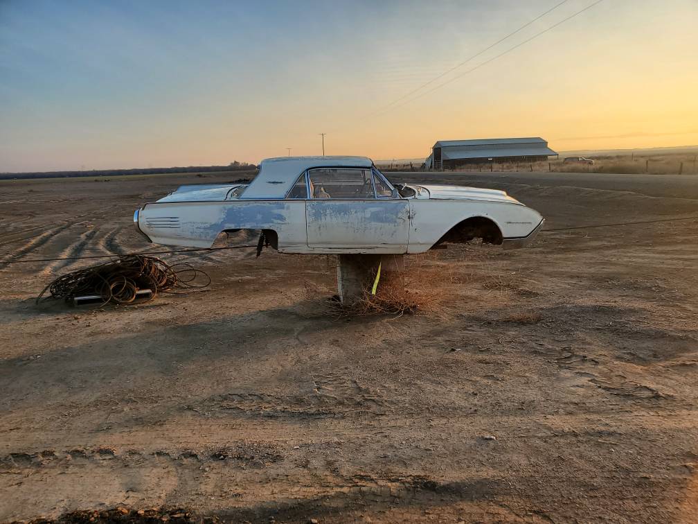

    This poor 61 T bird gave its rear end for the cause tonight. Found the car not too far away on Craigslist and lucked out! T bird was trashed as far as I can see. But if anyone needs parts, its on the Sacramento CL under 61 thunderbird. 20210108_164209.jpeg 20210108_173354.jpeg
