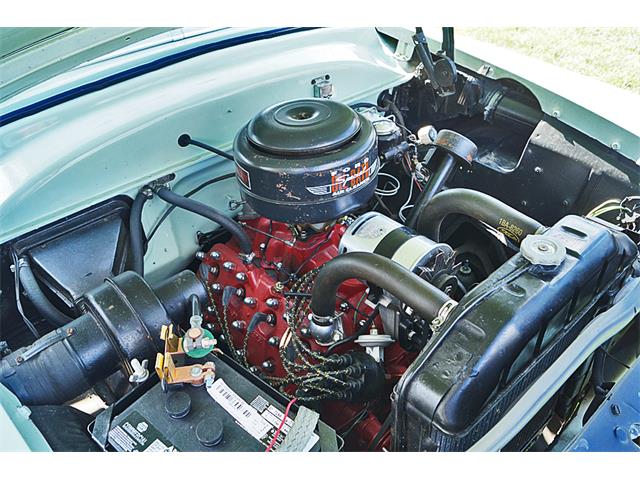

    28833939-1953-ford-customline-thumb.jpg found this on a cl***ified ad for a 53, putting it here for safe keeping so I can see how the heater lines are run, and how the under the hood goes together.

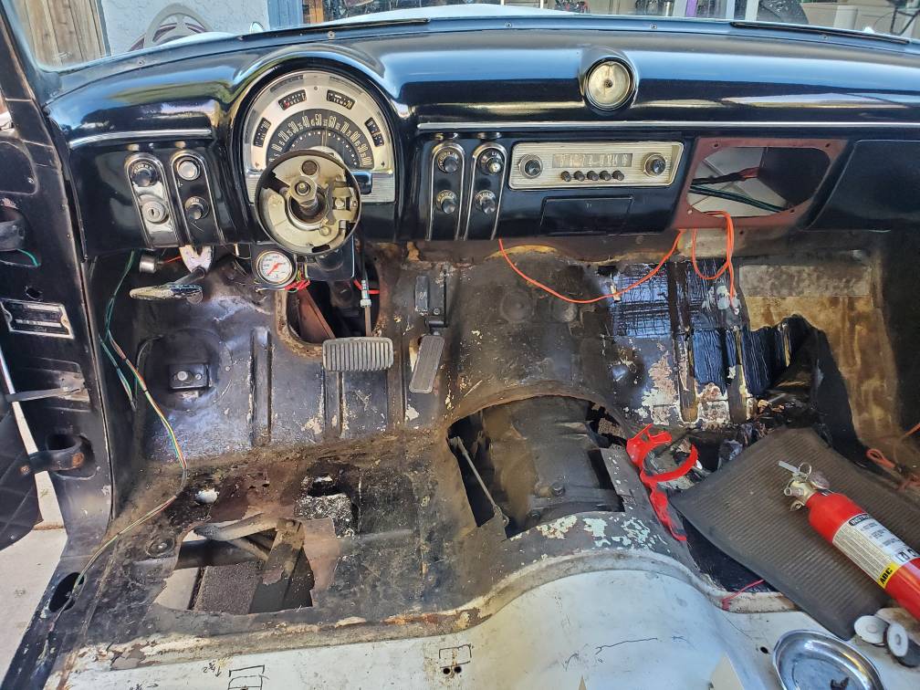

    Thanks for posting pic of your floor board. I now know what goes in the recess on the left! The dimmer switch! Cool! Now all I have to do is find that stamping the switch mounts to. Thanks again

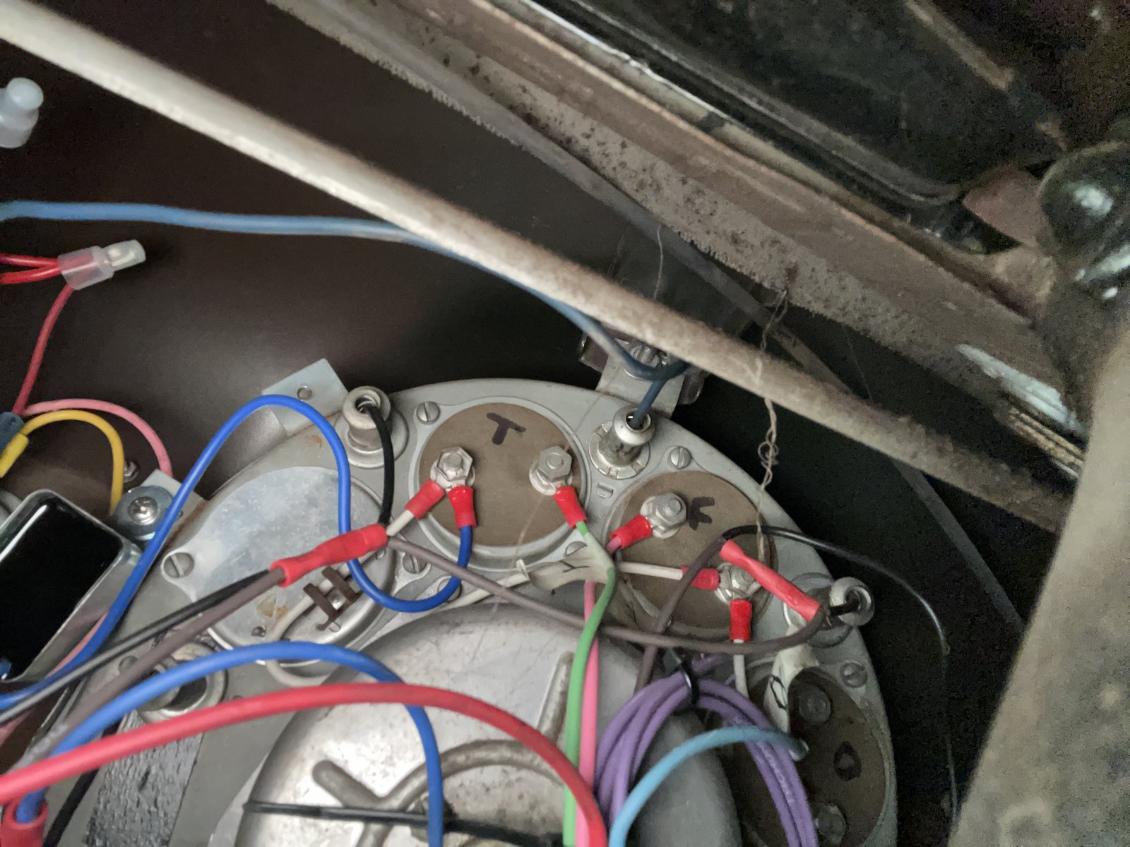

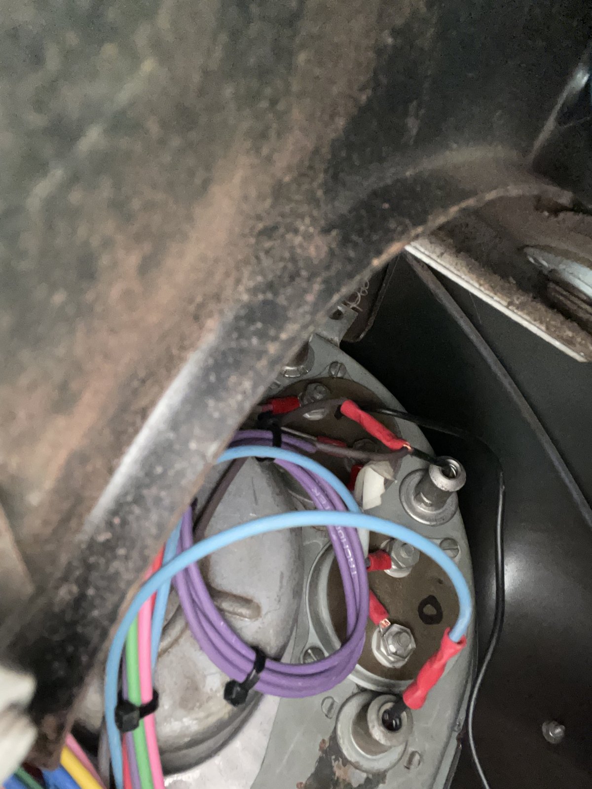

    20220119_144737.jpg 20220119_144737.jpg 20220119_144742.jpg alright.. im back at it trying to get this thing back on the road. Question I have for you guys is: which do I hook up which wire on these gauges? The power is all daisy chained together with voltage drops... but I don't know which post they hooked up to. Had the pics on my phone but I dropped and broke it and lost everything.

    Maybe these will help. Pretty sure the blue is the feed from the voltage drop and the white that is attached to the blue at the temp gauge post is the one that daisy chains through.

    EXACTLY what I needed! Thank you!
