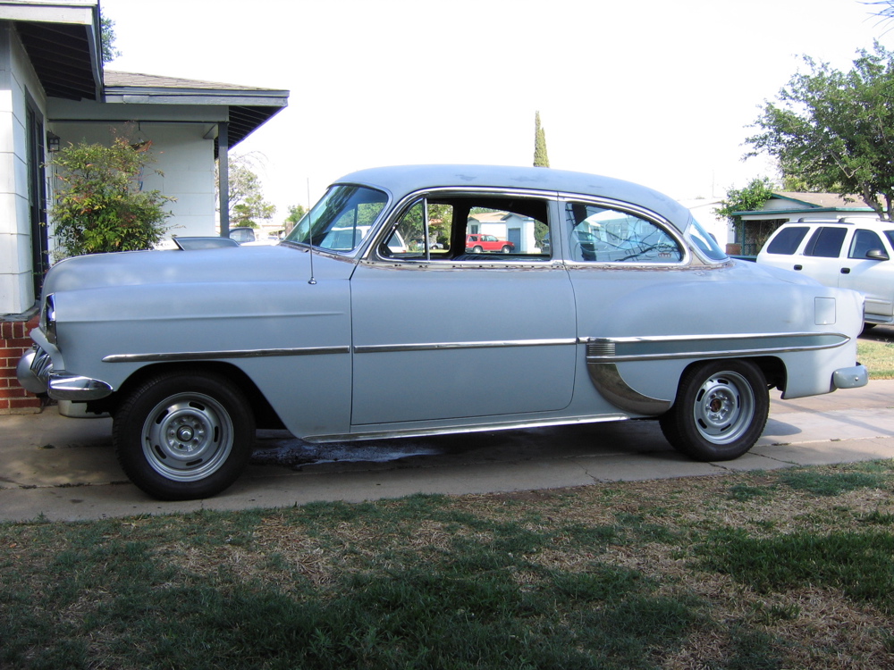

    Do you have the lower apron on? Without it and the bumper it will look off a bit. I have run mine for years and never noticed a thing, then this year I pulled the bumper and lower apron/splash pan/ whatever you call it. And people (and me) have noticed the front end looking to far forward about a inch.... Creates a illusion I guess.
  12. Terry
    Joined: Jul 3, 2002
    Posts: 1,824
    Terry
    I hope these pictures show what I mean ....
    With and without pan:
      355.1 KB
      115
      46.6 KB
      112
