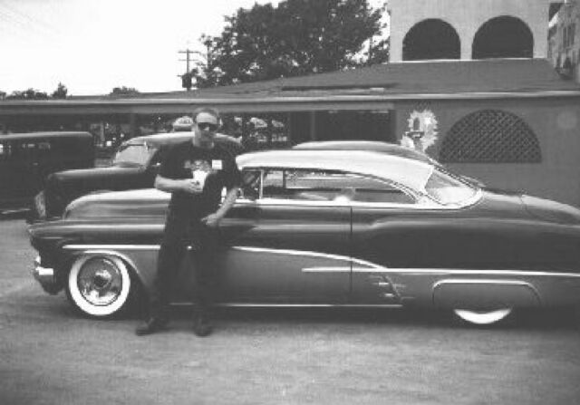

    I do however have a pic here of a similar shaped rear glass on a 53 Buick-chopped 3" and as I described above removing some metal above rear window and rocked it [THE stock uncut glass]forwrds and UP into the roof skin. then I rebuilt the panel below glass maintaining a flow or like angles from the roof/glass/ and the rear panel into the trunk lid.....it is a must that the angles do not conflict or vary much =-or you will end up ruining the profile of the top........
    It is easier if you slope the top an inch or so more lower at rear too.
