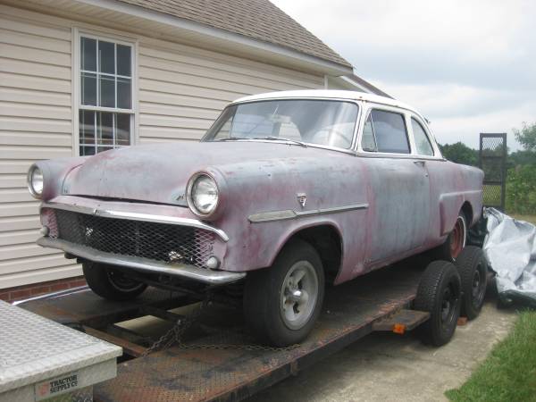

    Alright, well....here goes....
    I have been on the HAMB for awhile now. Just haven't posted much. I wanted to start the build thread for my g***er. Its a 53 ford customline. I got the car about a month ago, I have bought some new parts and done some stripping and patching here and there but I have not jumped in feet first yet. Getting there. Ive always loved g***ers since I saw the book "g***er wars" in a bookstore. I am only 27, but I've grown up around cars and racing my whole life. I finally am settled in with a family and the money is there so Im gonna build my own now. I live in upstate SC and I have seen the south east g***ers a couple times. I would love to race in that cl***, but I seriously doubt I could ever find the time to dedicate myself to that type of commitment of racing consistently. Right now my wife goes to school fulltime to be an electrician. So time is tight. As your gonna see, time is gonna be my biggest hurdle. Not that I have money running out of my *** or anything, lol, but I am pretty good at saving up for purchases. But I am going to build this car as traditionally as possible and as close to the south east g***er rule book as possible just in case time opens up.
    I am planning on mopar power. Just to be a little different. Plus my dad was always a mopar guy. Probably a small block bc of the "10lbs per cubic inch" rule. I figure the car will end up around 3300ish. So maybe a high rpm 340 is in order. Obviously a 4 speed. 9 inch rear is already under the car.
    Speaking of the car, it was a race car at some point. Or at least a pretty decent street freak considering it has radiused rears, a 9 inch already under it. Someone hacked the front crossmember out for an FE. It had some old gauges installed. The windows had crusty yellow tint on them. ******* bars on the rear leafs. Lots of rubber in the rear wheel wells from burnouts. Air shocks on the rear axle. It looks like 70's type stuff.
    Anyways, enough yapping. Here is the old heap...anymore questions, ask away!

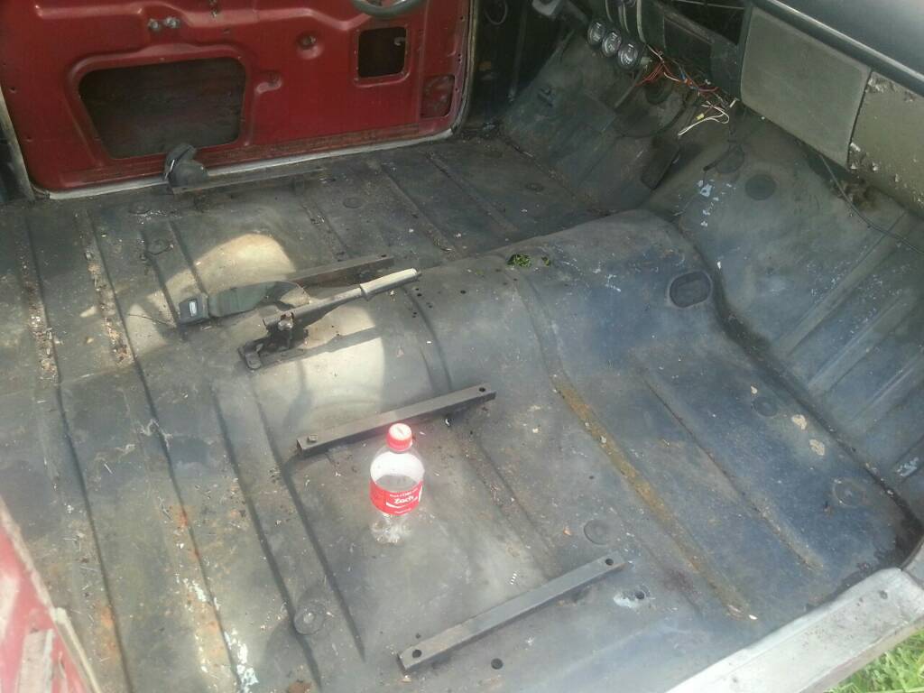

    booker512
    Engine bay and floors

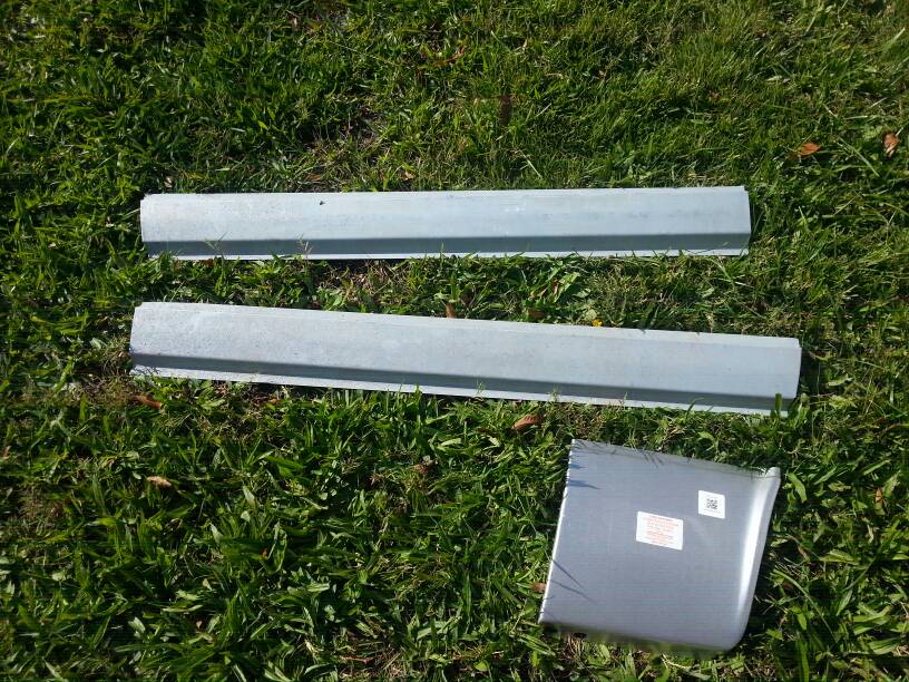

    booker512
    Some parts. New rockers. New front fender patch (I have two of them, dunno where the other one is) and my good ole' generic speedway axle kit. Annnddddd, no, those arent the tires going on the ford. Haha.
