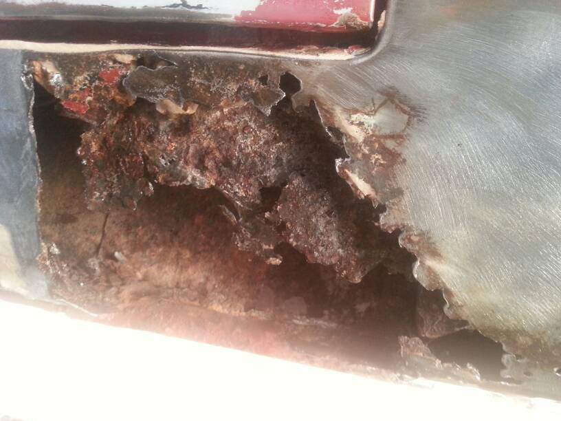

    The rocker was pretty shot, I already knew this and went ahead and grabbed a pair of new rockers. But I thought this "repair" was interesting. Instead of actually fixing this hole, someone just stuffed....probably 2 lbs of body filler in it....no exaggeration. Lol. There was a chunk bigger than my fist that I pulled out...gotta love 70's body work.....

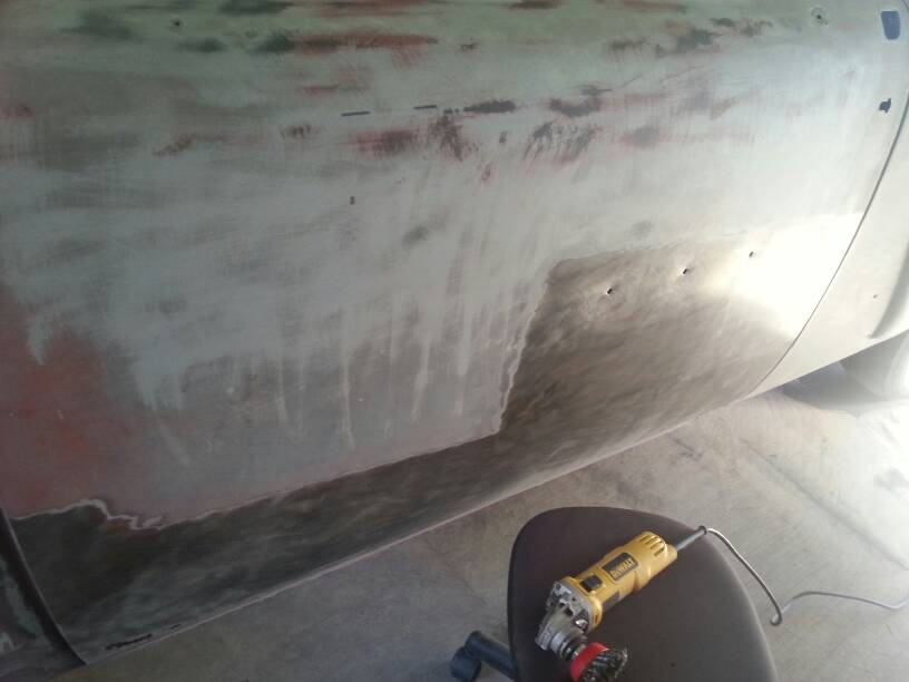

    Also finished stripping the rear quarters. Its all wet looking bc I wiped it down with metal prep and let it do its work. But slowly and surely making small progress here and there.

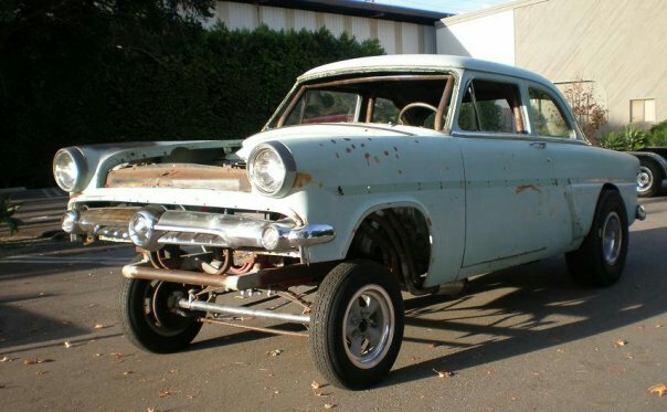

    Here is the car that I am using for inspiration. I think its a hamb members car, I cant remember for certain though. But its the color mine will end up being, thats actually my cars original factory color. But I love the stance. If anyone knows who's car this is....lemme know!

    The car in pics belongs to Desoto here on the hamb...

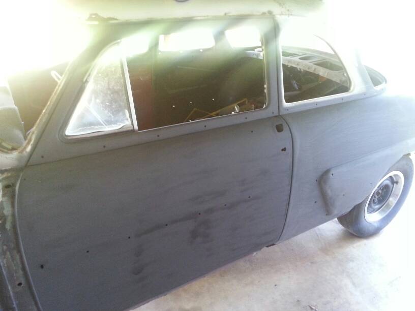

    Got the door stripped today. Found one small spot that is gonna need a small patch. Nothing major. Going to fill all the trim holes too. But thats for another day. Going to take the kids to the pumpkin patch and the wife out to eat now.
