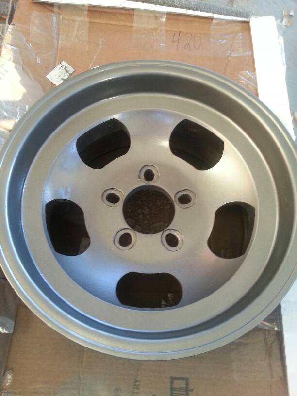

    Thats cool man. Feel free to post a link up if you have a build thread. Not much to show. I've been busy doing little mundane, stuff the past week or two. Just stripping paint from the jams. Getting rust out of the windshield channel. Etc. But I did get my slots cleaned up and painted.

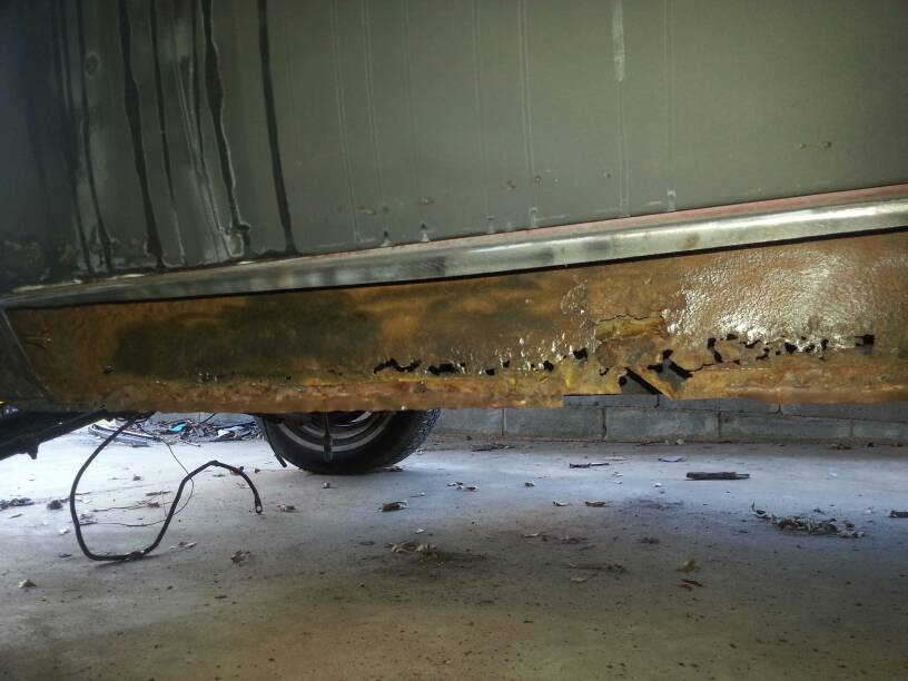

    I had a few hours free today, so I cut out the driver side rocker just below the door jamb. The top is solid. So im not going to use the full patch panels I bought. I also cut the new rocker length wise to fit it up.
