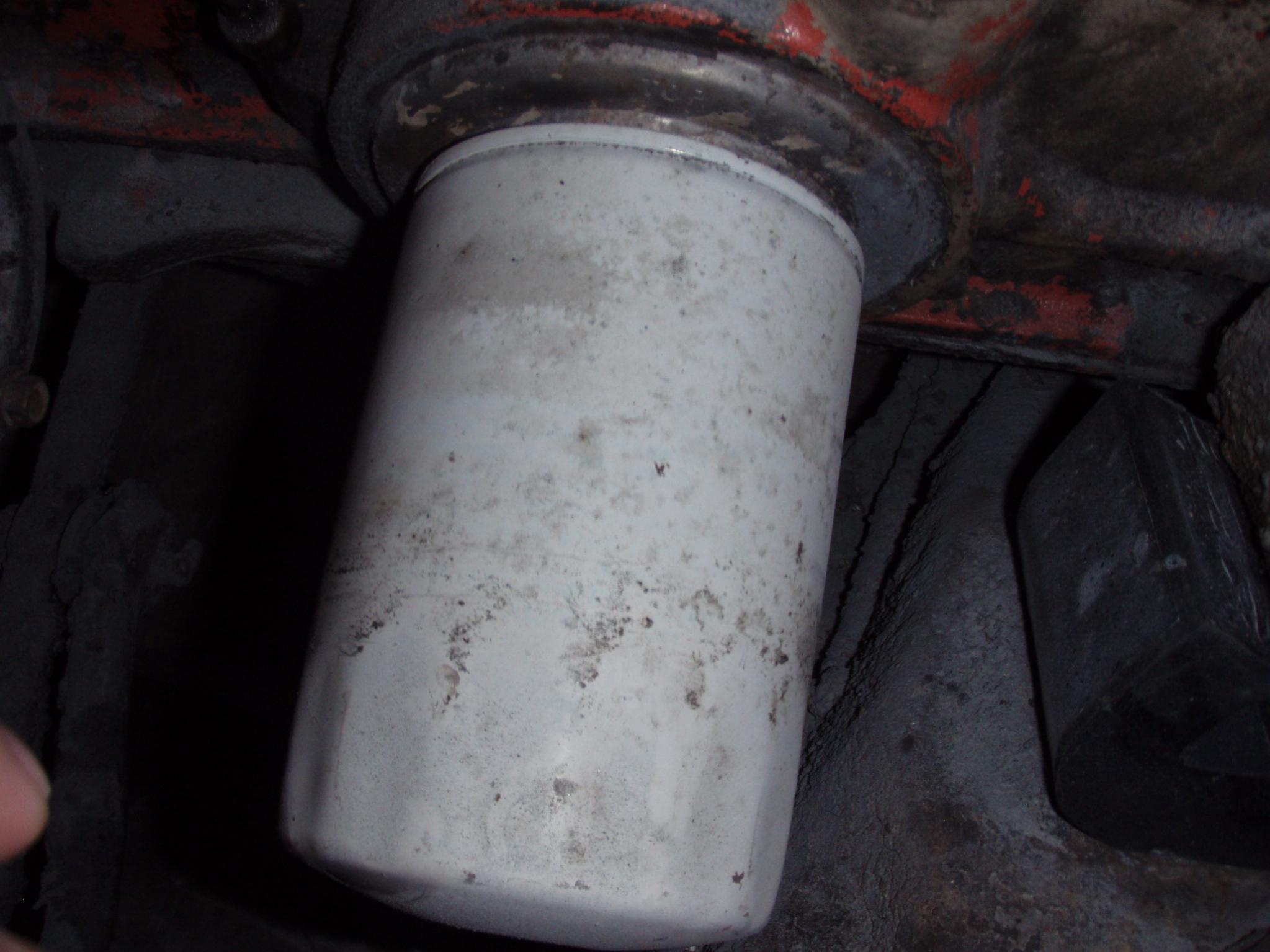

    Need some help trying to locate a new oil filter. The guy who had it before me put on a spin on type..not canister.
    Anyone have any idea what/where to get a new one to fit this engine? I took it to the local oil change place and they said they don't carry the filter...special order...

  5. greasy53
    Joined: Sep 16, 2011
    Posts: 87
    greasy53
    Ok, I looked on the filter and couldn't find any numbers so I took some pics to maybe help identify what would work on this engine.
    Please help!
    Thanks.

    Most of those adapters used a filter that fits the majority of Fords that use a spin on.
    Probably a NAPA gold Fil 1515 will work. You would have to take yours off and match the gasket diameter and threads on each to make sure though.

    You might want to check out the standard Ford/Motorcraft spin-on filter #FL-1A. Is recommended for 1957 and newer for most 6 cyl and V8s. I have installed the Ford/NH brand spin-on adapters on many early Ford tractors, back to 1953, and always run the genuine Ford FL-1A filters.

    I just put one on my '53 215' I bought the conversion kit from Joblot. It uses a Fram PH8A or Wix 51515

    Wix 51515 on my 62 223

    And the winner is...........Ford Motorcraft #FL-1A!
