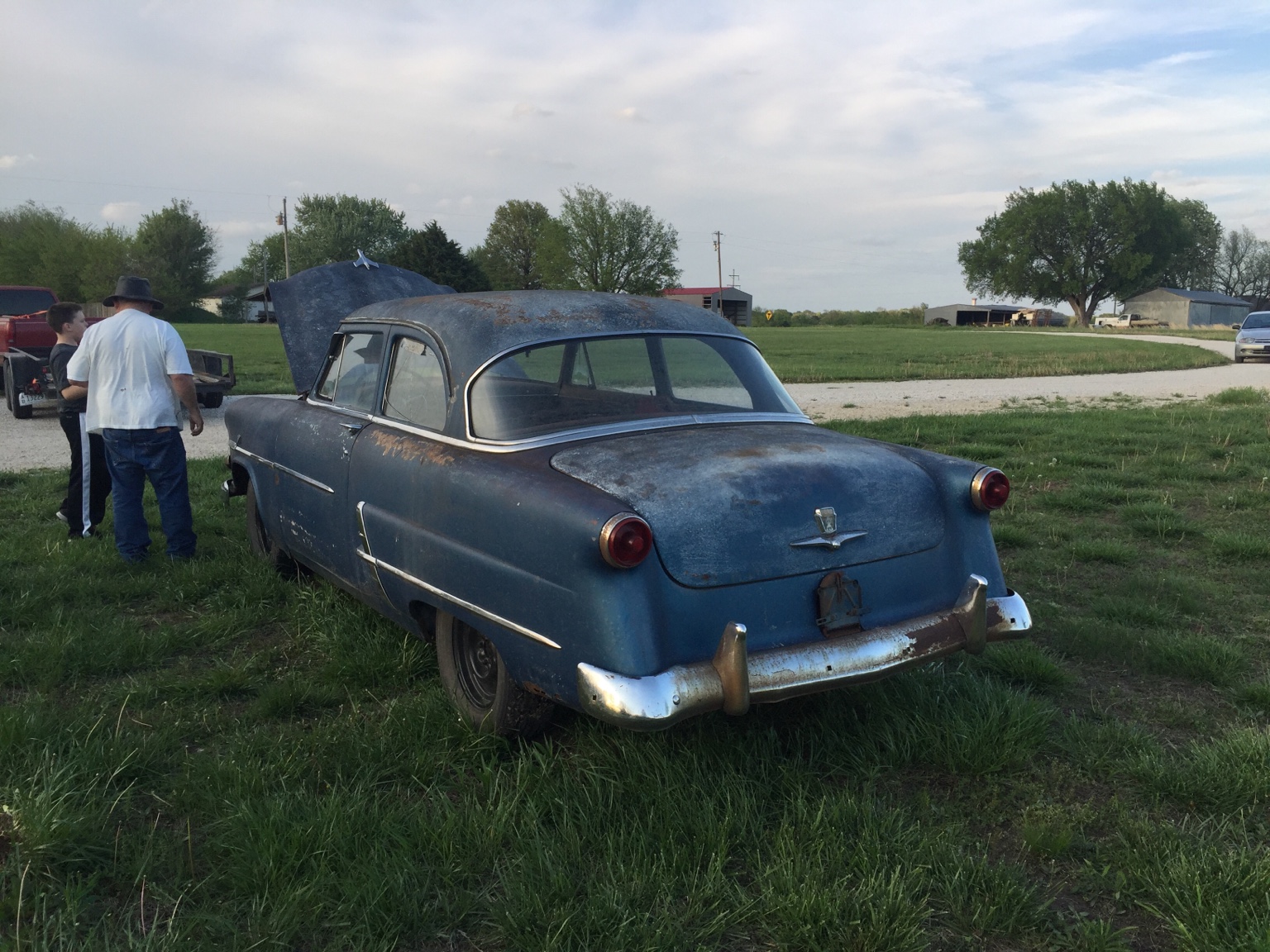

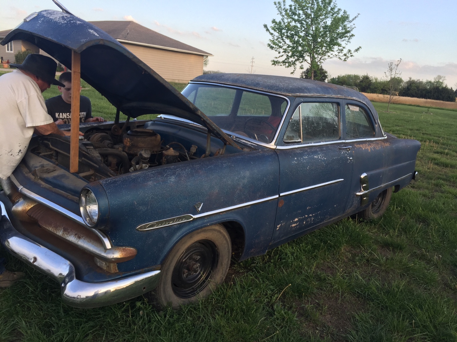

    I've been thinking about building a custom car for probably 40 years. I've put together all sorts, but finally getting around to this type I've always admired. I had recently been searching for the right project at the right price. Although the price I paid could have (should have) been lower, it was running and driving (at least in the yard), which was high priority for me.
    It has the stock flathead V8. The current carb is leaking from every possible place, one early mod will be to install a vintage Offy four-barrel intake. Please don't shame me for running it. They sold a lot of them years ago, so somebody was using them on hot rods and or customs. I just need to find the right period-correct carb.
    My first plan for paint is to just buff out the existing. This might not work out. What I ***umed was original paint is a re-paint and has a bit of fiber and filler. We'll just have to see how the paint situation evolves.
    There's not much left of the interior but some springs. I have a decent low-buck solution in mind and will post about that later. I'm hoping to make steady progress. Let's hope I do just that.
    [​IMG][​IMG]

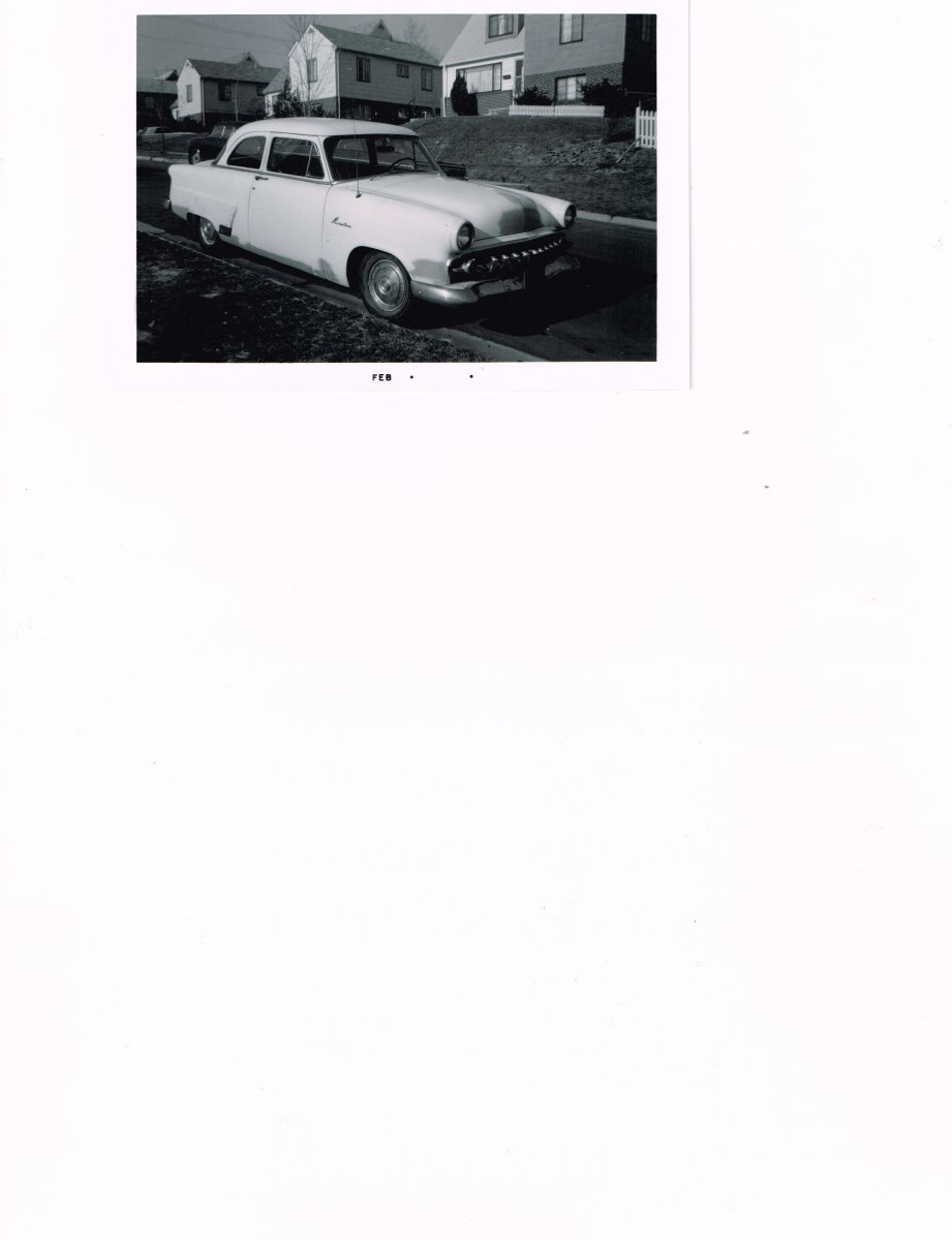

  3. One of my very early cars was a 53 Vicky. I also had plans to do a mild Custom. I was all over the little books back then. The car did get painted and tricked up including a 4 bbl. carb and that was 1964 so your idea is just fine with me. Looks like a good start from the outside.
    Best of luck to ya and looks like you have a suitable helper.

    Oh that's not me in the photos. I was taking the pics. That was the seller yesterday, although I don't look much different nowadays.

    The rear bumper is rough. Does anyone know of chrome plater near the Arkansas, Oklahoma, Kansas, Missouri area? Maybe I should be thinking of a custom replacement? I'm not sure might work. I'll throw '56 Chevy out there. Basic shape seems similar. I should get some measurements. Ideas are welcome. I'd like to make this unique, but simple and easy have distinct advantages.
  12. Ive got one from a 56 ford. it has outlets for the exhaust to exit. Ive seen bumpers that the plating was sanded off and painted and that looked good also.

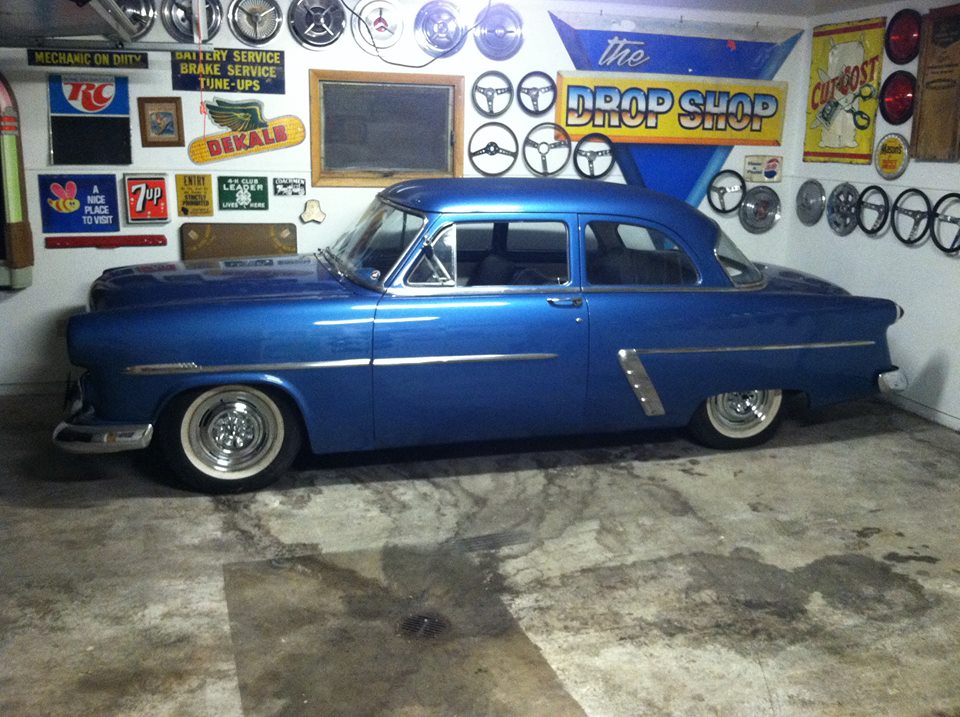

    Neat car, I have a '52 that's pretty much done and a '53 that I've had since grade school. Your front bumper looks really good, and I tell you that is a near-impossible piece to find with decent chrome. '54 front is different so it's a 52-53 only piece.
    Rears will fit from 52-54 though and decent used ones seem to be around, I picked up the one on my '52 at a local Wisconsin junkyard for $30. '56 Chevy might work, and since they're usually 3 piece, if you have to mess with the width you can do it at the seam with miminal damage to chrome.
    '56 Olds 88 tail light lenses fit in the stock Ford rings pretty nicely and are a cool custom trick with no body mods necessary. Early 90's Ford Aerostar minivan front coil springs will bolt into this car and give a 3" lowering and a great ride, can be bought for about $55/pair brand new. The inner headlight rings on a '53 are stainless and identical to the 52-54 Mercury rings, and the bezels are steel ('54 has die cast rings, '52 has chromed steel inner rings) so frenched headlights are pretty easy to do on these and if you make the inner rings removable you can adjust the headlights from the front.
    There's a lot of custom tricks that these cars take easily and don't break the bank.
    If your hood opens and closes, very carefully and thoroughly lubricate every hinge point on the hood hinges and be careful raising and lowering it, the hinges break easily, replacements are like $500 and require removing the front fenders.
    Here's my '52. I look forward to seeing more of yours.

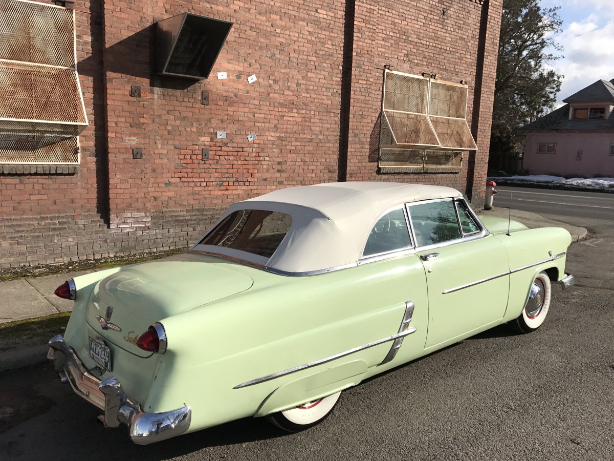

    I have a 53, cheapest car I own and also one of my favorites to drive. It was fixed up in the 60's and I bought it at a swap meet a couple years ago for 5,500.00. Had it running about 20 minutes after getting it home. Did brakes, gas tank, tune up and had the top done. Mines a mild custom, has been nosed and has a tube grill in it. I put Olds tail light lenses in, skirts, lowered it and added the wheel covers and accessory steering wheel. I love love love these cars. Cheap to work on and find parts for.
    I will be selling the tube grill from this car if anyone is interested. I have another grill I'm going to use. I also have a few 53 parts if you are looking for anything. Great project!
