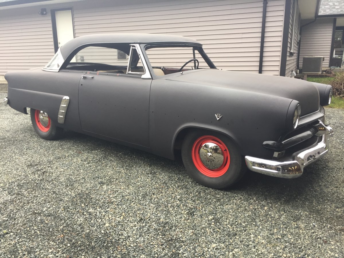

    We installed the 3" lowering blocks and rear air shocks. Not much to see, but here's a pic. [​IMG]

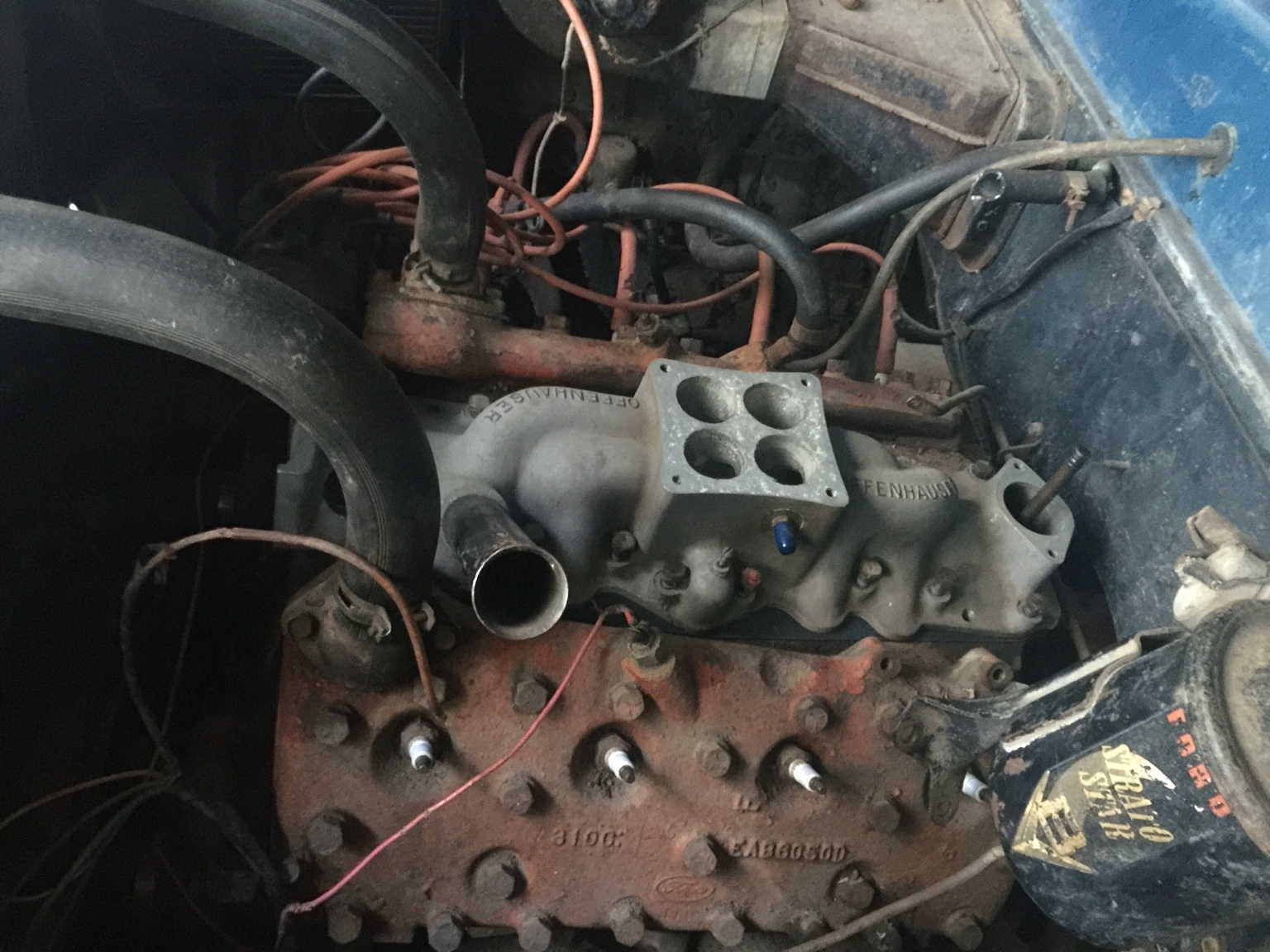

    I have a big weekend planned. I'll be installing the new springs and shocks, then finish the new intake/carb swap.
    The stock carb linkage is on the right side. I saw a post where the guy installed the new Holley four barrel backwards. Anyone have input on that?

    I installed my holley 390 backwards and everything works perfect.

    What did you do about your distributor? I'm hearing my stock distributor won't work at all, with a non-stock carb.

    The stock distributor will fire up the engine but it will not work properly. I am lucky to have an old flathead guru that lives not far from my place. He makes HEI distributors for flatheads and that is what I used. There is a guy on Ford Barn that builds distributors for flatheads. http://www.bubbasignition.com/mallory.html I would contact him for advice.

    Okay, dumb question: could take stock distributor be cured by installing a Petronix electronic ignition module? Seems to me, the advance curve could be built into the electronics via hardware or software. If it doesn't work that way, why not?

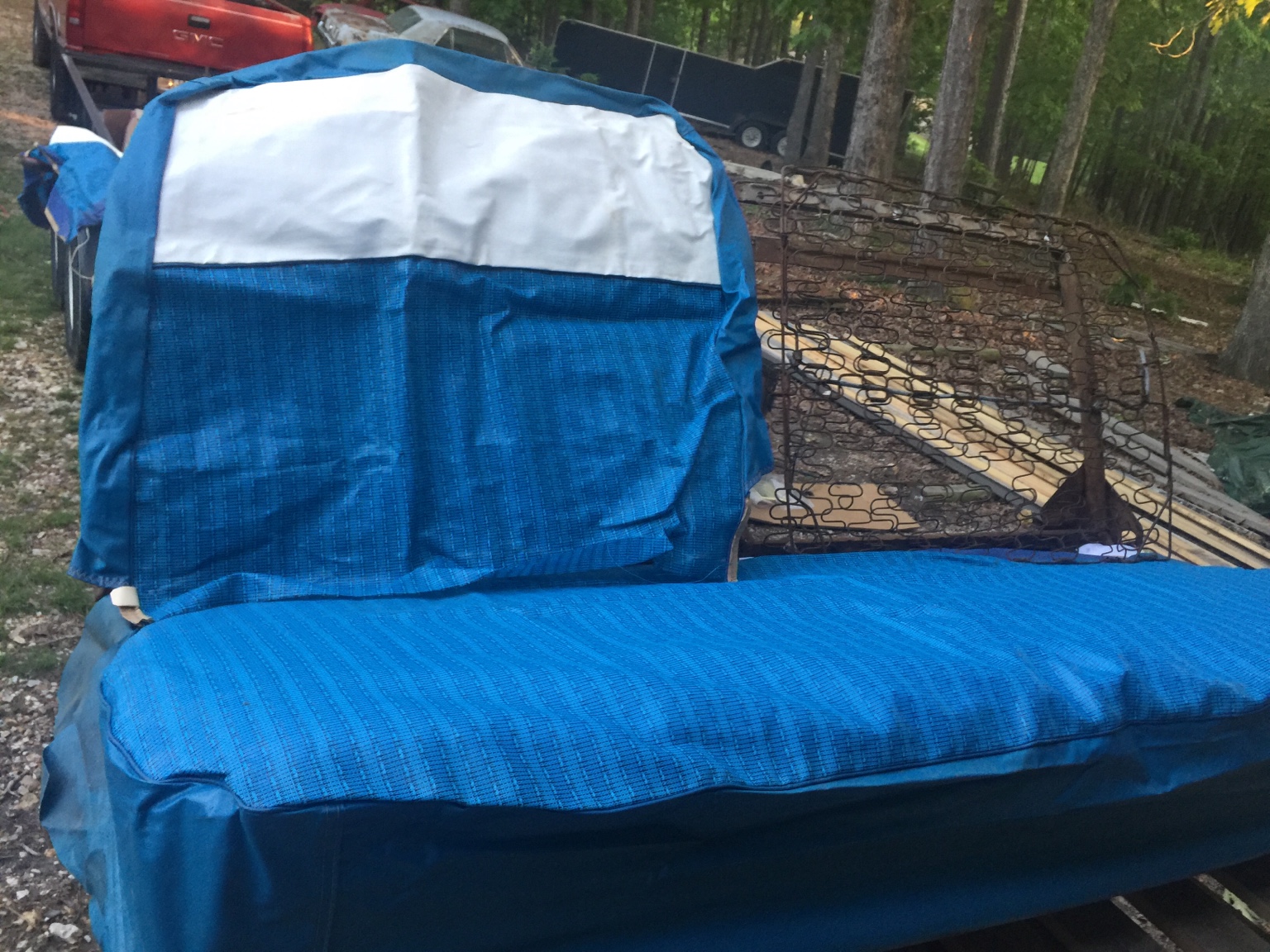

    I hope you're padding those seats and not just putting the slip covers over those bare springs. The slip covers were made to go over the top of the original upholstery, you can use them without the original covers but you need to pad those seats really well, probably 3 inches thick or more on the bottom and backs or the springs will tear those covers to shreds.
    Old blankets (the quilted kind with a layer of fluff inbetween, not knit "Mexican" blankets) work good cut up as padding, and you can use some zip ties to hold it into place if you don't have hog rings. Also, a layer of metal window screen on the springs before you put your padding on helps keep the mice from chewing the stuffing and also helps keep the stuffing from poking through the springs. Again, zip ties would hold the screen in place if you don't have hog rings.

    I just stuck that seat back piece up there to show the colors. I already padded the seat bottom. It has a heavy cloth over the springs, then an 1 1/2" foam layer. Then more cloth under the new cover. It still may need more padding. I haven't tried to pull it tight.
    The front seat backs seem to be way too tight, even without the padding yet. Maybe they were just made too small in the first place. Sometimes there's a reason NOS parts were never installed. I'll post more pictures.

    All the Pertronix does is replace the points. It still sits on the same advance mechanism. The problem is in how the advance works. Here is an explanation Bubba has on the Load o matic distributor. I apologize for copy and pasting from another site.
    UNDERSTANDING THE LOAD-A-MATIC FULL VACUUM DISTRIBUTORS
    JIM LINDER “BUBBAS Hot Rod Shop” www.bubbashotrodshop.com
    Ford made the “load-a’matic (full vacuum) distributor from 1949 until 1957 on most of their engines . This distributor is very much mis-understood by many owners etc.
    The load a matic works by adding spark advance thru a vacuum chamber using vacuum differential at the carburetor.This vacuum signal from the carb is very low with advance typically starting at ½ inch of vacuum and being full advance at 2 inchs of vacuum.
    The slightest change in the engine vacuum makes this unit become a problem and not supply the correct signal. A carb change is the most common problem making this unit not work. Twin carbs, a camshaft change also makes the unit become inoperative. I have talked to many owners with the vacuum line disconnected with complaints of engine overheating ( retarded ignition timing) and a poor running engine.
    The “fix” for this problem is to use a later distributor that has full centrifugal advance that needs no vacuum signal and is operated by rpm alone . ( may also use vacuum advance as well on some units)
    For the 1949-53 Flatheads we offer a remachined Chevrolet unit with a curved mechanical advace suitable for the flathead engine design. We have built and shipped over 700 of these units to very happy customers over the last years..

    Okay, I believe it. I'm just saying, someone could design the advance curve into the module. I know that some spark modules have a built-in retard, based on RPM. You could do the same thing with timing advance. If you have an input sensing engine RPM, it's just one more step to trigger an output based on RPM. . .
    Probably has not been done due to lack of demand.
    I didn't win the Mallory, but I have contacted Bubba. I'll get a solution ordered.
